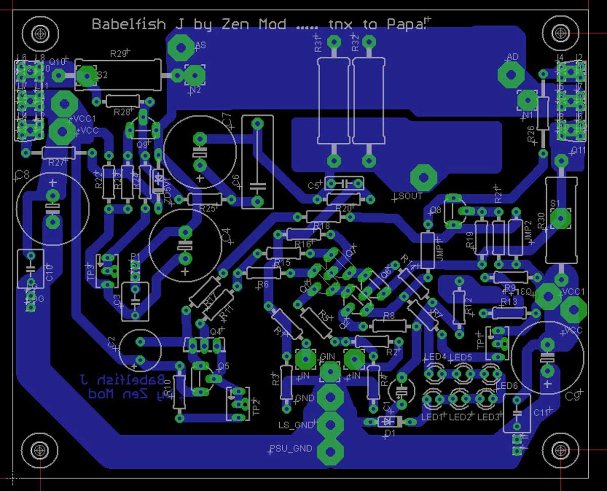

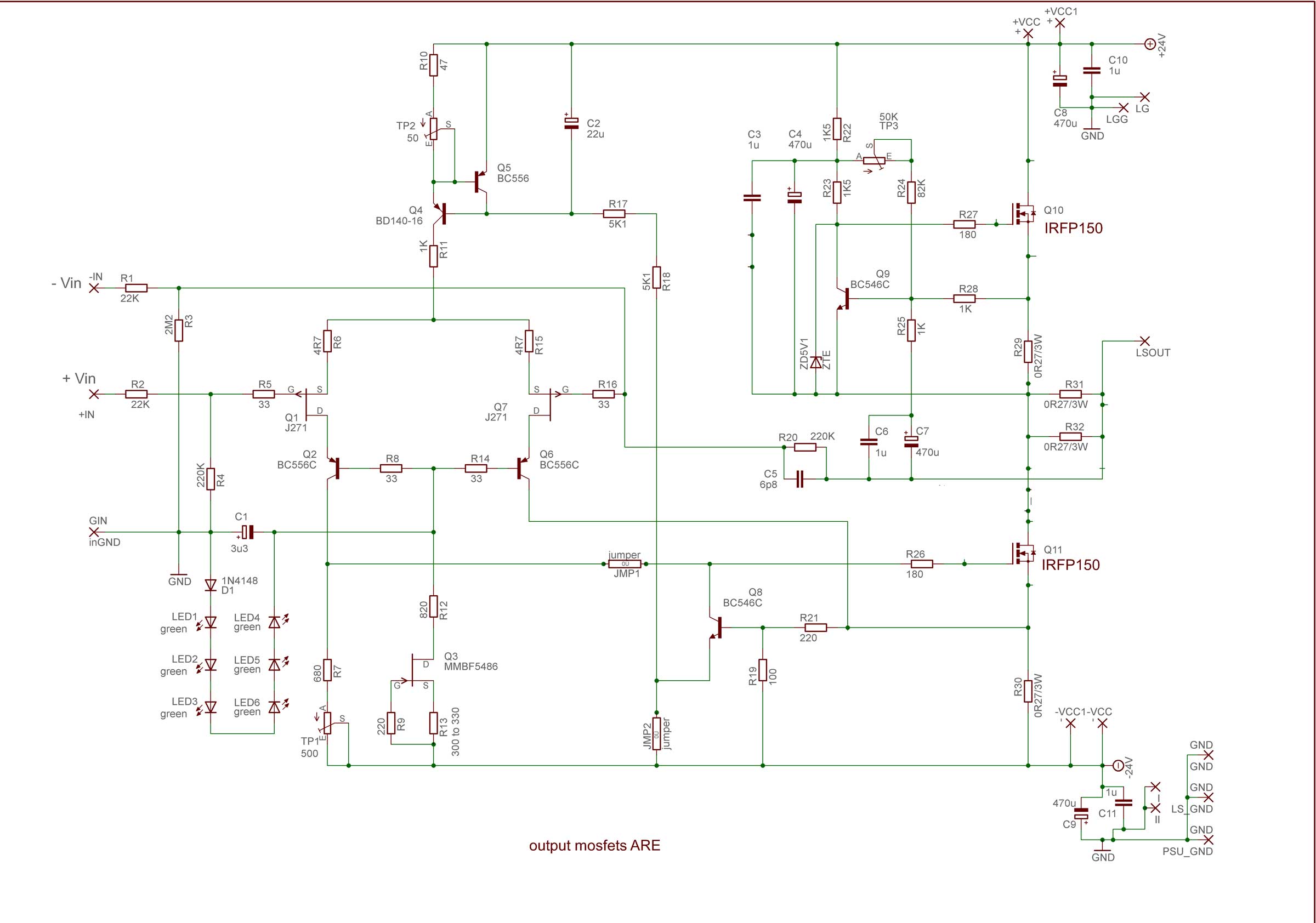

Base pcb iteration - up to so-so normal rails
so , just base pcb and pair of IRFP150 mosfets for output
schematic and screenshot of pcb attached ; sch cleaned from some Eagle necessary clutter
observe pics in posts #35 and #36
populate pcbs as usual , all resistors are garden variety MF small jobbies except big 0R27 ones - use either Panasonic MOX 3W or square whitish 5W wirewounds
for these - mount just two pcs in group of 6 pcs
for all 0R27s - use 6-8mm risers between resistor body and pcb during soldering , to ensure good ventilation and prevent pcb heating in exploatation
prior to soldering on pcb - be sure that all multiturn pots are in mid position - confirm that with ohmmeter
wire as any of FW amps , input RCA isolated from chassis , use tiniest wire for input signal - twisted pair is preferable to coax
again , FW PSU style used - with these parts values you're good up to +/-30Vdc - take care to not exceed 50W dissipation per mosfet , under condition that you don't have more than 50C on heatsink , even in summer time
main gnd bus from PSU to pcb , then from pcb to speaker negative output

powering up - connect everything , ground inputs , no load on output
power up ;
if green LEDs are lit , that means two things - you mount them all as needed..... and there is proper biasing voltage for LTP cascodes 😉
- check voltage across R11 - set 10V there with TP2 and we'll have 10mA through input LTP
-check voltage across R29 ; 540mV will inform as of 2A Iq ; use less if you want ; correct with TP3 if needed
- check voltage at output node - chase 0V ( up to 30mV is OK , + or - , irrelevant) , correct with TP1
last two steps are somewhat inter-dependable ; repeat them iteratively until you get desired Iq and zero offset
of course , last two steps are also dependable of open lid/closed lid situation, but you already know that final setting must be made in temperature equilibrium state , where closed lid is normal thing
so , be prepared to use few voltmeters , extending wire-clips and to open lid-set-close lid not overly slow
edit : yes - JMP parts are jumpers - either normal solid core bridges or fancy 0R resistors
don't forget to mount them , too
Hi ZM,
Can you clarify "mount just two pcs in group of 6 pcs"
R29, R30, R31, R32 are the 0R27 with R31 parallel with R32. Do you mean substitute single 5W 0R135 instead of R31 & R32 or use either R31 or R32 but not both? 😕
