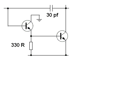

using LTspice i added a buffer to the VAS.
as excepted, there is a very slight reduction of THD due to a few extra dB of OLG (assumes same compensation), but i dont see this as worthwhile.

I put a 100 ohm to 1k resistor in the collector of the beta helper to ensure it can't break into HF (20-50 MHz) oscillation. Also, very important, keep the beta helper emitter load resistor low in value 470 ohms to 1k and no higher. It goes without saying, a Baker clamp is required. Most of the charge storage leading to rail sticking will be in the VAS transistor, although on low Cob devices, it is generally not too bad. I try to make sure its always < 1us on gross overdrive.The problems aren’t with stability. Recovery from overdrive is poorer unless steps are taken. It either needs a Baker clamp or an explicit current limit for the VAS transistor itself. Some will band aid it by putting a resistor in the collector of the buffer, but that’s the wrong solution because you’re back to Miller multiplying the nonlinear Cob of the buffer. And then you have another non-dominant pole thats not so non-dominant and can eat into phase margin (and hence stability). Best to leave that resistor out and deal with overdrive another way.

100 to 1k in the collector won’t miller multiply that many times. It keeps the gain to the collector low, which is what helps the HF oscillation. Putting 20k in there is the wrong way to prevent rail sticking or burning up the follower - the Baker clamp or fold back limiting is. 470 ohms emitter load puts the current at 1.2 mA, which is a good place to be. Well above 1k and there just isn‘t enough current in the buffer.I put a 100 ohm to 1k resistor in the collector of the beta helper to ensure it can't break into HF (20-50 MHz) oscillation. Also, very important, keep the beta helper emitter load resistor low in value 470 ohms to 1k and no higher. It goes without saying, a Baker clamp is required. Most of the charge storage leading to rail sticking will be in the VAS transistor, although on low Cob devices, it is generally not too bad. I try to make sure its always < 1us on gross overdrive.
The issue I have with Baker clamps is the voltage capability of the diode. Put ones in there that will take 300 volts of swing and still have a low Trr their turn-on voltage is too high to do any good (transistor saturates anyway). The only solution there is to put another diode in series with the base to make a 1.2 volt turn on. Then you can’t suck out what charge there is. If your amp stays within the capability of a 1N4148 things are a bit easier. The current limiter will produce a 1 or 2 volt “blip” due to the drop in the emitter resistor, but out of 100, 150 V it’s not enough for me to hear, especially at the SPL generated. Neither is 2 us of rail stick, either.

The reverse-biased diode in parallel with Cdom is the Baker clamp. It is supposed to forward-bias when the VAS tries to saturate, stealing the excess drive which would have burnt out the buffer or fully saturated the VAS (resulting in rail sticking).
The catch is it needs a low turn-on voltage. Schottkys would be real nice if they weren’t so damn leaky.

Baker clamps will divert base current away from the transistor effectively because in a beta helper situation, you have the Vbe drop of the first transistor and then the saturated collector voltage on the main transistor which when turned on will be to within 100-200mV of the emitter voltage. The 0.6-0.7 V across the Baker clamp diode will be conducting almost all of the excessive base drive, leading to overhang after the input drive signal moves beyond causing the amp to clip.
Rail stick is important because in a lot of designs, you get overshoot as the loop regains control. In any event, when an amp clips, it's running open loop and you want to get out of that as quickly as possible without loop anomalies.

Buffering the VAS input increase considerably its linearity, that s one case where the added cost is negligible
in comparison of the amp s perf improvement, most 70s basic amps lacked this improvement which would had
made a big difference in perceived sound quality.
As pointed by Bonsai it s necessary to put a resistance in serial with the buffer collector to keep it from being exloded
in case the amp is clipped, personaly i put values as high as 4.7-10k depending of the supply voltage and such that
its max current is limited to a handfull mA.
Also it require a slightly higher Cdom, say 56-68pF instead of 47pF FI.

There are at least two effects coming into play with a buffered VAS.
One major improvement in linearity is through the use of a current mirror which drives it. This eliminates a potential base resistor, and instead offers an effective impedance perhaps getting on for a couple of megohms. That pretty much drives the buffer (or, indeed, a VAS if no buffer is used) with a current source, eliminating the Vbe non-linearity and replacing it with any hFE:Ic non-linearity, which is a lot less than the Vbe.
The second is that the base current required to drive the VAS is a lot less. That automatically improves linearity by reducing the variation in current needed for the base. Which is the same thing as saying that the open loop gain is increased.

This is how I do it Hennady, but without Cadd. The Baker clamp diode goes across the 30pF capacitor, with the anode on the collector of the 2nd transistor and the cathode on the base of the first one. See also dadod's idea in the first presentation I linked to in post #30 - this is also a similar approach to the one wahab is proposing. I have not tried this myself, but the simulations look ok.
With the Baker clamp diode, the peak current in the VAS transistor is very well controlled (just a bit more than the standing current), but you have to use a good quality diode like a Vishay or Nexperia BAS21J. Both these devices have fully characterised reverse bias capacitance and its very low, so that's why I recommend them for this job.
It’s clear for Baker, the second drawing is probably his full version. Those. in a composite transistor, the B-E junction replaces the diode.
