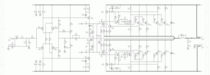

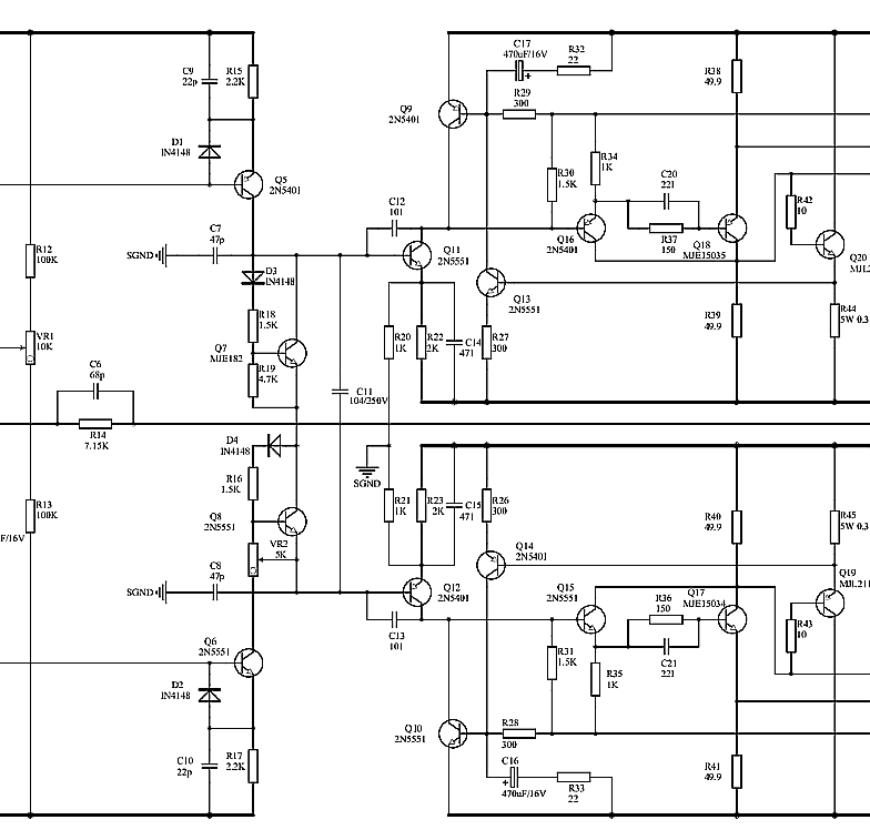

About a push-pull vas (the image are a part of a power amp), in the circuit image I include, Q5 and Q6 are the push-pull vas, Q7 and Q8 are the bias.
But what are the fonction of Q11, Q12, etc... ?
And where do I put a phase lead in that vas of a amp circuit ?
Thank you

The output is an expanded CFP with a voltage gain of (1K+2K)/1K=3x so the "VAS" stage will provide the global feedback ratio (7150+536)/536 less the output 3x gain, ie 14.34/3=4.78x
The question is, did the designer succeed in getting this design to work reliably. A simple two stage CFP is a stability issue, so a 4-stage output seems to be a recipe for failure. There may be a very good reason that your friend gave you this amp for free. Bits of lead and lag distributed in the feedback loop is contrary to the basic concept of a dominant pole as a means to stability, so the success of this design is doubtful.
