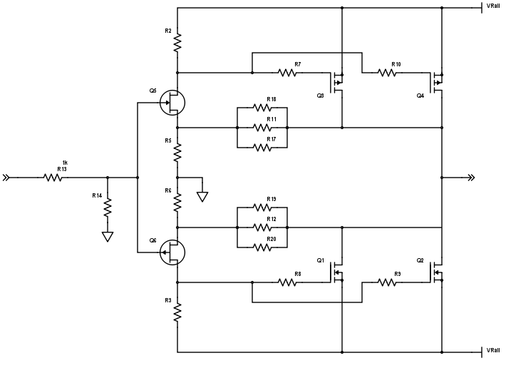

After biasing up and checking dc offset.
I have removed trimpots and replaced with the appropriate jfet drain resistors
Circuit now looks like this.
I'll see if I can successfully remove gate resistors next
why should you ?
I see them (always) as integral part of mosfet
except if you going to make exceptionally fast iteration of Lightsaber ..... but , hey , Yoda was good even with most dreky one .......
:devilr:
You are right, it will add absolutely nothing to the amp, but I am curious to see what can be achieved, or at least determine at which point the devices start oscillating.
I've started with 1k gate resistors and will start lowering the value to determine where they become unstable. It's really just an exercise in curiosity.
Hi.
Intresting project and very Nice PCB.
I tried about the same with 2SJ55 & 2SK175 a week ago.
But I kept the current limiters in F5 cirquit, in case of...
May be that was the reason that bias suddenly dropped from 1 amp to 0.04 amp.
I decided to sleep on it for a while, then we'll se...
Figge.

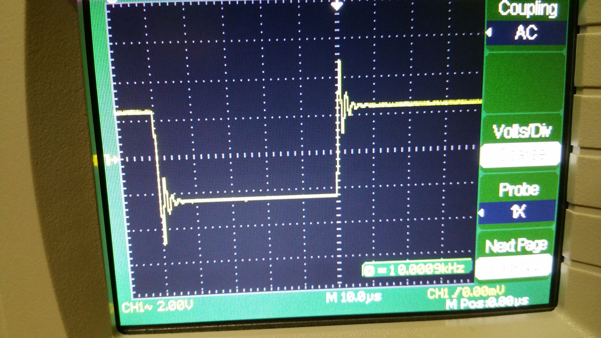

Finally put a sine and square wave through it.
Getting a nice clean sine wave but getting overshoot with a little ringing (but not oscillation) on 10kHz square wave.
This was predicted in simulation, I just chose to ignore/disbelieve it (dumb bastard). Hahahaha
According to simulation I can lower the overshoot by lowering the resistance but to get rid of it completely I need to go the other way (obviously) and increase it to around 5k.
I'll try lowering the resistance first since that doesn't require soldering anything and will be quick.
Before I start soldering new resistors, is it possible a linear regulated lab power supply could potentially cause overshoot issues with 10kHz square wave (measurements were done using lab power supply)
I might try the CRC supply to confirm result
