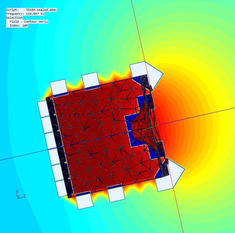

I had a few moments to try an obs field. When I noticed the scale is wrong, the box was ginormous with scale=1inch, so I changed it to 1mm. The observation field is 1m from origin and the outer box view was removed to see the inner pressure (pic below).
The field is "blocky" near the edges because its a low mesh freq. Enough to check things are working. Files need cleanup. 🙂

You still used '1in' for scaling in the 'solving modified' file:
// MeshFileAlias=M is an alias to a mesh-file
// which is exported by GMESH.
// Since all dimensions are in mm we use Scale=1mm.
MeshFile_Properties
MeshFileAlias=Alias1
Scale=1mm
The enclosure got huge for this reason (the filed is comparably small as given in 'mm').
You may want to change this. Solving times go down as well... However, I did not check your STEP or mesh file with respect to indented dimensions (in or mm).
I add the modified solving file (extended frequency range to 1000Hz and no of frequencies to 50) and observation field file.

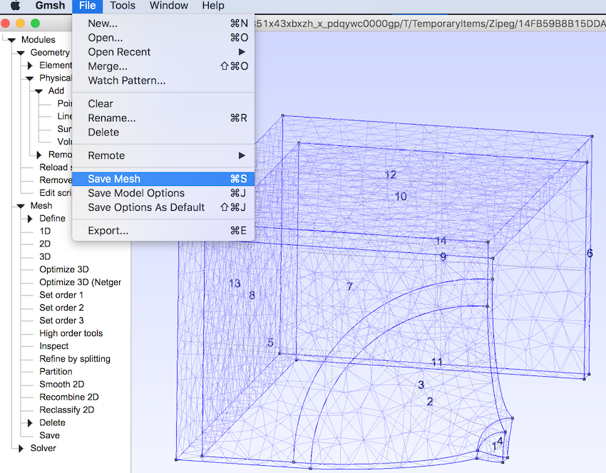

OK, here is how I actually use Gmsh.
Disclaimer 1: I'm using version 3.0.4 for OSX, other versions might look a bit different.
Disclaimer 2: This may not be the best option to mesh for all situations. I just works fine for me.
Disclaimer 3: You probably know most of the steps. I explain in some detail anyway in order to make it clearer for ABEC beginners....
Here we go.
The respective *.step-file has been opened in Gmsh.
I then apply following settings choosing 'Tools' and 'Options'.

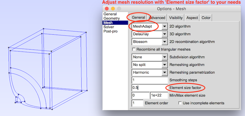

Options 1
Within the 'Options' Window I choose 'Mesh' - 'General' and
- 'MeshAdapt' as 2D algorithm:
Moreover I define the mesh-resolution here by giving a number for the 'Element size factor'. The lower the number, the higher the resolution of the mesh.

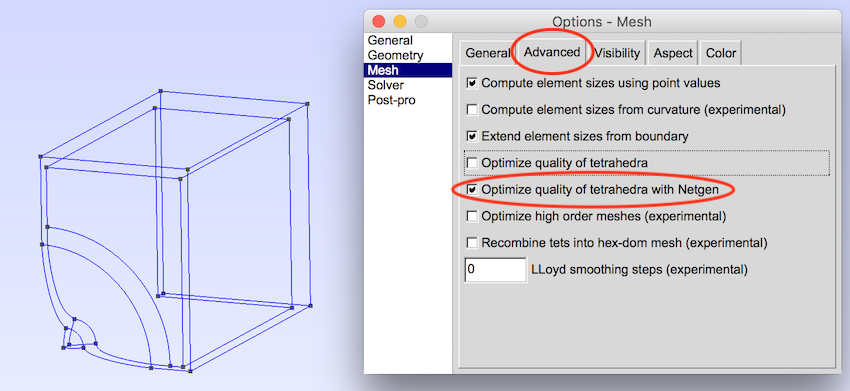

Options 2
Before meshing, I select 'Optimize quality of tetrahedra with Netgen' under 'Tools' - 'Options' - 'Mesh' - 'Advanced':

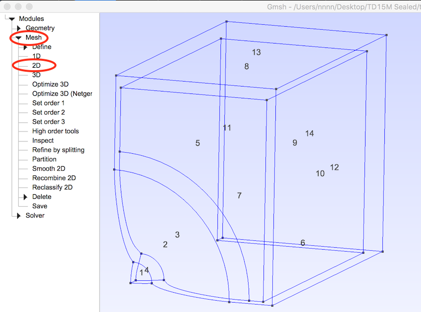

Mesh
I do meshing via 'Mesh' - '2D'

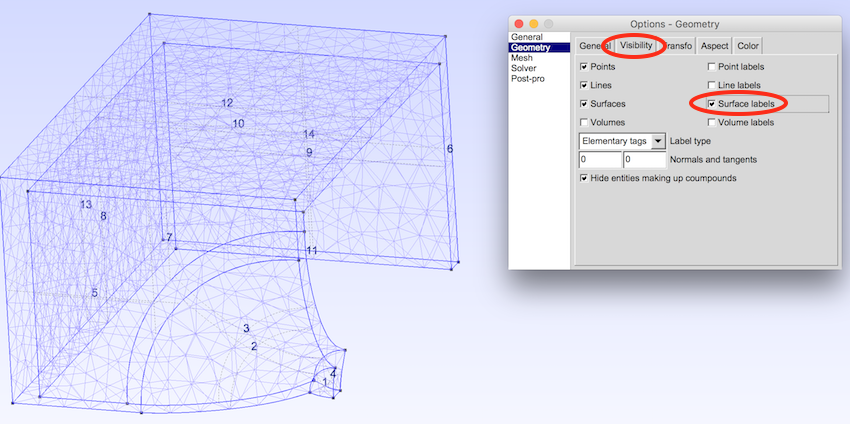

Surface numbers
Surfaces labels can be seen choosing 'Surface labels' under 'Options' - 'Geometry' - 'Visibility'
You'll need these numbers in the 'Elements' Script in ABEC in order to reference the respective surfaces.
Save mesh:
Not much to comment here. The mesh file can then be imported to ABEC. The size of the 'XY.mesh' file gives a good indication on how long your computer will need to solve the file in ABEC.
Hope this helps.
Christoph
