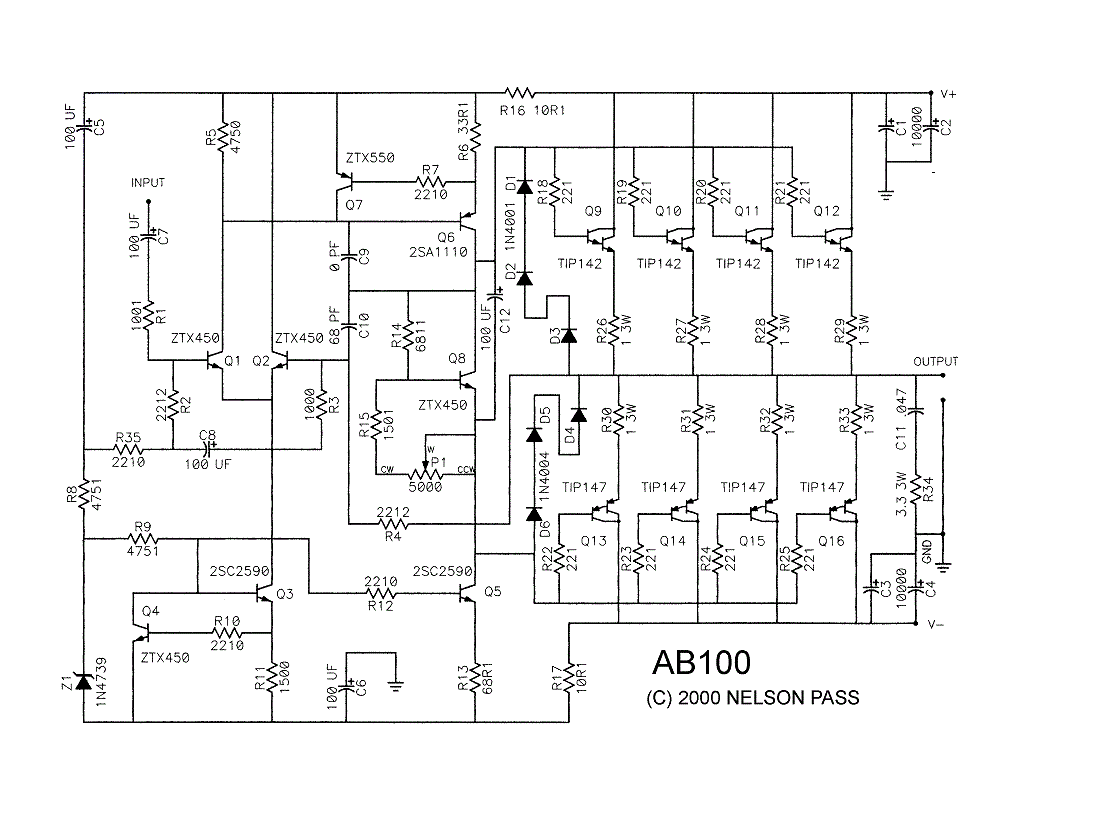

AB100 Class AB Power Amplifier
I hope this is ok...

I will have to presume that the diode string across the bases of TIP 142 147 will shunt excessive drive to output and that will create a crude method of limiting if and when needed
I am actually not familiar how protection like that will work sound wise ...None of the amplifiers i am listening to had this schema of protection ...Also don't know how effective this is
Then the question for me is :why bother? since Darlingtons on the output will do there "own" thing after the protection depending on the thermals cooling load and so on and on .

A few quick answers.
The original design (this one) was intended for dummies with maximum
reliability and minimum adjustment and also minimum opportunity for
noises and pops. ....
I guess that answers it .... maximum reliabity sounds good for my bass guitar... and intended for dummies, spot on too 😀
I expect to hardwire on proto board
regarding the Darlingtons
with their high current gain, I suppose they are easy to drive, and might have been chosen for that reason ?
http://www.onsemi.com/pub_link/Collateral/TIP140-D.PDF
I guess there is a first time for everything, also on Pass forum
