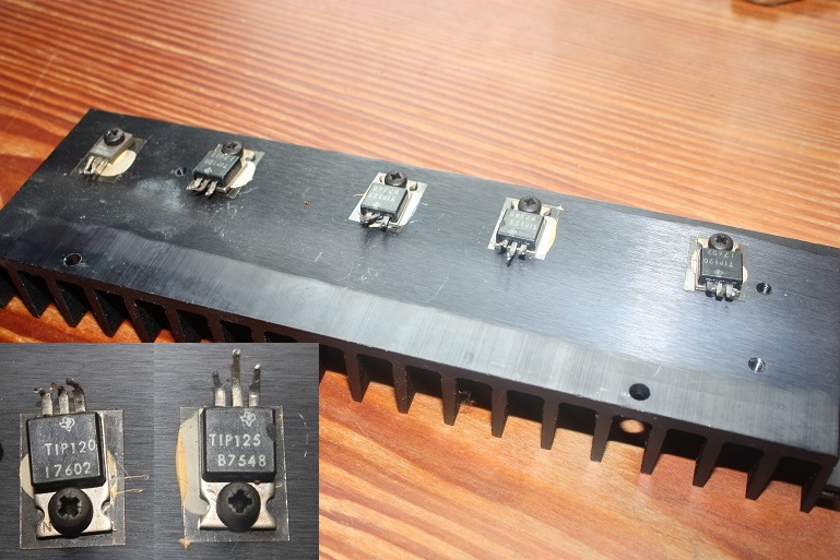

I remember looking at what I had in my parts bin when nelson first published this.
And I came across a few denon recevers 8yro or so. And they had darlingtons that would fit the bill.
I can send you guys the sheets on those. You can decide if they are good or not. All I could decide if they wouldn't let the smoke out that's as far as I got.
yeap .... but then you need to place the question of how far you may go with transistors with Cob of 400-600 pf , ft of about 3Mhz and hfe of 75...
Pretty rugged and robust devices probably ideal for a low pitch inverter ....

The PMD16K100 and 17K100 from the original A40 are still available if looking for TO-3 style xsistors.

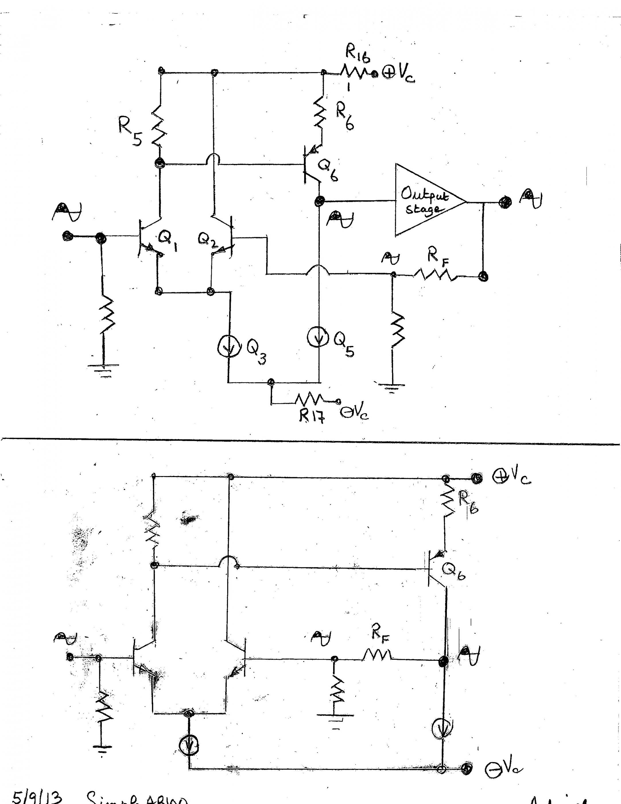

Conjoined Twin diyAB100s
The attached image [SimpleAB100.jpg] shows two simplified schematics of diyAB100. The schematic at the bottom of the view is a further simplification of the top one. I am able to carry on the conversation without showing the output stage to enhance clarity; because the phase of the half shaded sine wave signals is identical in both schematics.

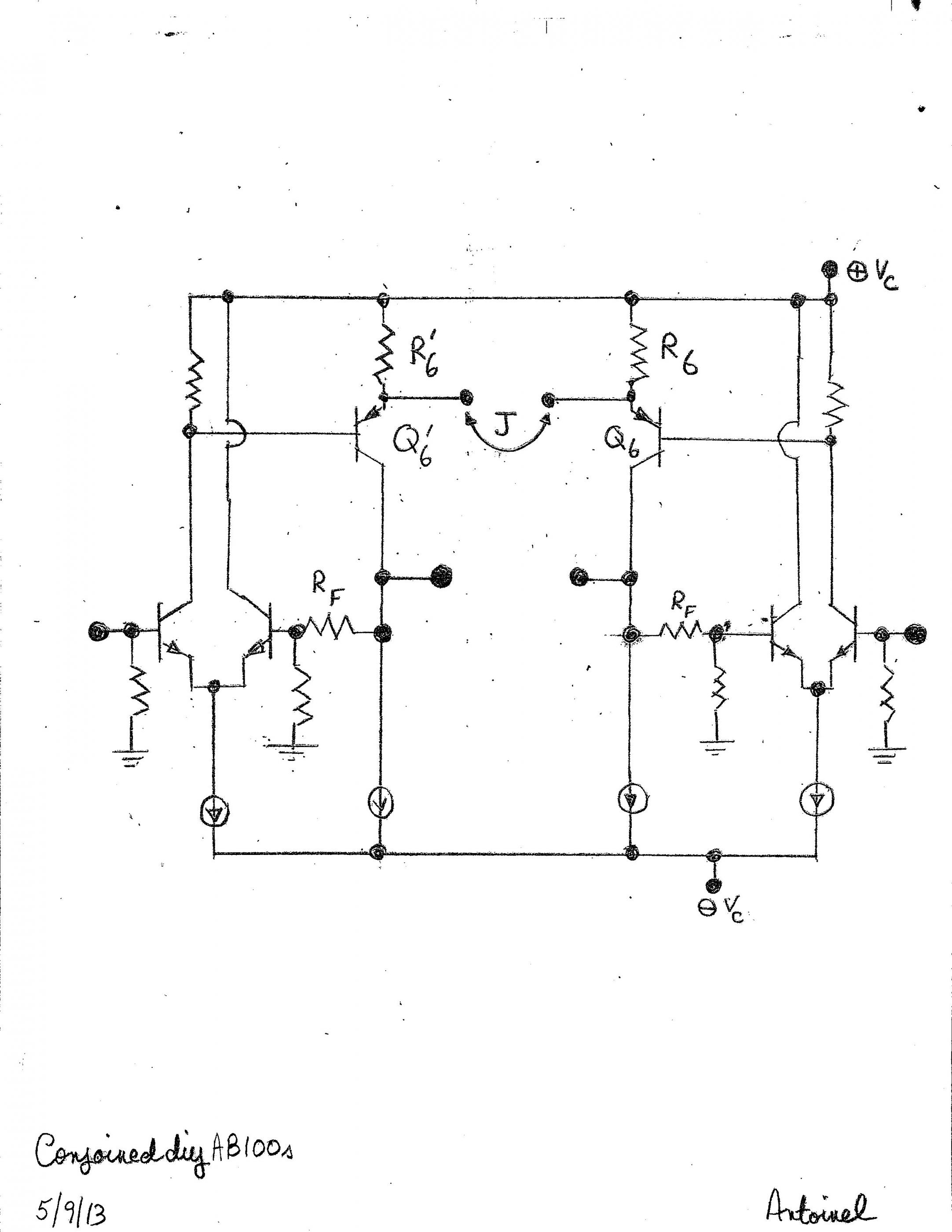

The second attachment "ConjoineddiyAB100s.jpg" is a proposed schematic for the balanced amp. The Right and Left channels are the highly simplified bottom schematics in the previous image. The general benefits of balanced designs are well known. My primary focus is to show the additional performance benefit from "conjoining" the two amps beyond the established ones of balancing. The operation of this balanced amp is very much similar in concept and application to that described in the patent US 5,376,899; inventor Nelson S. Pass.
The Left and Right amps are joined at the emitter ports of Q6 and Q6'. Jumper J can be a wire, a high quality coupling capacitor or a resistor.
The post to follow will explain the operation of the balanced amp in more detail.

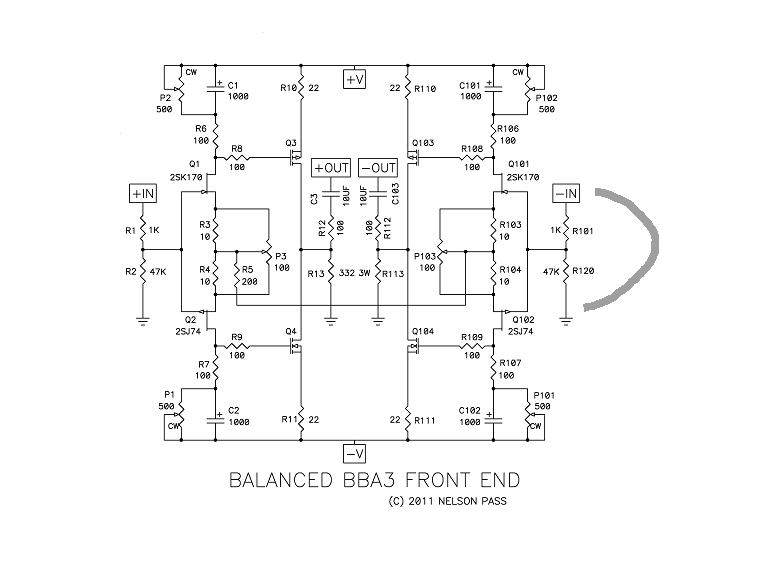

The schematic of conjoined twin diy AB100 above is different from that of balanced BA3. Please see the thread "Bridge a pair F5s" for more detail. I 'll use BBA3 FE as a working example.balanced BA-3 ?
