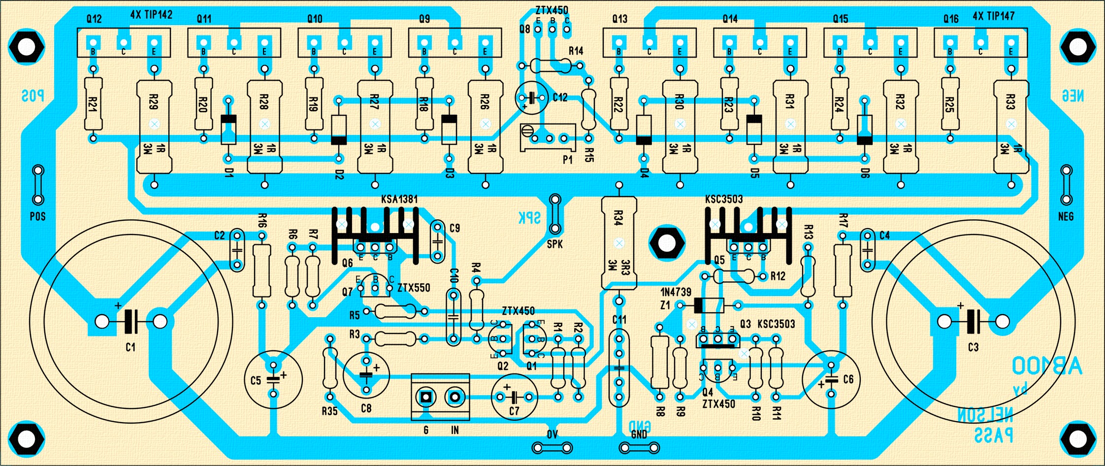

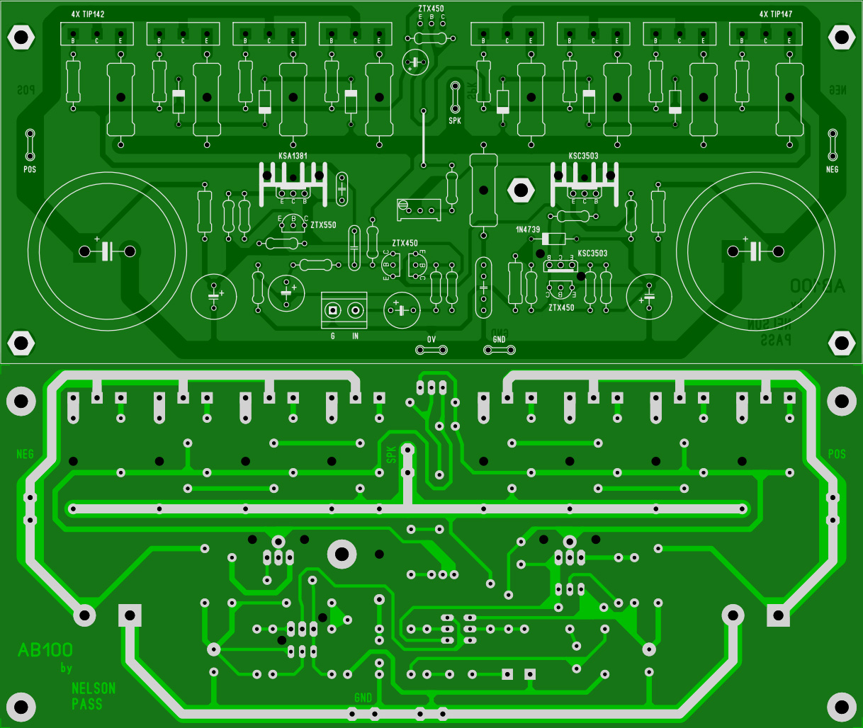

Wayne turned me on to some parts for this, and I have
started re-working the pc board to fit the sinks in the store.
TIP142 and TIP147 are $2-ish each at Digikey. It wold cool to have extra output devices in parallel to be able to drive 200W into 4 ohms, 400watts into 2 ohms and 800 watts into 1 ohms with the proper number of output devices.
It would also be cool to be able to run the entire amp at class A up to 20 watts if desired.
With the output devices operated as followers, and 1 ohm emitter resistors, how important would it be to match output devices for Vce and/or current gain? Or, if the output devices are highly matched, can the emitter resistors be reduced or eliminated?
Just try to "help" PCB layout
This is a layout from my "perspective".
190*80mm
I think maybe ZTX450/550 could be changed to 2N5551/5401 (pin-to-pin compatible)
Q3 might be quite hot (somewhere about 200mW for ±50V supply). BC639 might also works as good.
2mm holes are just to help ventilation / cooling the devices around it, so it should be more reliable I guess.
edit : R8 best be ½~1Watt resistor. You may want to change the layout a bit.
ZIP :
*.Lay6 files (Sprint-Layout 6)
Gerber Files & Drill
feel free to modify it if you find some missing track, too long track, or want to change parts layout
I'm not about to build this amp though. I already satisfied with my class-AB LME49811 😀.

Can't edit posts after 30 minutes.

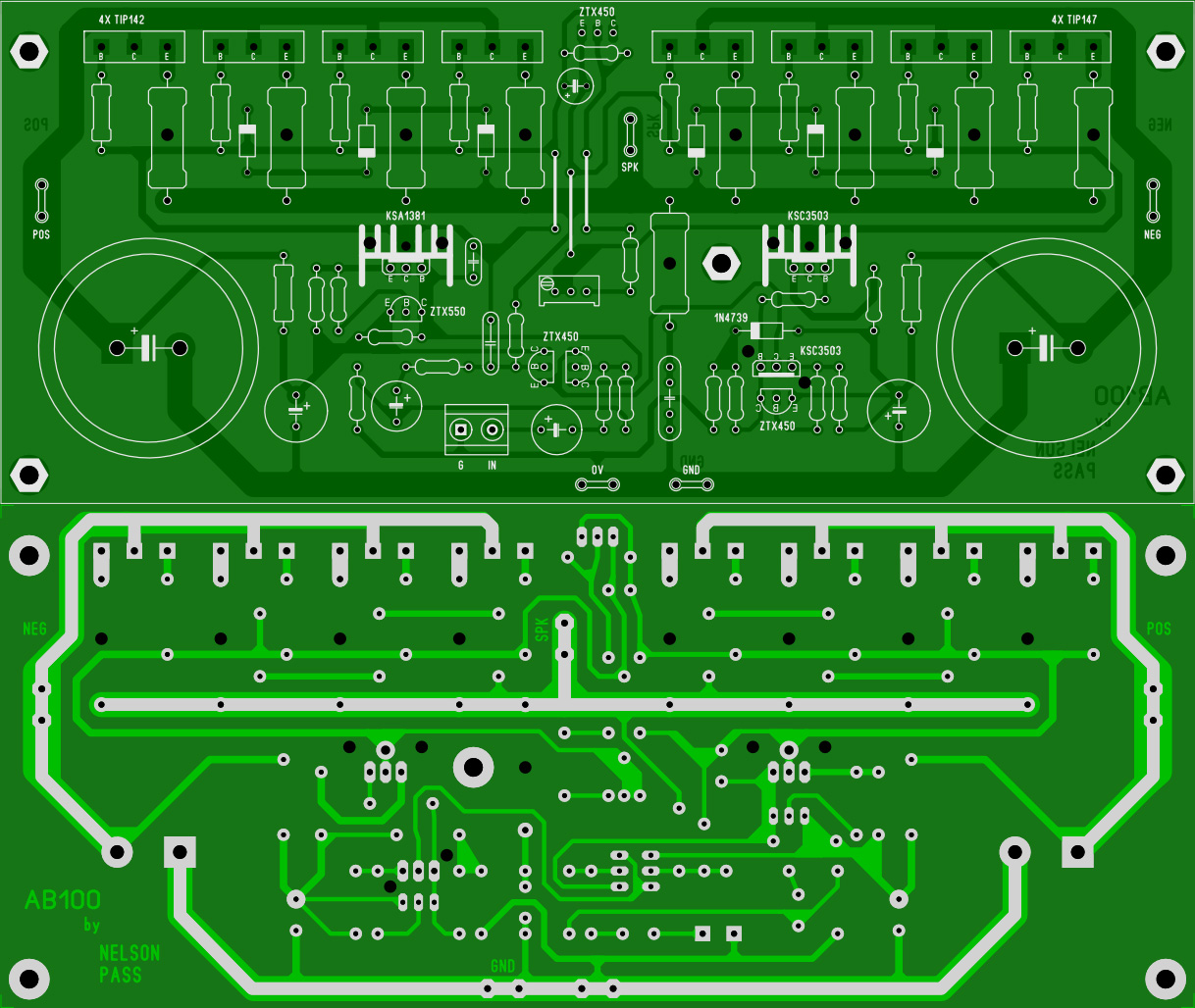

Just realize that I've put too many jumper 😀
you might want to swap the position of speaker terminal (lug?) with the trimpot (& R15) and relayout a bit, thus eliminating all jumper.

Kroto
Excellent layout. I would agree swapping the trimpot with the speaker lug. It would eliminate the long trace to the trimpot. ...or, just use jumpers or a top layer to eliminate any long traces. Double sided boards cannot be much more costly than single sided boards.
I have a small stash of KSA/KSC parts for the drivers.
It would be interesting to have a board for paralleling many more output devices similar to how some of the Diyaudio Store amplifiers have separate driver and output boards.

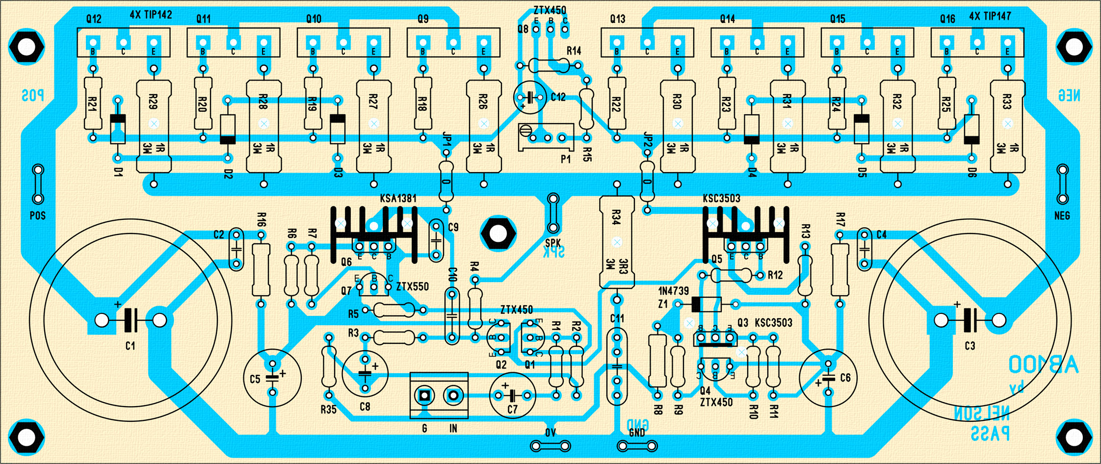

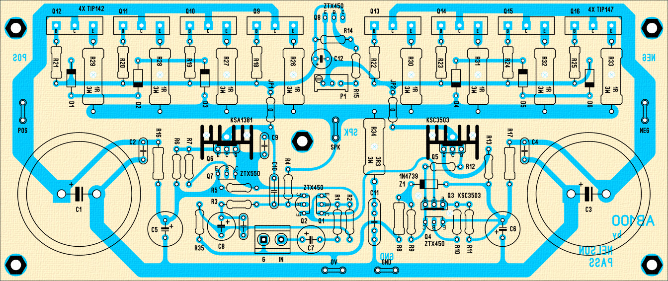

Maybe like this? :Kroto
Actually, those KSC/KSA (/w heatsink) are not drivers, they were CCS and VAS. The drivers is inside TIP14x.I have a small stash of KSA/KSC parts for the drivers.
I'm not sure why the schematic use enormously big bypass capacitor (2x 10mF/rail (C1-C4)).
To fit the PCB nicely I put only one big lytics/rail (C1, C3) and the other cap is film type (C2, C4).
The input cap is so big, that it might be hard to fit any film cap, so I put electrolytic type, maybe SILMIC II ok.
The original schematic use no Miller cap (C9), I'm not sure wheter this layout will safe from osc' with too long traces.It would be interesting to have a board for paralleling many more output devices similar to how some of the Diyaudio Store amplifiers have separate driver and output boards.

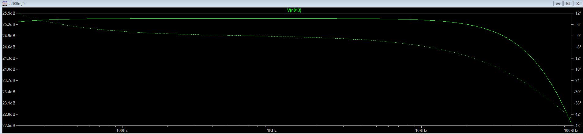

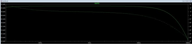

Hi, nice PCB,
I think they are (c1-c4) not bay pass capacitors - but the main filter capacitors. Input cap also can be reduced - i used 2.2uf .
Maybe you can add some film bypass cap across feedback capacitor.
i attached sim of my ab100 with 2,2uf input an 100uf feedback cap

Can you post the updated board files? This is a very nice layout. The routes are short and the parts are well-placed.
By driver, I meant VAS. I bought some of these KSA/KSC parts for the VAS of the VSSA CFB amp but never used them.
Hi, nice PCB,
Can you post your .asc?
here's the file: (I use MJE15030 / 31 and ztx450 / 550 and MJ darlingtons in a real amplifier)
