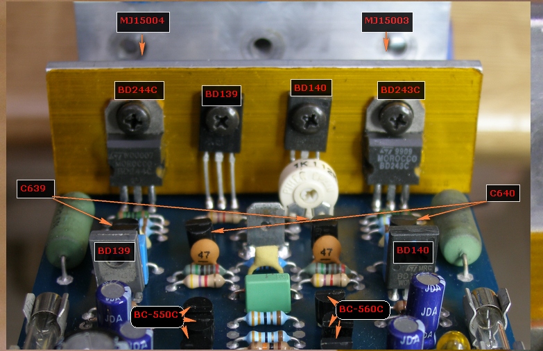

I found another one revision (?) with some changes from the rev. 1.1

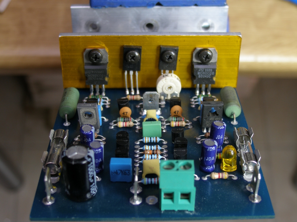

A differential symetrical input stage at the left with BC550c/560c pairs, a VAS stage with BC639/640, a triple CFP Common Emmiter Stage with a local feedback at the output with a BC639/640 pre-driver, a BD243c/244c driver and a BJT output maybe 15003/15004 or 21193/21194 (explained at the end).
At the output a zobel network RC and the global feedback net to the differential inputs.
I found that this topology is very close with the Bryston CFP Stage.
It is very important that the pairs (npn-pnp) of pre-driver, driver and output transistor have same hfe, due the CFP topology.
It is very difficult to repairing it, if someone transistor has gone.
Driver hfe must be 25-50, output transistors under 100, VAS 100 around and the input differentials much paired on Vbe.
The quiescent current must be 27-36mA, 6-8mV drops on 0R22 resistors.
Output transistors about
At the previous messages had been reported from the member Andrew-T, that the MJ15003/15004 bjt are the Aaron's No3 Millennium tranzistor.
I measured 3 original No3. Millennium bjt and the hfe was 60 (same for the pnp-npn) for the one channel and 71 for the other.
The most possible Aaron bjt's that had been reported are 15003/4, 150024/25 and 21193/94.
The 15003/4 have a hfe until to 150, the 150024/25 until to 60 and the 21193/94 until to 75.
I believe that, a low hfe 15003/4 had been used or 21193/94 pairs.

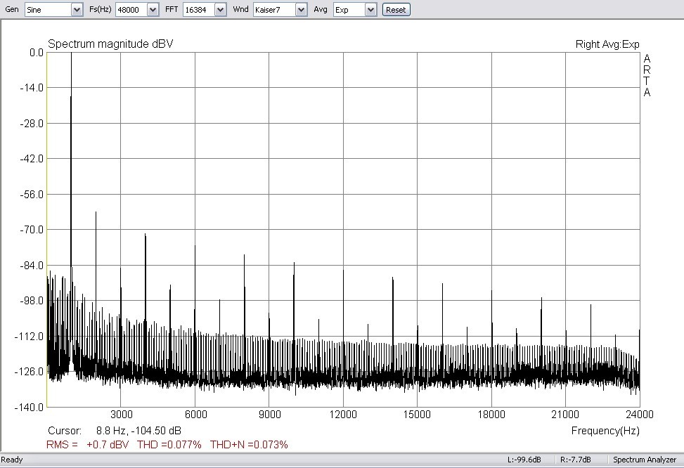

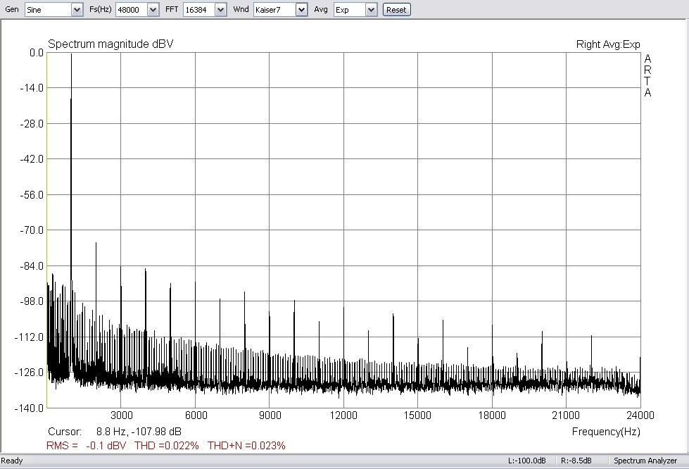

I am looking the behavior of this revision on LTSpice.
It seems that the pair MJ15003/15004 works well on low frequencies (e.g 1KHz) but at the THD 20K they have problem with the distortion.
At the other side the pair MJ21193/21194 has much lower distortion at all frequencies (20-20K).
I have enclosed the LTSPice simulations.
