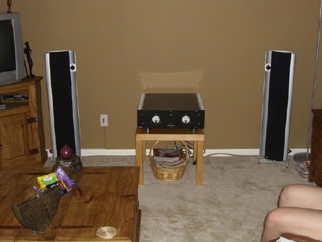

I downloaded Eagle this weekend and was able to get quite a bit of the schematic done on a train trip from Boston to New York this weekend. I intend to mount all the 220's which will include Q1,2,4 and 5 outboard of the board on a heatsink or the chassis' bottom plate which is 1/8" aluminum. I remember the biggest broblem with the A75 was the very delicate bias adjustment and therefore will try to find a nice multi turn trim pot. Any suggestions are welcome. For the most part, the pad spacing for all the resistors are going to have to accomodate 1/2 watt Rikens which have an almost 10mm body. Some of the resistors like R11,12,25, and 26 are going to be 1 watt Rikens with a 14.3mm body to allow for the additional dissipation due to the higher voltage rails.
Bob, save me one of those boards, I'd like very much to try it.
Alain, thanks very much for compressing my pic but it is still too big. It's getting kicked back.
The Bourns 3296Y is either included in Eagle or in one of the downloadable libraries (bourns.lbr). It's a bit hard to find using search. search on r-trimm32*. The 3299W has the pins in a line, if you prefer that arrangement.

Unfortunately, that's the only pic I have of the amp except for a couple that I took with my camera phone.
