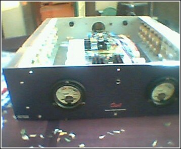

i am prowd to say that at the last happening in Montreal. my A75 and CCS-X-Bosoz
got me some nice compliements, and served on about 8 speaker pairs, from
Fostex, and some others 2 3 ways. Giving a "good" sound.
Follow the link :
http://www.freewebs.com/ulzog/journediy.htm
Picts 2,3,4 are from my Bosoz
7 is the Bosoz/Ono PS
8 The A75
