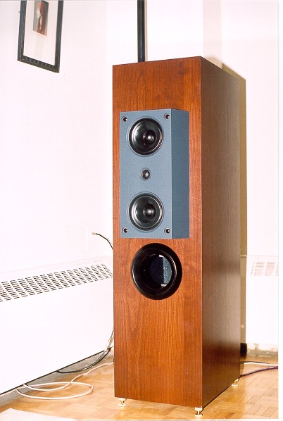

And this is what I am using of speakers.
Hi
No, actually there are 104/2 and 107/2. As you can see I have used new old stock parts. The front midranges and tweeters are 104/2 - Raymond Cooke Reference Series
And woofers (each box has two of them inside) of Kef 107/2 12” Reference Series as well. Crossover is from Raymond 104/2 Series also. They are all perfectly matched. Capable of providing 300W 95dB. Box is 75 liters + MF/HF. Sound is astonishing and clear like a crystal.
From 18-20000Hz so that really nothing is missed. Only what I am looking (and maybe you are selling) is to by original 104/2 air ports for which replacement I am using something a little different as you can see, but pretty similar.
Thank you for asking.
Trigon.
