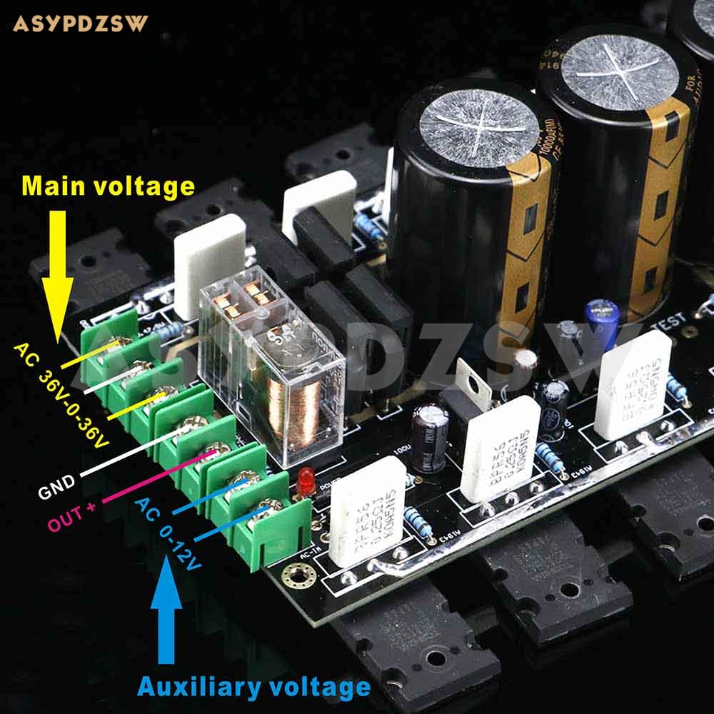

Meanwhile, fix the boards on heat sinks. Make 3mm threaded holes for each transistor. Be careful and use lots of lubrication, otherwise you may ruin your expensive heat sinks.
Also, you will need a small 12VAC transformer as auxiliary power supply for the internal speaker protection. Protection is on-board but needs 12 VAC external supply. On the image below you may observe connections to the boards.

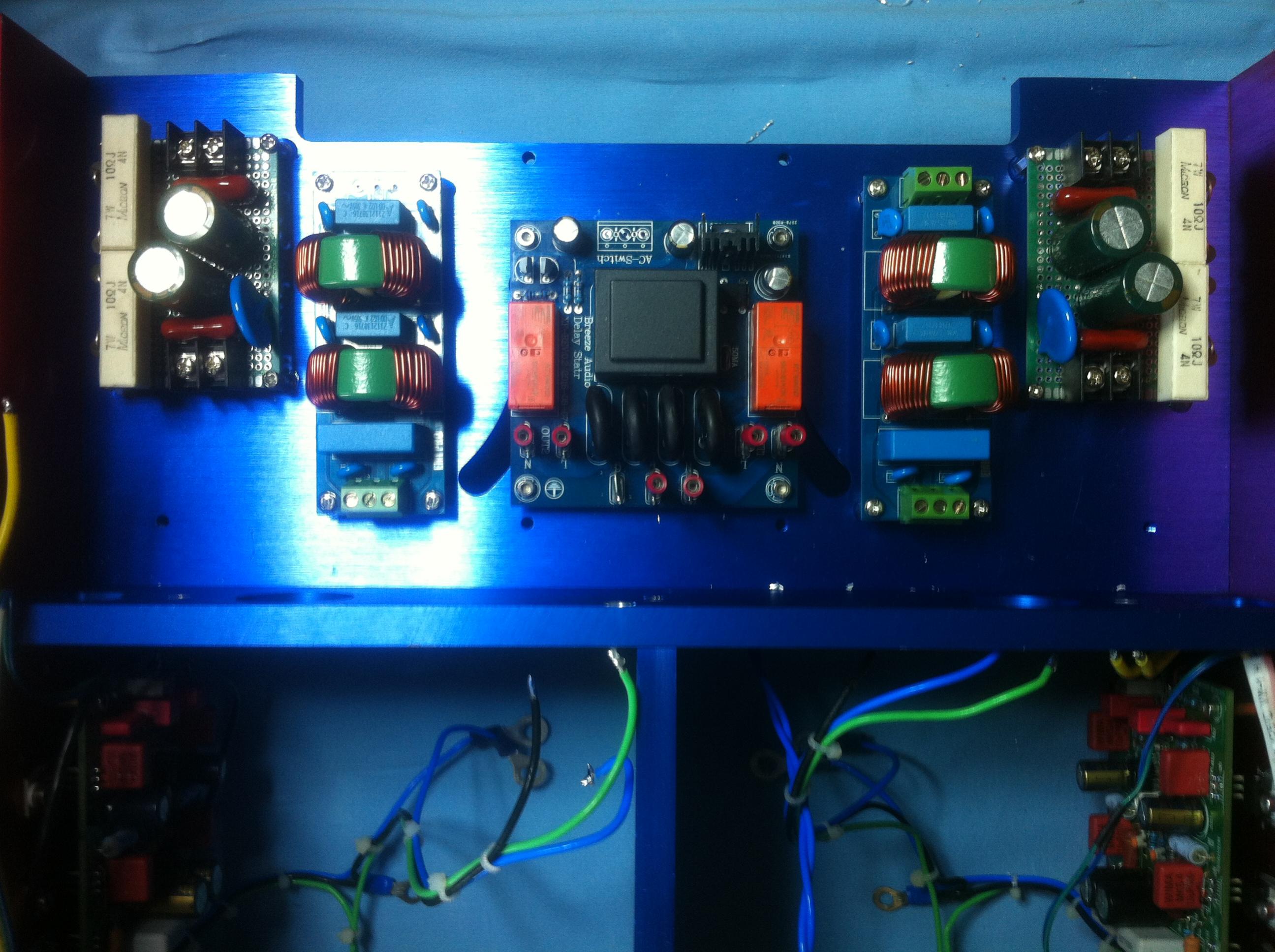

Okay. My transformers already have 12VAC outputs. Now I'm racking my brains where to place the soft-start board and how to make friends with it with the button on the front panel. I also think to do this project during the holidays in May.
Parahod4
I do not plan to increase the capacity in the power supply, since I have 2 transformers and there is simply nowhere to put capacitors. I saw a soft start board in your photo (another site). Tell me how the mains power button is connected to it.
Berlusconi Hi, I didn’t disappear, it’s just that household chores take more time, but I read all the time.🙂 vmk2002 Put here a photo of the case (dimensions) what kind of boards you have and radiators. The button is connected (on the board on the right) AC switch.

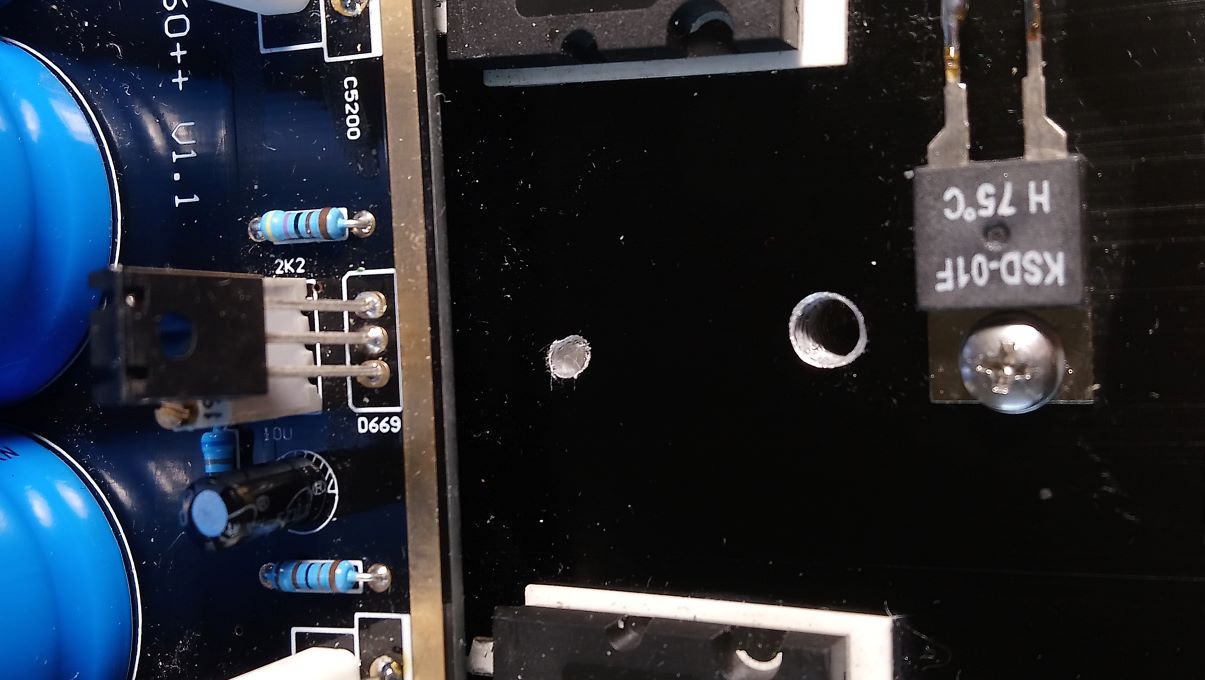

Today I have been investigating my A60+. There is design error that should be corrected, otherwise thermal run-away is possible.
The bias transistor 669A is located above the board and can not sense and compensate bias according to the increase of the power transistors temperature. Therefore, as the temperature of output power transistors increases, bias transistor remains approximately at the ambient temperature. As temperature of heat sink increases, current through the power transistors will increase and further increase temperature. The bias transistor should provide negative feedback based on increased temperature.
Solution is to de-solder the 669A transistor and solder it below the PCB so that it is connected and fixed to the heat sink just like the power output transistors. Be careful with 669A transistors if you have to purchase new device. Some of them aren't plastic and you have to isolate it with mica or alumina.
I bet your 669A is at the right place, fixed on the heat sink. 😎
However, I have purchased a kit with misplaced bias transistor. In this kit version the 669A transistor is soldered above (please, see the attached snapshot), without contact to heat sink and there is huge risk of thermal runaway. To achieve safe operation I had to relocate the top-mount 669A transistor. Now, after re-soldering it is at the right place to adjust bias according to temperature rise.
On the attached snapshot you may see also temperature switch thermostat fixed to the heat sink which automatically turns of the entire amplifier if temperature approaches 75°C. Safe is safe. 😉
I have similar, but a bit smaller heat sink 0.3W/C(300X200X45mm), and I have maximum 52°C. It is large enough to handle the heat at constant continuous 80W output of 25Vrms 1KHz sinewave into 8 Ohm load.
For example, today I have measured 42 mV initial bias at room temperature, 24°C. After a quarter an hour, under constant 80W load temperature has increased to 50.2°C steady state but the bias value has reduced to 30,8 mV. This indicates that the negative feedback works properly now.
Without relocation of 669A transistor on heat sink, the temperature would have gone further up, perhaps towards destruction of output transistors.😱:firefite:
And, by the way, have a pleasant week end. 🙂

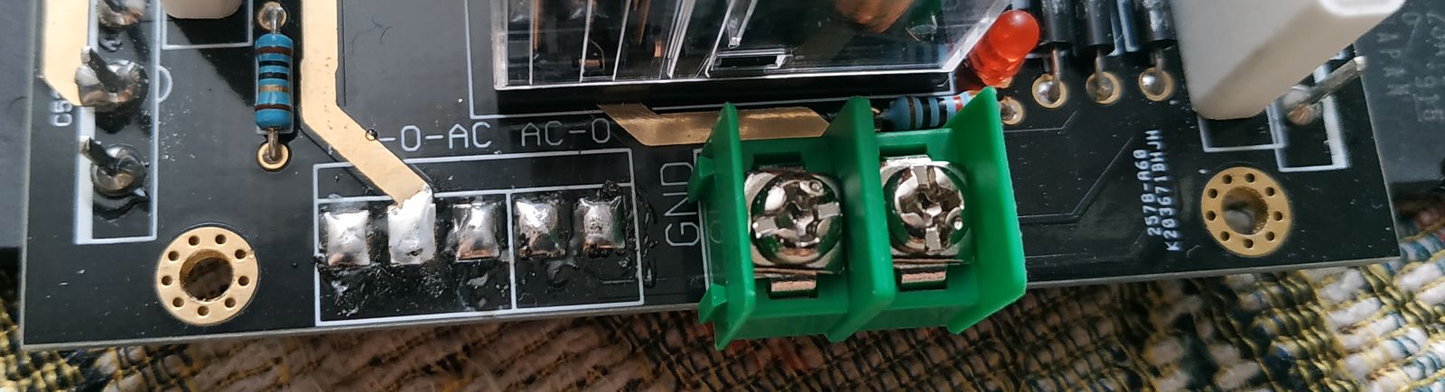

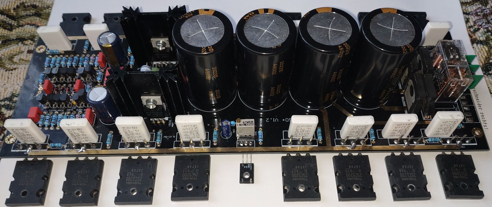

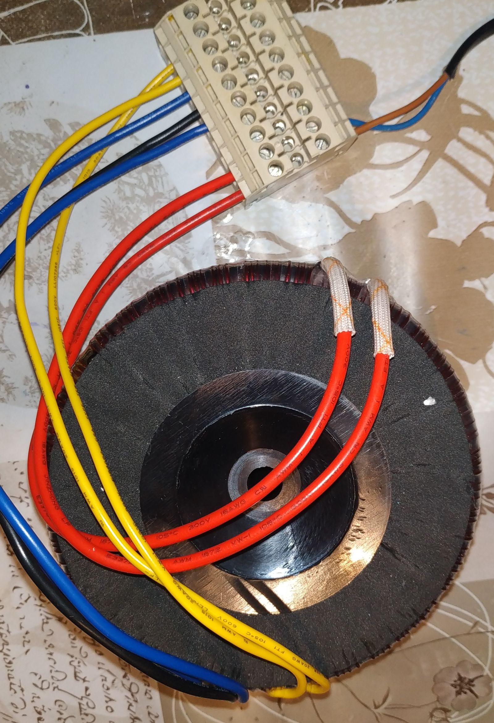

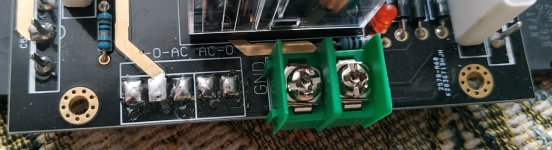

Hello everyone! Finally I received a package with transformers and transistor boards. I checked the transformers, it turned out like this: blue wires are 36VAC, black is the middle point of 36VAC windings, two yellow wires are 12VAC, two red wires are 230VAC primary winding.
The photo shows the absence of a terminal block for powering the board. Does everyone have it? Also wondering which is more efficient, an aluminum oxide or mica heat-conducting insulating pad? The Chinese man sent me from mica, but I have from aluminum oxide. As I understand it, you need to connect 36V-0V-36V to the points of the board marked as AC-0-AC, and 0V-12V is needed to the AC-0 (no matter which of the wires with 12V is left or right)? I would be grateful for your answers, and yes, I will not connect without radiators (while the case is on the way) ...

vmk2002 make the board the largest, they are different
It is new version 1.2, mine is 1.1.

First verify voltages on the transformer and,
Second: very important: MAKE A CURRENT LIMITING DEVICE: look here:

You are correct regarding the AC connections. You can use any other similar terminals but select the one with adequate distance between the holes.
