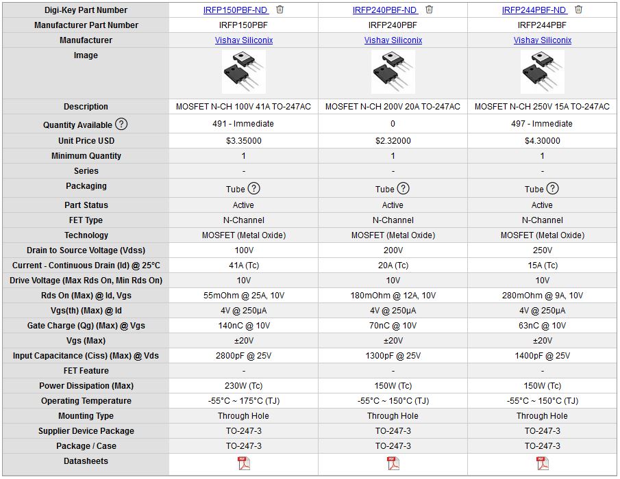

Which transformer is recommended for an A60 these days? If not a model, perhaps VA rating and secondaries. Should this be 28VAC at 800VA?
Aleph 60 Mosfet Options
Curious what experimentation over the years has demonstrated as sonic differences between Vishay IRPF150/140/244 in TO-47AC packaging? I know Papa went with 244's. I noticed the input capacitance of the 150's is much higher than the 240/244 specs. Not sure of the impact of higher capacitance.
I like the idea 6 IRFP150 devices instead of 12 240/244's per A60 channel.
The help is very much appreciated from the form so far!

as long output mosfets are chosen in a way that there is no BigBadaBoom, differences in sound between various types are smaller than people usually claim ...... under condition that FE is having enough Cojones to feed them all :rofl:
The input capacitance is higher with the IRFP150 but you will probably use fewer
of them compared to IRFP240, so no biggie.
Members have built Alephs using many different devices and power levels from headphone
amps to big Aleph 2 using the same topology. Within reason, many parts will work fine.

Great thread to bring back up.
I've very interested in experimenting with 6 IRF150's per side for an A60. I'm listening to a Volksamp 30 right now with my Magnepan 1.6QR's and just love it; however curious to hear the effect of greater power in driving the speakers. In a past life I was an electronics technician with mad soldering and fabrication skills and am enamored with DIY.
I'll need a little coaching on the engineering side adjusting the Aleph 60 schematic to accommodate the component replacements for 6 IRFP-150's per channel then 12 IRFP-244's.
I'm assuming the A60 schematic and PSU requirements remain the same, and wondering which resistor values change to accommodate the IRPF150's?
