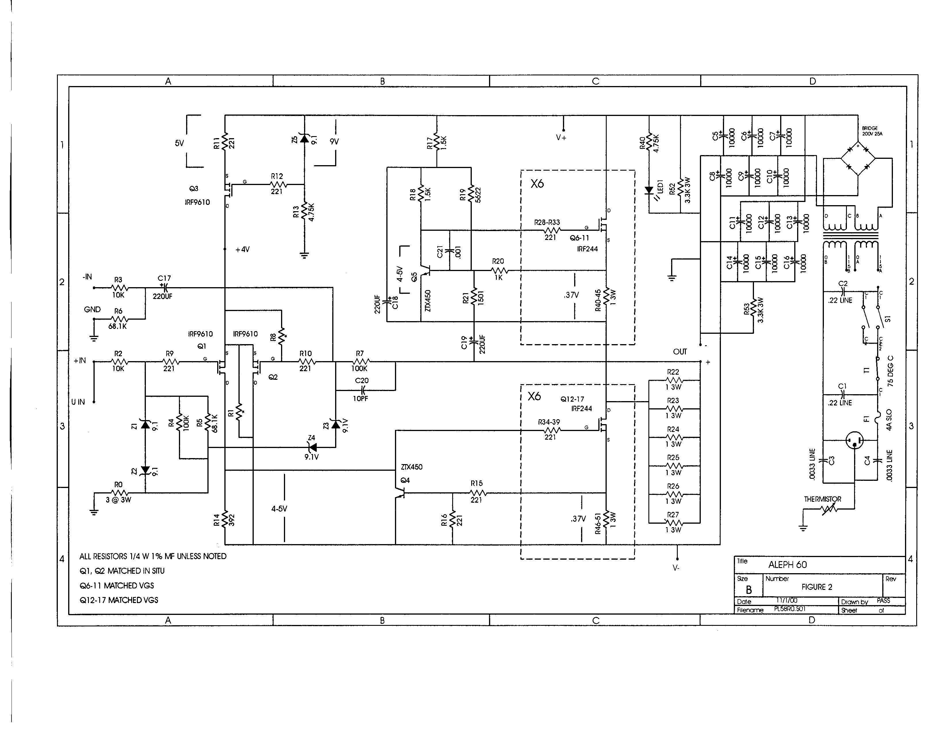

Aleph 60 Mosfet Options
Curious what experimentation over the years has demonstrated as sonic differences between Vishay IRPF150/140/244 in TO-47AC packaging? I know Papa went with 244's. I noticed the input capacitance of the 150's is much higher than the 240/244 specs. Not sure of the impact of higher capacitance.
I like the idea 6 IRFP150 devices instead of 12 240/244's per A60 channel.
The help is very much appreciated from the form so far!

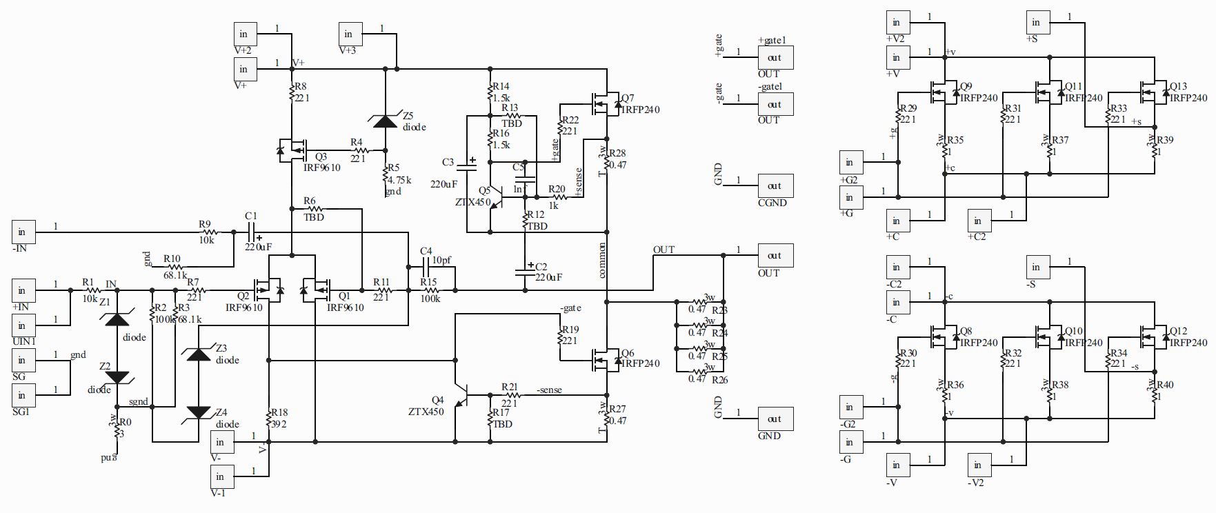

Great thread to bring back up.
I've very interested in experimenting with 6 IRF150's per side for an A60. I'm listening to a Volksamp 30 right now with my Magnepan 1.6QR's and just love it; however curious to hear the effect of greater power in driving the speakers. In a past life I was an electronics technician with mad soldering and fabrication skills and am enamored with DIY.

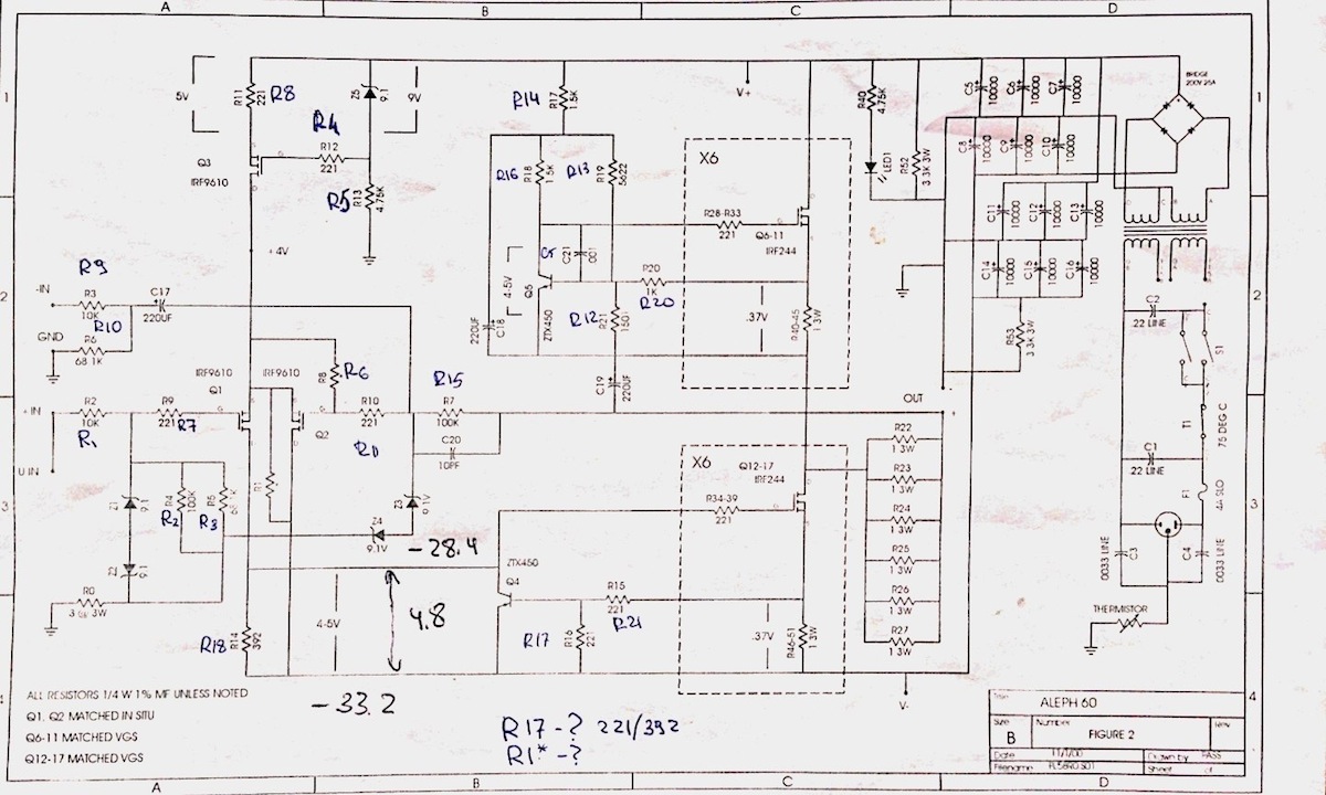

I'll need a little coaching on the engineering side adjusting the Aleph 60 schematic to accommodate the component replacements for 6 IRFP-150's per channel then 12 IRFP-244's.
I'm assuming the A60 schematic and PSU requirements remain the same, and wondering which resistor values change to accommodate the IRPF150's?
Thank you for help with this journey!
just halve values of each 3W source resistor in output stage
do the same with 3W resistors in output route (ref. original schm: R22-R27,output current sensing)
that's it - one 150 will replace 2pcs of 240, and Aleph CCS AC gain will stay the same
