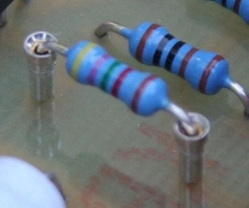

Maybe this little thing will help someone.
I don’t like trimmers of any kind, so in this project I came across a solution for fitting resistors that may be easily swapped with resistors with different values. The catch is in the pins taken from DIL IC sockets.
