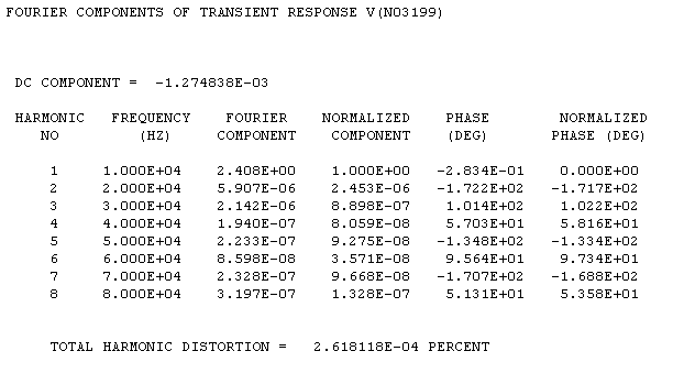

I went ahead and ran a sim on the circuit shown earlier using dummy parts form the PSpice library and power Darlington outputs. The purpose was to see if the input diff stage balanced, and to adjust values for appropriate bias levels. I found that an alternate connection for the diff pair cascode bias resulted in lower distortion. I'll post the results when I get home.
OK - here's the PSpice sim I ran to establish balance and bias levels for the finished amp. The sim works well with standard power Darlington outputs. This might be an option for another amp entirely... Here, though, the objecitive is to set bias levels for an input/drive card for a lateral FET amp of ~100W/channel.
I updated the layout to either work with Zetex/Diodes, Inc. small-signal mosfets, or MPSA15 and MPSA64 Darlingtons. This change helps to reduce the capacitor size in the feedback network. I also pused the input transistors closer together and turned them around so that I can use thermally coupled matched pairs. Layout is actually done, and I'll give it another once-over and perhaps order PCBS this weekend.

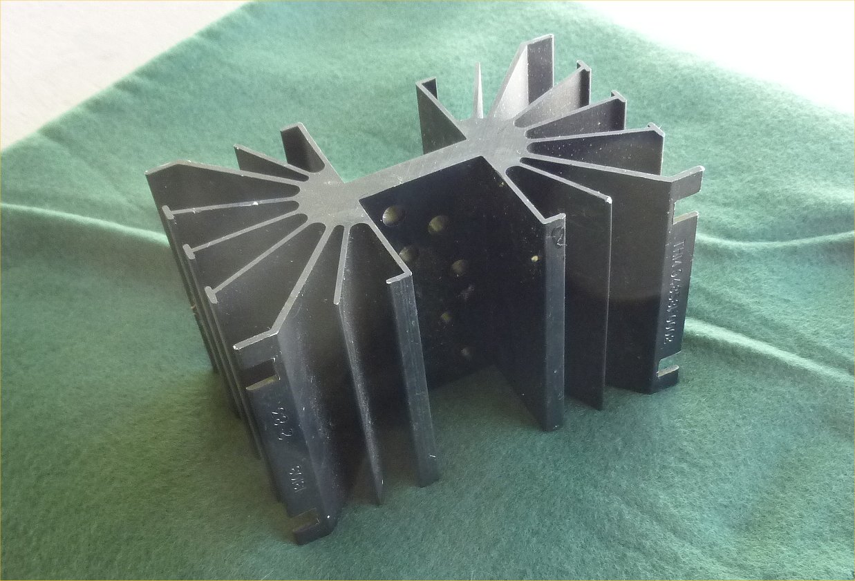

Here's one of the heatsinks I'm considering using. I'd be using four of these per amplifier, with a pair of mosfets on each. I also have some nice "tunnel" heat sinks in case I decide to go heavy on the Class A bias...
