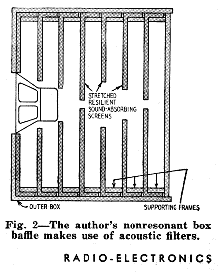

It's going to end up almost aperiodic with all that stuffing and the missing back wall. Adjusting how much works is going to be a challenge. Interesting concept.
What do you mean when you point to aperiodic?
I do not yet have a clue how much stuffing would need to be applied, but I think there is plenty of room for it. What is shown is 8 2 inch thick pieces of the chopped cotton wall batting, mostly just to indicate that a lot will likely be needed.
I have no intention of building this beast, just wanted to complete the thought. If anyone is interested in it, I can provide the Autocad 14 solid model it comes from, or the Sketch up import.

Oh, I thought you had drills, saws and glue all ready! =(
Not really sure about the aperiodic, but looking at the stuffing and the missing back wall made me think that. You have a sort of box, but not a bass reflex or sealed box. A lot of the back wave is going to be attenuated, there should not be much resonance. And thus no period. It's a huge resistive vent.

Bud- perhaps you should look at the old Hartley-Turner Boffle design. That worked reasonably well.
http://www.diyaudio.com/forums/multi-way/7860-infinite-box.html#post87734
