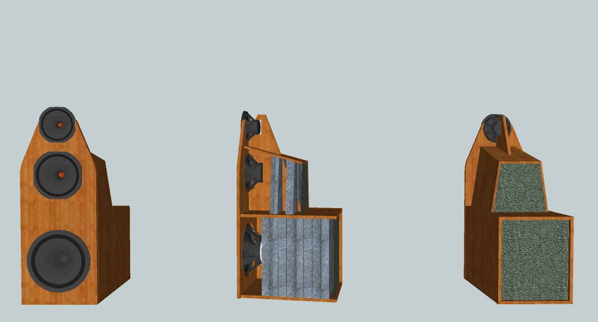

A wild hair of an open baffle idea
What do you mean when you point to aperiodic?
I do not yet have a clue how much stuffing would need to be applied, but I think there is plenty of room for it. What is shown is 8 2 inch thick pieces of the chopped cotton wall batting, mostly just to indicate that a lot will likely be needed.
I have no intention of building this beast, just wanted to complete the thought. If anyone is interested in it, I can provide the Autocad 14 solid model it comes from, or the Sketch up import.

Oh, I thought you had drills, saws and glue all ready! =(
Not really sure about the aperiodic, but looking at the stuffing and the missing back wall made me think that. You have a sort of box, but not a bass reflex or sealed box. A lot of the back wave is going to be attenuated, there should not be much resonance. And thus no period. It's a huge resistive vent.
John K calls this scheme a cardioid open baffle and you should go to his site to read up on it. You have already heard it in G Pimm's system, so you know how powerful and yet delicate and unruffled it can sound. I suppose, if you were crazy enough, you could duplicate his dual 15" driver bass cannon's......... but I still want to get to live at home.
I am pretty sure that this system would effortlessly fill a very large room with the music from a very large and powerful orchestra, choir or Organ. And it would be just as involving with a girl and her guitar. Now, Patricia Barber, live in her home town, would be pretty spectacular.

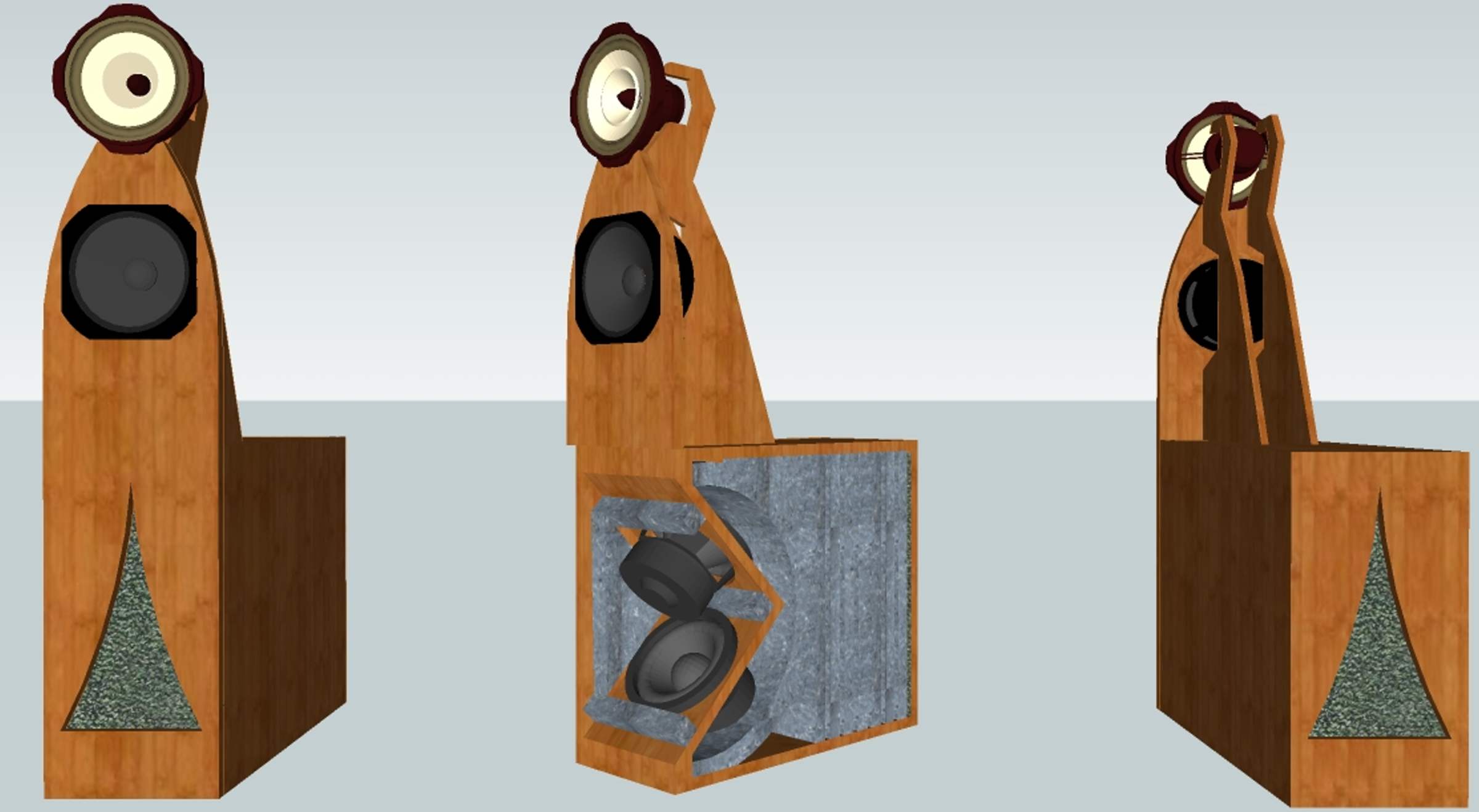

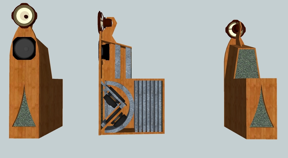

Yes I am. I have the pre-required DCX crossover box, a christmas gift from my wealthy son, and am planning to wind the 24 step attenuation transformers in the coming month. Then the modding process to get rid of as many opamps from the Berringer as I can. By then it should have warmed up a bit and I can try to talk some friends, ones who can actually make things out of wood, into helping me not ruin too many pieces of birch plywood.
Drivers are finished. I have yet to order the cotton batting for the cardioid loading, but how hard can it be.......? Gary Pimm has said he will be here this weekend with a hi rez computer based music system and one of his SS / transformer coupled amplifiers, just to whet my appetite.

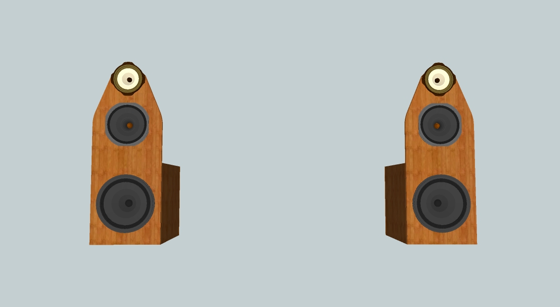

Really, really exciting project here Bud.
I see what you mean about your top driver being similar in baffle position to what I was talking about on my 3 way open baffle thread.
The Karlson slot things are very interesting, I've never heard any speakers using that design. Have you, and how do they sound?
