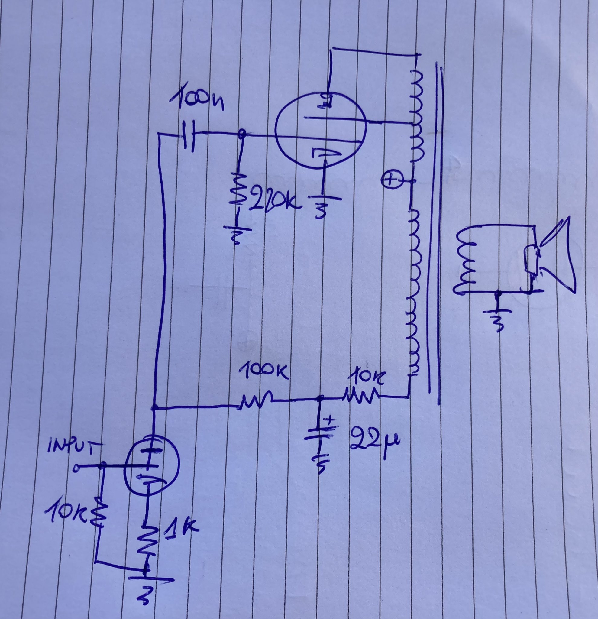

A few years back I presented my solution to the core saturation problem in a thread called "simple tube circuit transforming push- pull output transformer into single ended one" which can be found here. Readers proposed other solutions so it was quite interesting not just for me but for anyone interested in this subject.
Oldish stuff....just to say, it has been done!

A random idea popped im my mind - could you decrease the DC current flux density by permanent magnets around the core?
The problem here is the magnet flux needs to be put into the DC flux path. External magnets won't do that. You could get them to DC cancel half the total path, but that's not working for the other half.
