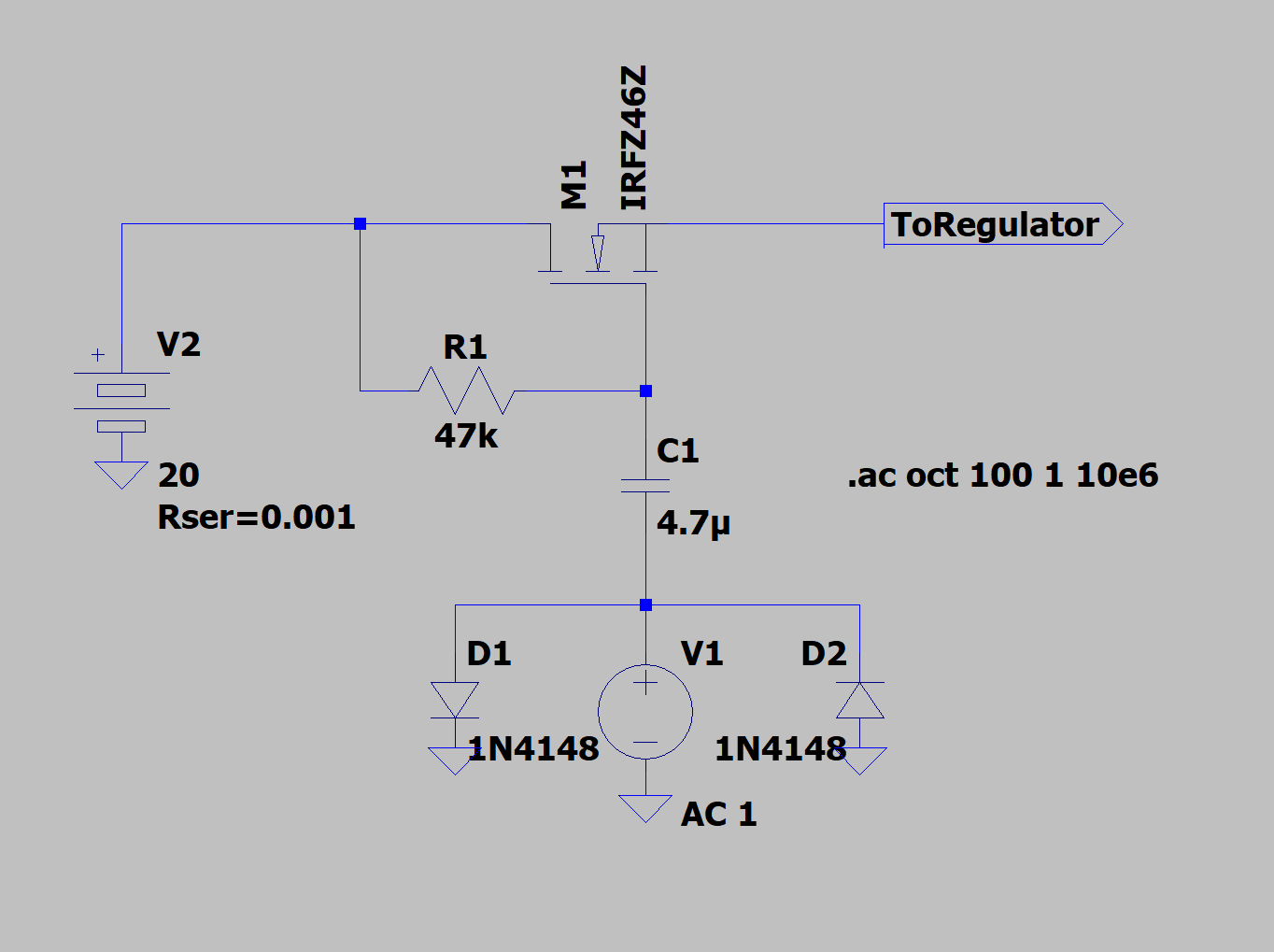

@ jackinnj: thanks for the article. Yes, all cooking with water it seems. SRRP is already very high in total. Empirically measured, I had a total figure of far above -110dB. But you triggered my interest in PSRR again. I have new tools to measure this with the AP, so maybe I am up for a more in-depth session measuring around at the real design (board)

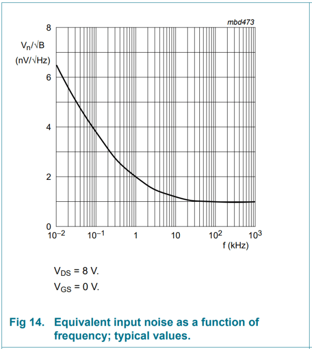

How did you calculate less noise with 10 versus 60 FETs?
By assuming that NXP (Philips) datasheet is correct.

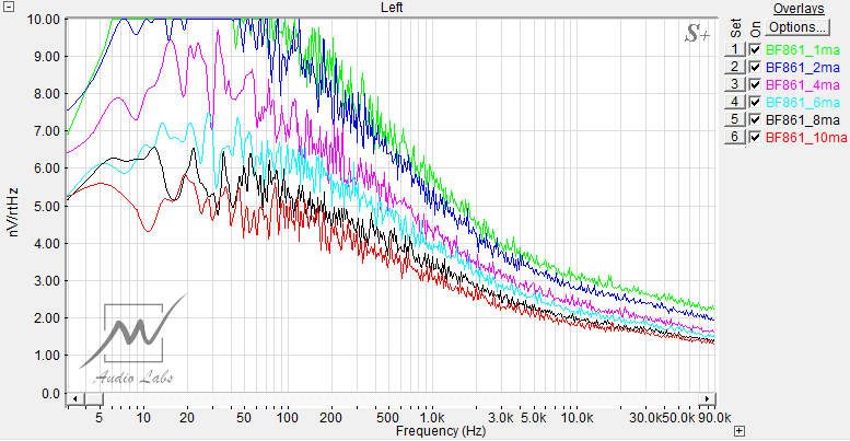

Noise density for BF861, at 1 kHz, is shown as 2 nV/rtHz. Paralleling 60 devices would bring that down to 260 pV/rtHz. JFE150 has 0.8 nV/rtHz and 10 devices in parallel would yield 253 pV/rtHz.
I can find only BF862 actual noise measurements and they are better with 1/f corner at 100 Hz and noise density about 1.2 nV/rtHz.
Assuming that BF861 has the same noise as BF862, 23x BF862 would be required to reach the same low noise density as 10x JFE150.
😳 So, I took finally a look at the schematic.
Only 10 x BF861 are used for gain. I just assumed that 60 x BF 861 were used in parallel.
Anyway, math still holds.
10x BF861 will provide (1 kHz, 2 mA Idss) 1.6 nV/rtHz noise density.
2x JFE150 with 5 mA Idss would provide 570 pV/rtHz.

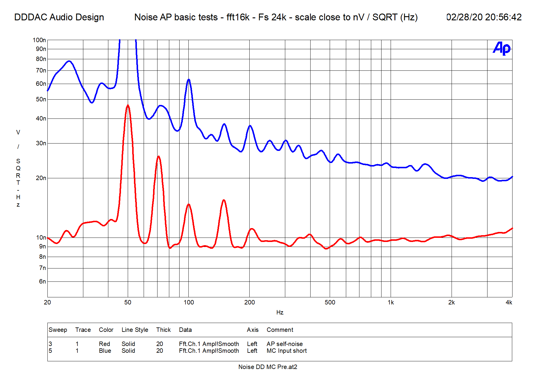

@ Tombo: thanks for sharing your thoughts and the link to the FET tests. VERY interesting I must say. Also, the JFE150 is indeed a nice part (understatement). I will dig into my old AP measurements and see if I can dig up a Noise spectrum graph from the output, so we have real data. The BF861 has a higher 1/f point indeed, certainly compared to a few from the website and JFE150. Of course, the higher frequencies are mostly "annoying" in real life (hiss...). If we would "only" consider higher frequency noise, the two are comparable. It is really the lower frequency noise which is not as good in the BF861. But still very interesting exchange. good stuff!
@Jack:
yes, thanks for sharing. a known to me also. I must admit I like the TentLabs Shunt solution. but it is one way to get to Rome...
@ Tombo:
OK, found it... In this graph you see the output noise from the DD PRE PRE at a gain of 20x. So, all possible noise contributors are included here. Please ignore (!) the 50 and 100 Hz Hum components. This was a test with too many cables flying around on the test bench...
What I see and conclude is:
1kHz and above moving from 24 to 20 nV/rtHz noise density. So "input" noise is ~ 1.2 - 1.0 nV/rtHz noise density for this range. This including Rs of 20 Ohm (!) It looks like the datasheet matches (at least) the BF861s I bought (NPX original reel; not Chines fakes like the BF862 from the author of the FET Test Website)
Lower frequency noise average is around let's say 35 nV/rtHz noise density, so only 4,8dB worse. To be honest I am not dissatisfied with this result. I was honestly very worried by the measurements of (other) BF861 you found!
Still, the other FETs mentioned are really good, especially now also BF861 is obsolete. 😉

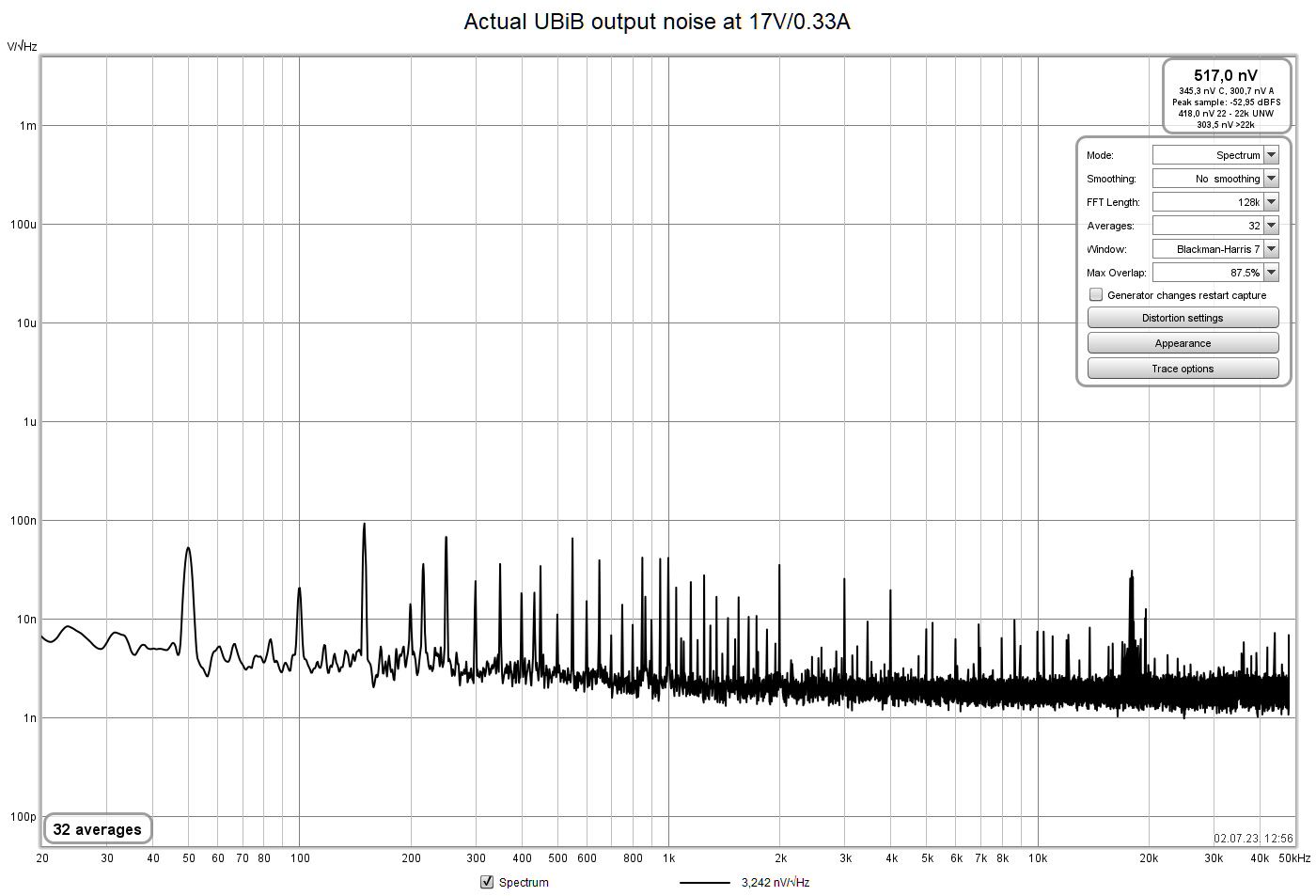

Maybe another ‘road to Rome’ will be of interest. Shunt power supply with less output noise than your MC pre has - Salas’ UBiB 1.3 shunt regulator. Though, it is more expensive than TentLabs.
Actual measurement of regulator output rail noise, used in my preamplifier:

@dddac - there is an AP macro in your toolkit "FFT Scaling for Noise" which you should use. Read the company's white paper which illustrates how to use the macro. The macro yields noise in dBV which can be rescaled to V per SQRT Hz
FWIW, I have found that the Analog Analyzer has a lower noise threshold than the Digital Analyzer.

@jackinnj - Thanks for the hint, this would be helpful. As you can see from the titel of the graph, I selected Fs and Length of the FFT such, that it is almost nV / rtHz. I also used the BW/4 function (lower bandwidth of FFT with lower noise floor)
