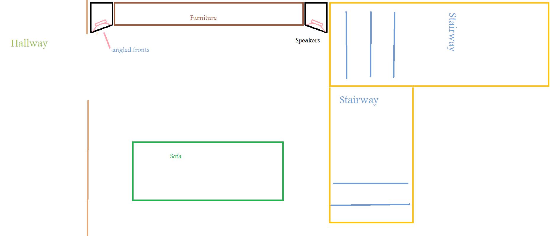

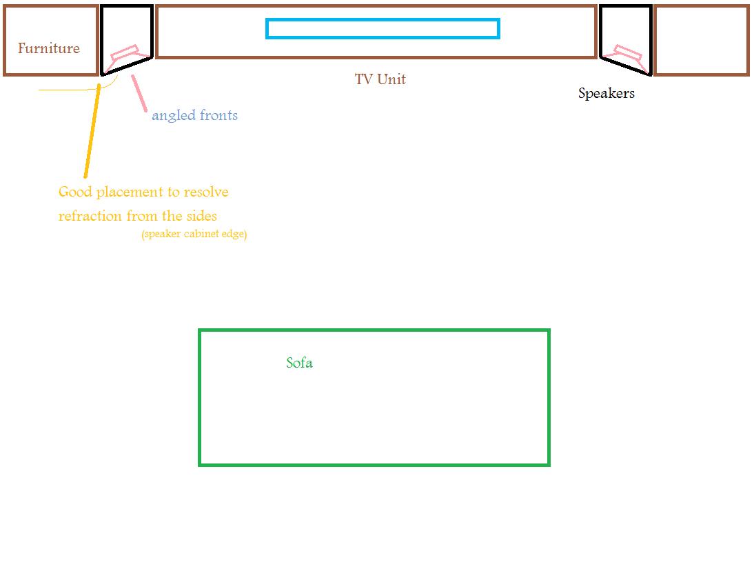

Theoretical room depicting some inbuilt furniture with gaps to fit speakers
12 inch woofer located on 10 inch wide baffle by using angle and careful speaker placement
for every inch width you can fit. for example 10.5 inch or 11, would more shallow the angle. Im not one to do the maths. You would need
cabinet thickness. driver mounting depth and width, then you can ascertain the angle needed and see if it is acceptable.
a sketch or picture of the actual room would help the idea/planning phase.

As they will/would be less wide, Can make them Taller.
This would have the advantage of them being floor standing/not needing stands
you can keep the driver layout on the front baffle the same, just elongate the box so the bass driver is a foot -1.5foot from the ground. can also make the boxes less deep to maintain there volume as it is.
if you can fit them on a flat front then the angled baffle isnt required. However with them to the sides of the room, with a stairway one side and a hall at the other, some inward angling may actually be beneficial, like wedge shaped, so they DO Sound into the area you listen and watch movies in well. (mainly the midbass-highs would benefit) And fit into there crevices dimension wise.
a diagram would aid.
so imagine the front baffle. chop off the excess at the sides, and put it underneath, the reshaping would mean the new cabinets where ...well not exactly tall and slim but taller and slimmer.
'Well Proportioned'
btw: are the current cabinets vented/ported?
P.S: Diagram likely not to scale...
