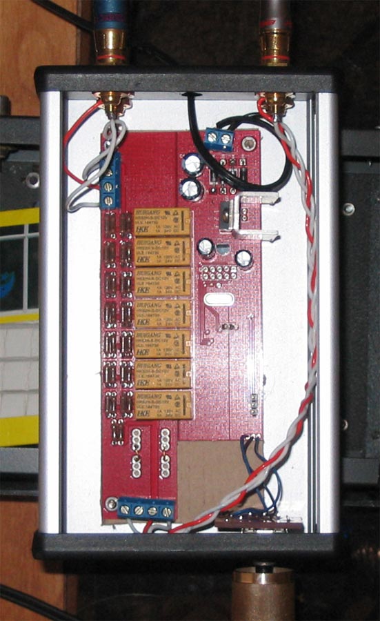

I have some questions about this relay based volume pot,
First what kind of rotary encoder does it use ? Does it skip?
How long does it take to turn p the volume to full and then back down.
The reason i ask is because with mine that i have now it takes a long time to get up to full volume and then a long time to get back down.
I've seen some where it is really quick and some that are really slow.
Any info russ ?
