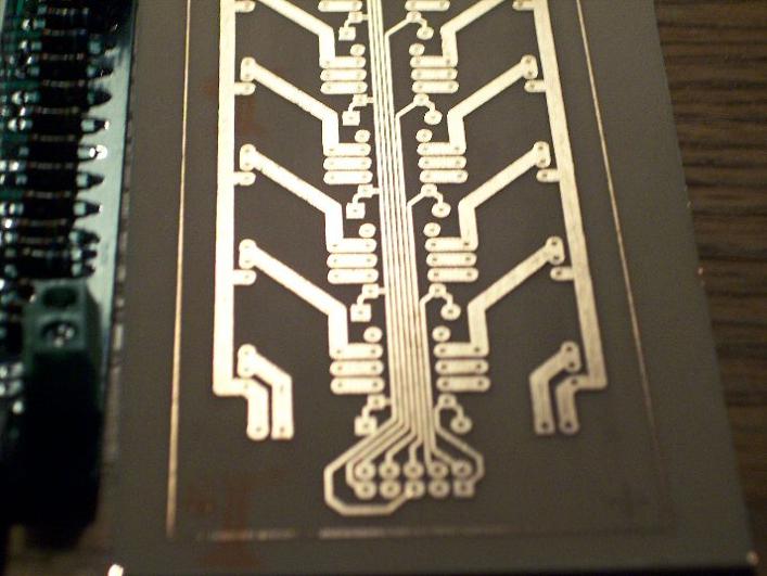

No problem. If I am digging out the stuff to make boards again, may as well make three as two. I just thought some holes would fit between the resistors on each side. It is time to upgrade to this board as I am tiring of my 4 pole dual control cermet 25K pot. The Bosoz deserves better.

1) Looks like I saved you some etchng/drilling as I have a board finished for you. If you feel like beta testing it then it is yours.
2) The controller board can be made to sit on top no problem. Just place the controller PCB over the relay PCB and mark the spots for the holes.
There will be a controller PCB and a programmed PIC in the package as well. 🙂
The traces are tight but it actually etched very well. I tested the relay power traces for continuity and shorts and they are absolutely fine.

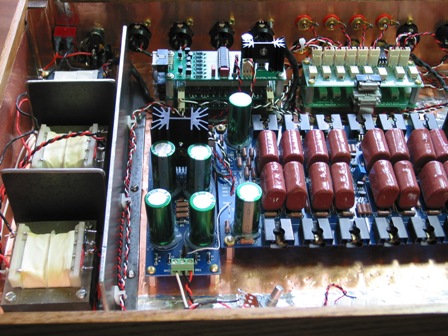

Relay Chatter with Joshua Tree
The relays in my Balanced Joshua Tree Configuration will chatter and/or run continuously during volume changes when it is installed in my preamp. It is connected to a Balanced Darwin configuration which it powers and receives its power from an 8VAC 1.5A transformer.
Interestingly enough I do not have any problems when the Joshua Tree is tested outside of the preamp. All four sections track very consistently and provide over .8V output from a 1V signal generator input.
The problem I am having with the installed Joshua Tree continues even when it is totally disconnected (power and signal) from the Darwin and/or running off an external varistat and with standard power to the preamp disconnected.
The problem disappears when the JT is pulled from the Preamp and operated externally.
Anyone have any ideas what could cause this?

Wow, I am not sure what the problem is, but the first thing I would suspect if Power/GND interaction of some sort.
Maybe try electrically isolating the JT from the preamp case. I am still mulling this over. If you can't seem to get it to work I can reprogram the PIC with firmware that should correct the problem if you send it to me.

Thanks for your reply Russ.
One of the first things I checked was the the ground to shield connectivity.
The case is 1/4" Oak covered by 3/4OZ Copper Flashing from Home Depot and I thought that the flashing might be interacting with the signal ground. While the shield connectivity went up through the standoffs I could not find any connectivity from the standoffs to signal ground on any of the three boards.

Hi roy. One thing you might try is putting a 2.2-4.7uf cap in place of the 100nf cap at C2 on the JT controller. That should help smooth out any transients or a flaky pot.
:EDIT: use a small electrolytic or tant. and orient the negative side toward the edge of the PCB.

Roy,
I just tried a 10uf cap at C2 with an old 10K pot that used to give me fits. Now it is nice and stable. Hopefuly changing to a larger cap there does that same you. It certainly can't hurt.

Russ,
Tried a 10uF 25V FC for C2. While the JT appears to work properly during a fairly brief audio test I was still getting constant relay chatter once the POT was moved to pass audio.

rpafenberg said:the JT appears to work properly during a fairly brief audio test I was still getting constant relay chatter once the POT was moved to pass audio.
I am not sure I follow you... can you please explain?
The pot should not be passing any audio.
