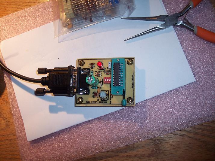

Nordic said:
I looked at those programmer links, where does the chip go to be programmed, or is the chips on the boards the ones being programmed?... I'm thinking it was the processor chip on there...
The spot on the PCB for the socket is where you put the PIC to be programmed. 🙂 There is no other chip on the PCB, just passive components. Here is how mine looks:

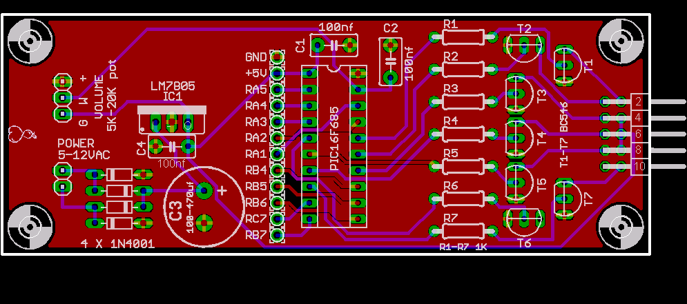

I think I am on the verge of ordering PCBs so I want to run the design past you folks so that I can be sure you are getting what you need (and most of what you want) 🙂
First the nitty gritty:
1) The PCB is designed for through hole G6K relays, and either through hole or SMD(1206) resistors.
2) Controller is designed to accept input from a single 5-20K potentiometer which is read by the uC's ADC to set the volume. It of course, is not in the signal path.
3) I left .1" ceneterd pads on the controller board so that those who wish can easily create their own firmware(or use mine) to drive auxiliary features. The possibilities here include: LCD display, IR reciever, rotary encoder, mute, startup delays (soft start) for relays, etc...
4) The PCBs are compact at only 1.5" x 4" and stackable (use 5/8" or so M/F standoffs).
We will make alternate firmware hex files available to download on our site.

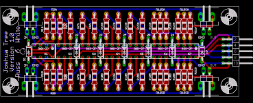

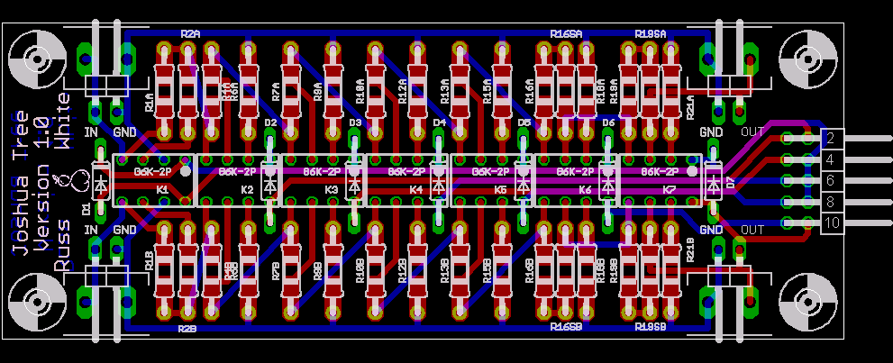

Here is the attenuator PCB itself:
Well we learned a lot by doing the attenuator which we are taking the opportunity to apply to the source selector. I would expect both in a month or so, and probably faster for the attenuator as it has already been largely tested and firmware is ready to go. Darwin (the SS) still needs firmware and testing.
Cheers!
Russ
Very nice Russ. I can almost follow this... 😉
Now for my ignorant question:
Is there only one ADC available on the pic chip used for the controller? Just wondering if a balance pot input could be added and the controller could adjust the values going to the left/right channels. I suspect I'm just making things more complicated for the controller...
regards
Dave
I imagine he means attaching another standard pot as a balance control if there is another ADC on the PIC. Assuming this additional "balance pot" is a 5k Pot
When Pot is @ 0 Ohms --- CHANNEL(L) = MainVolume - 6db.
--- CHANNEL(R) = MainVolume
When Pot is @ 5K Ohms --- CHANNEL(R) = MainVolume - 6db.
When Pot is @ 2.5K Ohms --- CHANNEL(R) = MainVolume
L/R balance is an interesting question, and one which I had thought about a lot when designing this particular attenuator. The attenuator is not intended to provide L/R balance with single ended use, not by function of the controller, but rather because each relay shares both left and right channels (its a DPDT relay).
Now with two relay PCBs one could easily create a new controller for balanced independent channels (one PCB per channel) and control them from two ADCs. One with standard linear pot, and the other with a center detent linear pot.
You could also use two sets of these PCBs and just simply use one channel on each and use slider type pots to adjust both channels.
I may work on another design with SPDT relays, but thats a lot of relays. 🙂
Cheers!
