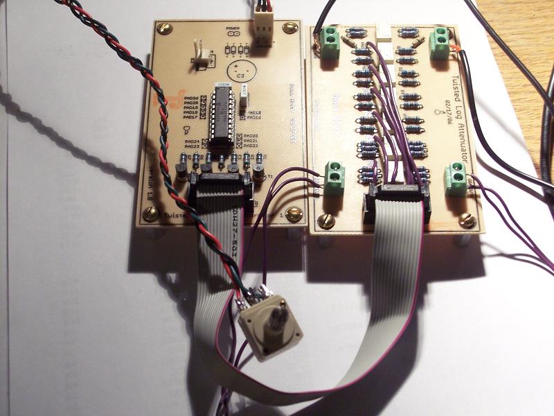

Second prototype
Note IDC connectors and only six jumpers. 🙂
There are pads for all the available pins on the PIC and one each for GND and +5V. 🙂
It sounds great, with clean/smooth volume transitions.
The two PCbs are designed to be stacked, but I don't have the correct standoffs right now (on order). But even side by side they are smaller than a standard CD case.
Cheers!
Russ
Cheers!
Russ

Russ White: if you use those flat cable connectors you can easily stack the boards on top of each other and make one cable for all.
Those connectors should be universal so anybody can there own cables.
Everything looks great.
The prototype uses Omron G6K 5V relays, which draw on the order of 20-30mA each. Not much at all. These are DPDT 8-pin relays.
promitheus said:Russ White: if you use those flat cable connectors you can easily stack the boards on top of each other and make one cable for all.
Yep, that was the idea. 😀
Thanks!

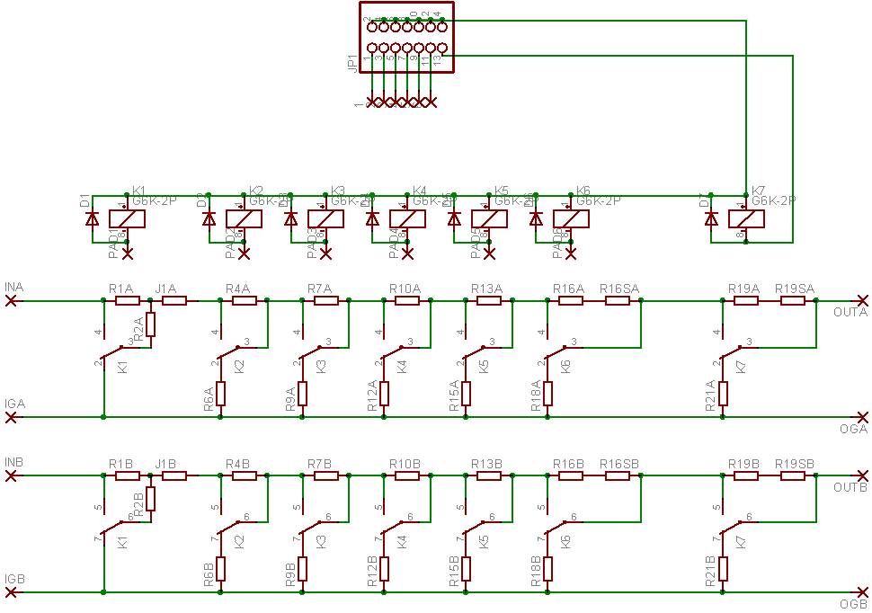

OK folks,
Here is a basic PCB layout as promised. It does 128 steps from -63.5 to 0 db attenuation.
TLA_1_0.zip
The controller is the basic controller, with just the potentiometer to ADC volume control, but I added pads for all unused PIC IO pins, and one each for GND and +5V.

Below is the resistor list for 1.5K output impedance which results in an input impedance range from 3698 to 61296 ohms. If you want to you could flatten this out a bit by placing a 10K resistor between signal IN and GND.

You will notice that in some places there is a R# and R#S resistor listed. That is because to get the optimal value two resistors in series should be used. The PCB is designed to accommodate those resistors. If you wish you can omit the low value resistor and simple jumper the omitted resistor, but you will lose some linearity.
This should be sufficient for those of you who have just want to get a simple attenuator going. I am currently starting an integrated “My Ref” Revision C amplifier project using this attenuator. And I will likely use that same values for my Twisted XBOSOZ. I will post some other versions later (with mute and such) but I would not hesitate to build this version, as -63.5 db is almost as good as full mute. 🙂
Have a lot of fun, and feel free to ask questions.
The HEX file for the PIC is included in the zip.

Here are some resistor values for 1.5K output impedance and .75db steps from -95.25db to 0db
Rin:0 Rout:1500 -db:-0.75
R1: 1635.28 R2: 18132.57 R3: 0
E96 R1: 1650 R2: 18200 R3: 0
E96S R1: 1650 & R1S: 0 R2: 18200 & R2S: 95.3 R3: 0 & R3S: 0
E96S Totals R1: 1650 R2: 18295.3 R3: 0

I tried your resistor calculator to produce a 200r output impedance with a 60source and 200out for the first stage and then 200source 200out for the remaining 4 relays. -38.75db in 1.25db steps.
Unfortunately the input impedance drops very low whenever a relay pulls in to start attenuating.
Is there a trick connection that maintains a higher input impedance and still maintain the low output impedance?
