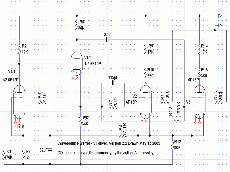

The Acrosound 20-20 has only an input cap. All the rest is direct coupled (12AX7 to EL84), with DC feedback and regular NFB. It is simple at first glance, but not easy to understand in details. There are drawbacks with DC design, but in terms of transient and details, that amp beats everything else I have.
OK, let's talk about the drawback of the DC amps. That will make us sleep a little better tonight. 🙂There are drawbacks with DC design,..
The main one is that you don't have to spend $$ in good coupling caps. 😀
Because of the nature of DC coupled design, the tubes are all DC linked, therefore:
- one tube failure usually takes down the rest with it (especially at the power stage).
- The performance is greatly impacted by the type/brand/gm/emission tubes used.
- NOS versus new tubes: some design won't work as well with new production tubes which is understandable as they were design with the tubes back then.
I am sure I am missing many others.
But IMO, these can be overcome is some ways, and DC designs are the best even if not always practical.
the use of diodes or NE2 neon lamps helped, careful design with this issue in mind is possible..
where loss of the driver tube can happen, diodes between grid and cathode ensured no more than 0.6v of grid bias, in addition to the cathode resistors in the final tubes that can be used to blow open in such an event..
