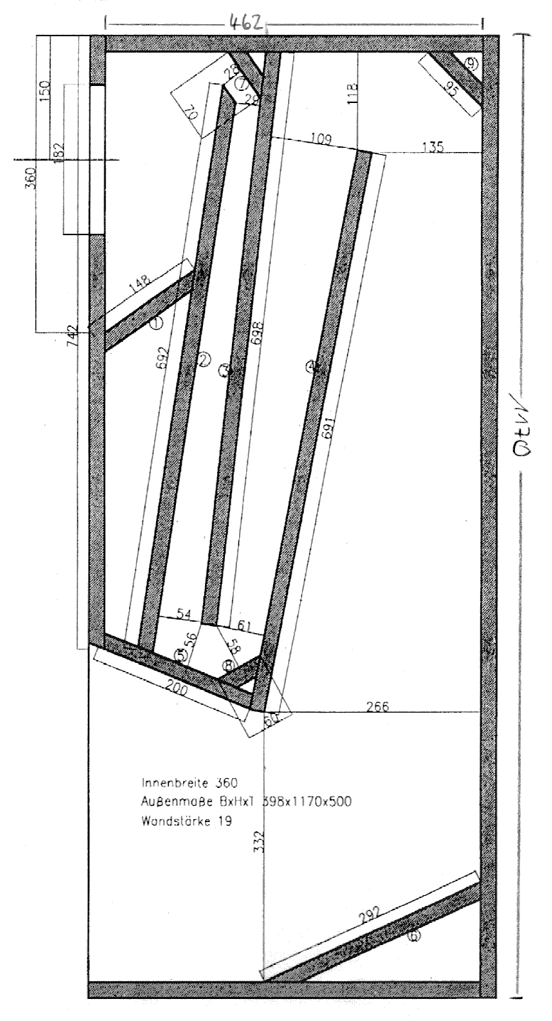

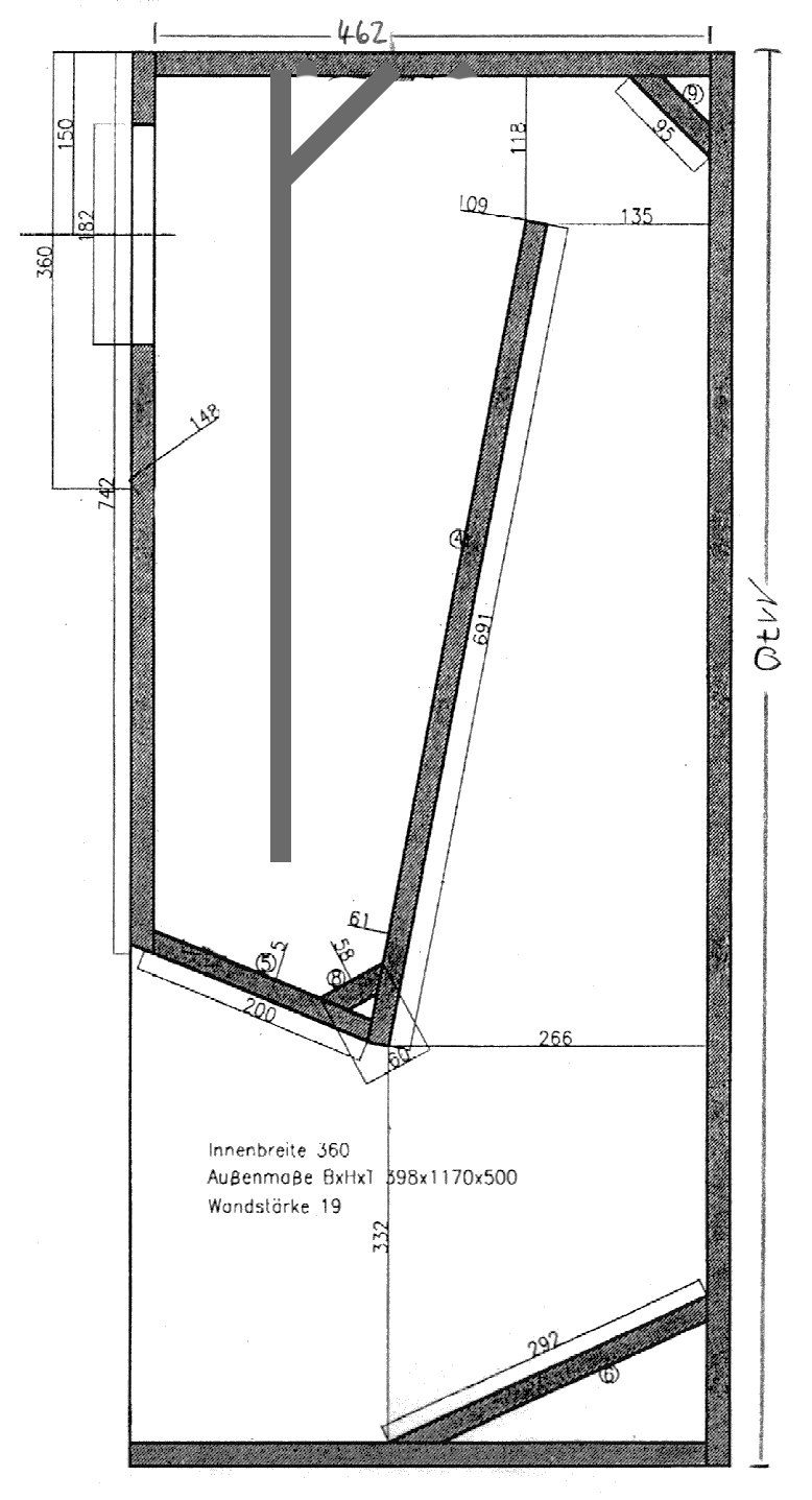

I still haven't committed to a new cabinet design! So many routes one can take.
Out of the blue, I remembered an old friend in North Carolina who had built a pair of Jericho Horns. I always wondered if they were scalable for 4" driver use. Looking at other horns like the BK-12m's that Madisound sells, made me think they could even be simplified a bit?
