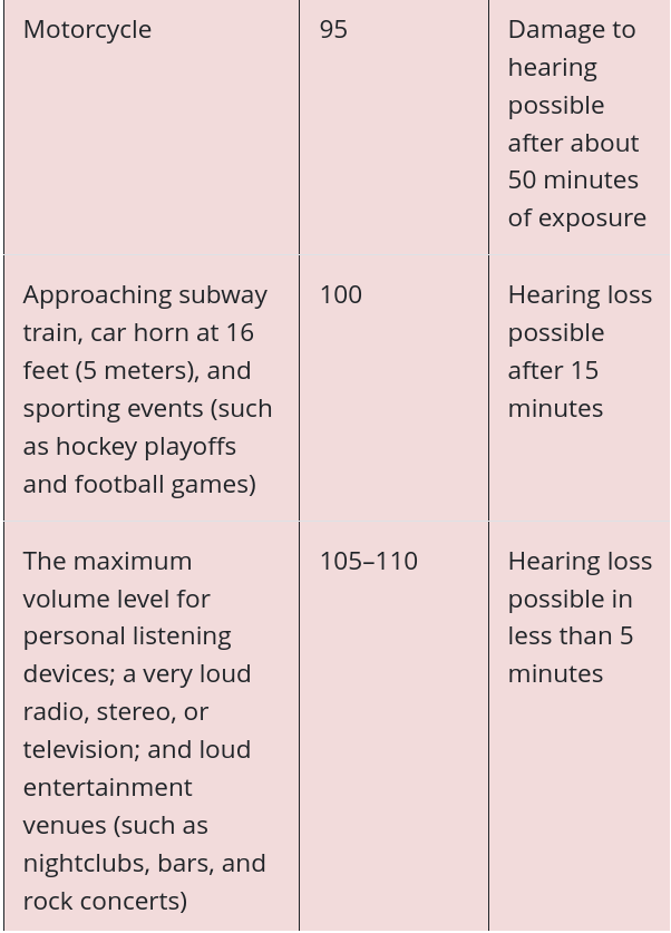

Hi 👋Jet like F15 you need a reach 120 dB...you will lose hearing really fast.....we use 80db
Have you forgotten headroom? 120db peaks are very common true peak levels at the imax theater I visit. I anticipate true peak to be about 15db over rms. If I want to use my monitors in far field, power requirements only increase. One person commented that in there country, theaters are limited to 95db average. That would equate to peaks of 110db. That is my reasoning.
At 120db rms... ears would not last long. 115db and higher true peak levels are a common day occurrence

its rare that you will see more than 15db of true peak, over peak Rms. What I mean is, for example, cinema material....will have a max average, and you won't see much of anything higher than 15db than that max average. You can draw a line there and the material will general stay under that mark. A quiet scene will come...and its possible material still might sometimes reach towards the top side of dynamics. So if 105db is max average....120db true peak.....just because a scene drops the average down to 65bd and then a loud even happens in the middle of the quietness, that touches 120db.... its sort of misleading but now it appears that dynamics could be 55db over average..... It would be less misleading if you looked at it as how much lower Average could be under max true peak.The difference between the average power and the peak power might be even higher than the 15 dB you assume.
You may want to think about whether 95-105 dB average SPL is needed, though. Have you ever measured the SPL during a listening session? Don't have an SPL meter?
I never listen to the new system without my microphone on. 95-105db average is loud. This is at 1meter. I am just trying to have enough power for Far field is all.I just clapped my hands about 25" away from the microphone and its spl true peak reads 125db.... see what I mean?
I agree with you sir, I am just pointing out that those figures are concerning RMS not True Peak... true Peak values of 115db or more are a common day occurrence... Separate True Peak from RMS and we are on the same page....I build mastering monitors and I want my system be able to produce real life dynamics without distortion is all.
Open up REW...open the SPL meter and clap....
For mastering it suggested to monitor at about 72-75db and that is my intentions. I do have sessions of listening that are louder but as stated above, damage comes from continuous listening at those levels that I would consider loud enough (95db), and I do not listen to the louder levels continuously for that long.
I wish this type of information was shared more broadly, though... I might of worn ear plugs as a drummer, in my youth.
I did note 105db averages and 120db true peaks at the movie theater.... They weren't 5 minute long passages though. Rather a action scene of maybe 1 minute? What do you think about that?
