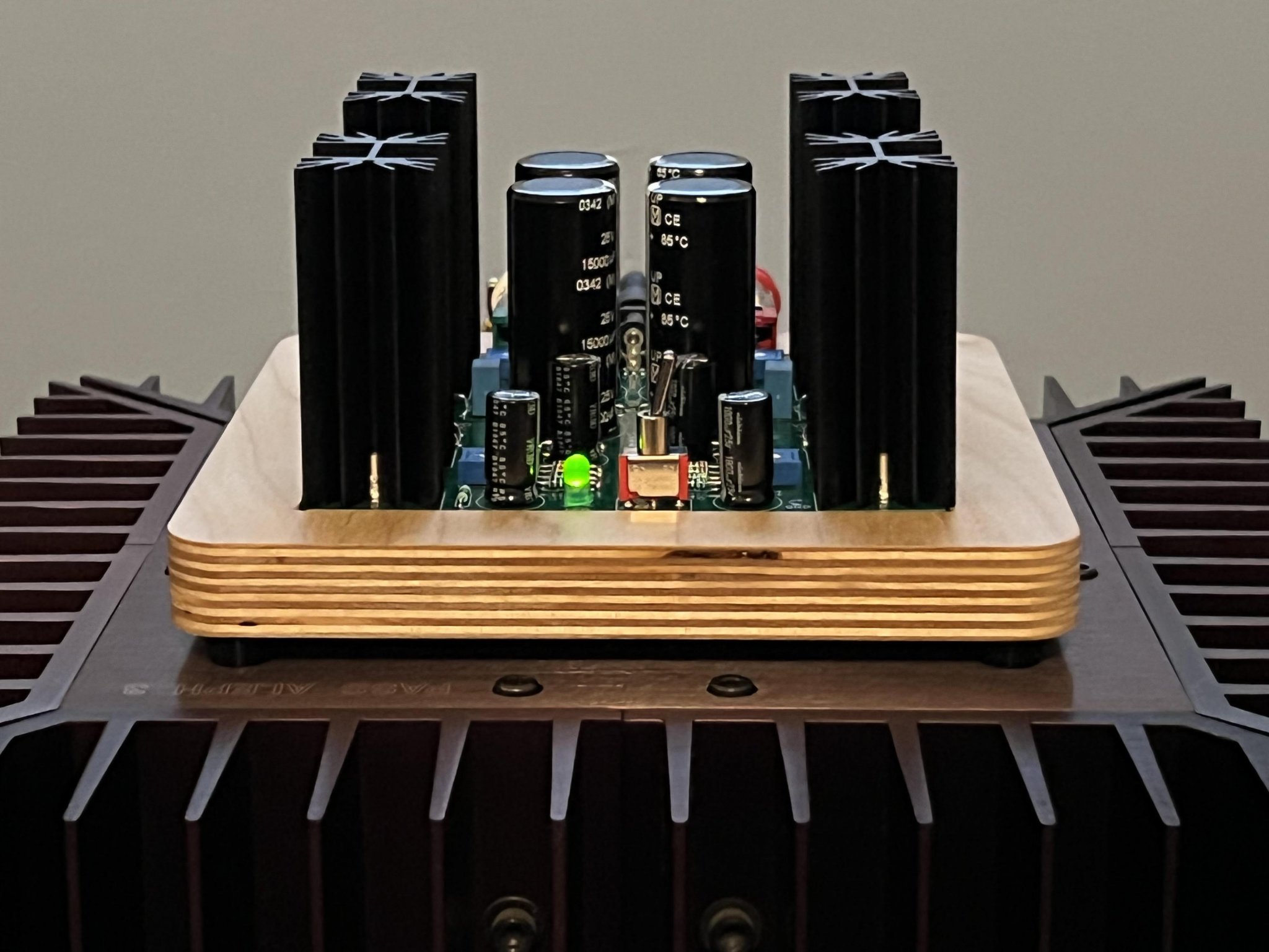

Class A PP. Could the bias be turned down and make it AB? Get away with way smaller heat sinks.
dave
Not by much, and then the distortion goes up. Plus you have to deal with an earlier klunk as it shifts to class B.
But if it had a big band of aluminum as a generous heat sink, it wouldn't get hot.
Secret trick to cool it off is to run it wide open all the time...
Okey - you are now all responsible... 🙂
Why Dave? heatsink are smaller ...dissipate only 24x0.40 for channelClass A PP. Could the bias be turned down and make it AB? Get away with way smaller heat sinks.

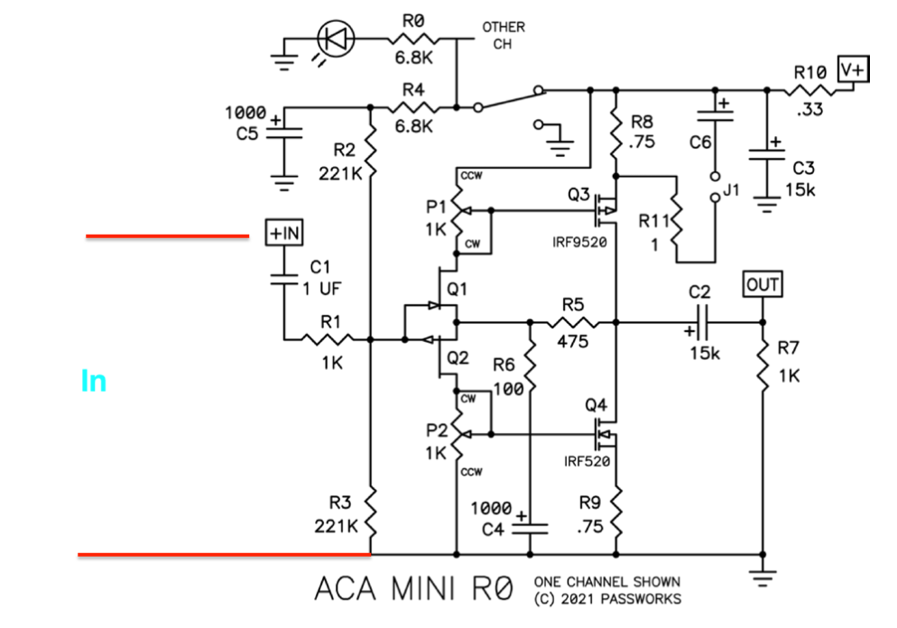

^ Rather than repeat yourself, for clarification, perhaps show an example schematic that you would consider having the inputs grounded.
I cant believe you are being condescending.... Just kidding lol
these are not what are referred to as grounded inputs. But, unless you know something I don't, I am not an expert in electronics by no means.
TRS and XLR are examples are they not? Maybe I said it wrong? Balanced Inputs?^ Rather than repeat yourself, for clarification, perhaps show an example schematic that you would consider having the inputs grounded.
Hence, the D-K comment... a RCA is a 2-pole connector where in almost every implementation in existence, one of the poles is tied to ground.I am not an expert in electronics
@camplo
re: post #95 - "these are not what are referred to as grounded inputs" ^ By whom? I'll bet a US dollar that Jason Stoddard would say they are grounded.
More importantly, what do YOU mean by a grounded input? Clearly there is a gap in terminology to sort out.
"TRS and LXR are examples are they not?" No. TRS and 'XLR' are form factors. They are commonly used in certain ways, but they have nothing to do with a grounding scheme for the input / output.
I believe you are confusing terms. Since this seems to be more between you and TNT, I will bow out.
