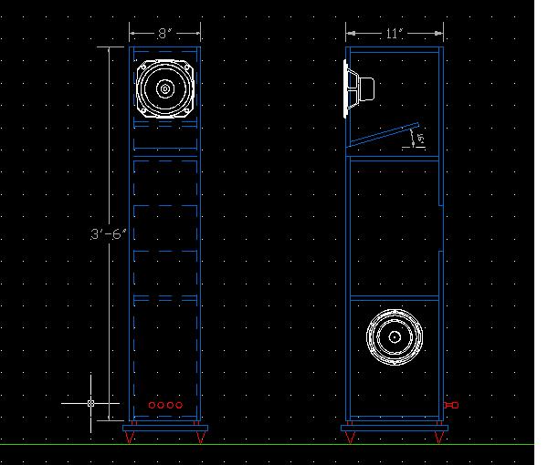

Adjustable Q?
With the amount of space left in this prototype. I was thinking about adding something to adjust the Q for the SDX7. Perhaps shelves that could be slid in and out to reveal another sub chamber to increase the volume. Not sure how to do it, it may require some tricky woodworking skills.
Should I start a separate thread for all of this?, I'm getting close to a prototype build.
See Drawing. O yeah, currently the middle area hiding the BSC and/or networks.

A woofer with an extended range and a similar kind of character really helps when trying to get them to integrate. If you are going to attempt a passive XO, the woofer should be at least 3 dB higher than the FR.
dave

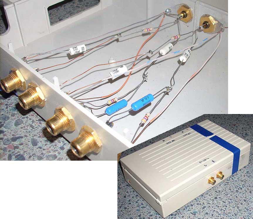

SO my Tysens (FF85kEn + SDX7en) have been relegated to the shed in favour of my FE127 Metronomes due to xover difficulties - I just couldn't get the pllxo to sound good and I couldn't afford a DCX2496.
Soo I went and ordered a MiniDSP.
Four days later postie dropped it off and I plugged it into my CD player, and it sounded terrible. A quick email exchange and - doh - the Myryad CD outputs 2.3Vrms and that's too much (1Vrms max on this version) but running via the Monica3 DAC sounds really not bad. Considering that the signal now has an extra ADC-DAC in the path it's really quite acceptable (Myryad --> Monica3 --> Miniwatt --> +- MiniDSP --> Fe127e Mets) but roll on the SPDIF input. And I can confirm that MiniDSP's support is excellent 🙂.
I've set up Tysen to xover using 4th order LR at 340 Hz which is pretty close to Dave's suggestion but a steeper roll-off. They are in a smallish room (12 x 16) which may have something to do with it. I'm still playing around but these speakers now rock much better than the Mets. Symphonic music (especially Holst's The Planets) is really much more fun.
Is it better than a DCX2496? No idea I'm afraid. Does it do what it says on the box? Absolutely. Am I the best person to judge? Not really, I'm a bit of a noob to all this I'm afraid. But it is a good price and and service is good and they seem like a nice bunch of guys. I'm glad I bought it.
