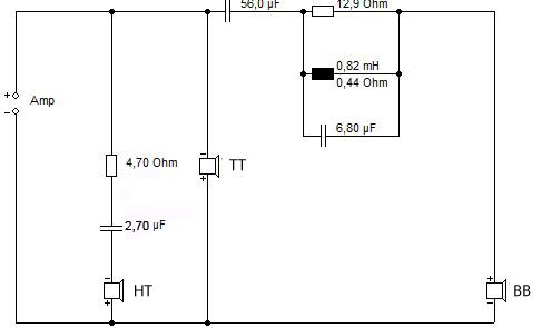

I got a schematic of the passive XO used in the German DIY project, looks really simple. I still plan to try to use the mini dsp and stay active..
Can you post it or give us a link?

as I understand it (the write up is in German and the Google translate is not great)
FR - Fountek FE85
Woofer - Tang Band W5-1138SM
Rear facing tweeter (I think...) Tang Band 13-1761S.

Those are the drivers used in the project I am considering copying..
