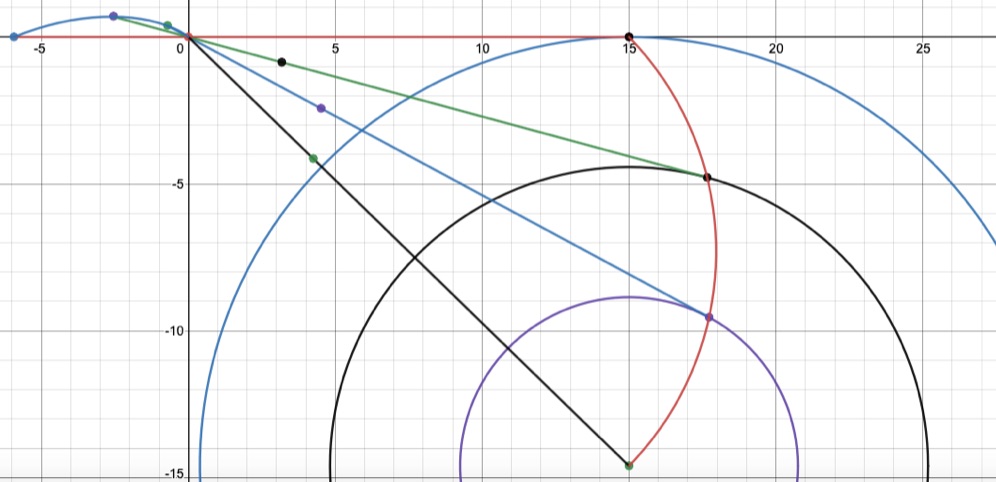

I will assume the DIN maximum recorded LP radius as 14.605 cm and the minimum recorded radius as 5.75 cm. It will not matter if these values are replaced by other standards. The data can be easily changed.
The nominal effective tonearm length is deliberately given a small value, which would lead to excessive lateral tracking error in a conventional tonearm of the same length. The short length will moderate the effective mass in the interest of keeping the usual stylus compliance/effective mass resonant frequency in a desirable range.
For a straight, fixed headshell, zero offset, pivoting tonearm to maintain cartridge stylus tangency to the groove at each position, the tonearm effective (pivot to stylus) length must increase traversing from the outer groove to the inner groove while being allowed to pivot laterally and vertical.. In principle the tangency requirement can extend to the LP centre, but this is usually unnecessary.
Consider the coincident axes vertical and horizontal tonearm pivots located at a fixed location.
There is assumed to be a sliding contact bearing at the fixed pivots location. The tonearm is constrained to not rotate torsionally.
Since the tonearm extends in length over the pivots, there must be sufficient length of tonearm behind the pivot to allow it to extend fully while being supported at the fixed position pivots. For simplicity of illustration it is assumed the total length from front (stylus) to rear is exactly the distance from pivots to LP centre. Since the stylus will only be ending at the inner groove, the tonearm will never be fully extended and is always supported at the pivots.
The equations describing the tangency conditions require at most first year college maths. The coordinates of the paths of each end of the tonearm at tangency can be calculated and plotted exactly.
Assuming the sliding pivots location is fixed at the origin of the diagram below, the tonearm positions at 3 reference locations (outer groove, inner groove, mid-point groove) are indicated.
The effective tonearm length at the outer groove is 15 cm. The rear extension at this position is 5.936 cm, hence the total tonearm length is 20.936 cm. The effective tonearm length can be chosen to be different from 15 cm with little essential change to the description.
The path of the stylus across the LP is a portion of the circumference of the Thales semicircle, diameter the straight line from the tonearm pivots at the origin to the LP centre.
If the tonearm rear end is constrained to follow the required (blue) path and also slide through the origin over the fixed pivots, the stylus must follow the tangential (red) path.
The path of the tonearm rear end is not circular. However the 3 rear end points corresponding to the stylus at outer groove, inner groove and mid point, lie on a unique circle which approximates the rear end path very closely, in the groove playing area.
Also shown on the diagram below are the positions of the initial pivots location on the extended tonearm, at the 3 stylus reference positions. The distance from these points to the corresponding stylus end is always 15 cm.

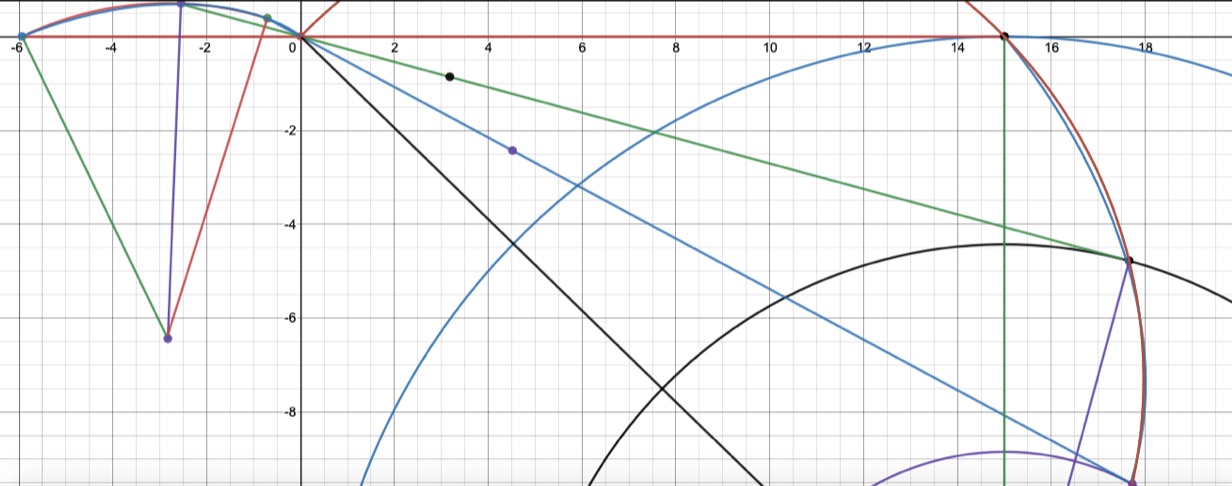

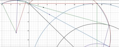

A tangential tracking pivoting tonearm #3
From my previous post, the three rear end tonearm positions corresponding to the stylus reference positions, outer, inner and mid-radius grooves, lie on a unique circle.
The centre of the circle and radius are easily found by chord bisection. Comparing the circle with the tangential tracking rear end path shows close agreement and exact coincidence at the 3 tonearm stylus reference positions. The corresponding stylus path for the circular rear end path is in extremely good agreement with the tangential path. The error is zero at the 3 reference points. Expanded plots of the tangential paths and the circular rear end versions are shown below with the tangential paths and circular paths shown overlaid.
If the tonearm rear followed the precise path (not circular), then the stylus would follow the exact tangential path (red circle). This could be achieved by a servo attached to the rear. However the additional complication over a passive linkage does not seem worthwhile for the additional accuracy. Especially considering the tolerances of cartridge cantilever alignment with the cartridge body or generator.

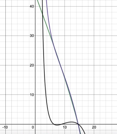

A tangential tracking pivoting tonearm #4
From my previous post, when the tonearm rear end is constrained to follow the circular path as shown, the stylus path will follow closely the tangential path.
This is accomplished by a pivoting strut connecting the rear circle centre to the tonearm rear stub. The physical requirements are very low friction for all pivots and the sliding bearing at the tonearm pivot.

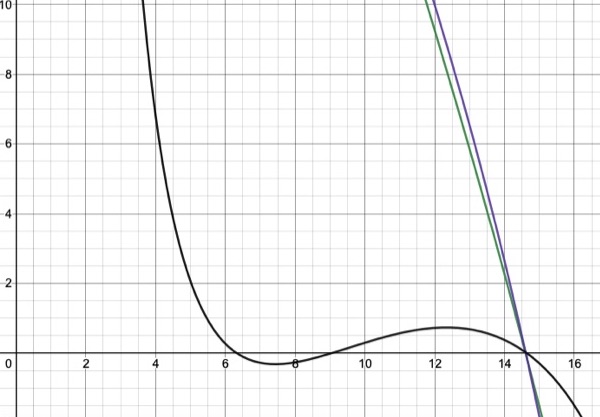

The calculated tonearm lateral angle referenced to the outer groove position, shows excellent agreement with the tangential tracking alignment. Below is the calculated tonearm angle (in degrees) as a function of the stylus radial distance from the LP centre. The tracking error over across the groove area is the difference between the two lateral angle plots. The plots show zero error at the inner, outer grooves and central grooves, a maximum error of approximately 0.75 degrees and tracking error less than 0.5 degrees over 50% of the groove radius. The zero crossings at the three reference radii are off by a few mm due to truncation and rounding errors in the graphical software. All the plots are implemented by inputting the complete algebraic expressions with no approximation, as is often the case for the tracking error analysis of conventional offset pivoted tonearms.
It is especially interesting that the tracking error at the inner grooves approaches zero, as this is where resolution is lost due to other well known factors.
Tangential tonearm angle (green), approximate tonearm angle (mauve), tracking angle error (black). Horizontal axis, stylus radial distance from centre.
From the tracking angle error plot, we should expect zero stylus side force at the three reference radii. In other words, they are equilibrium points.
