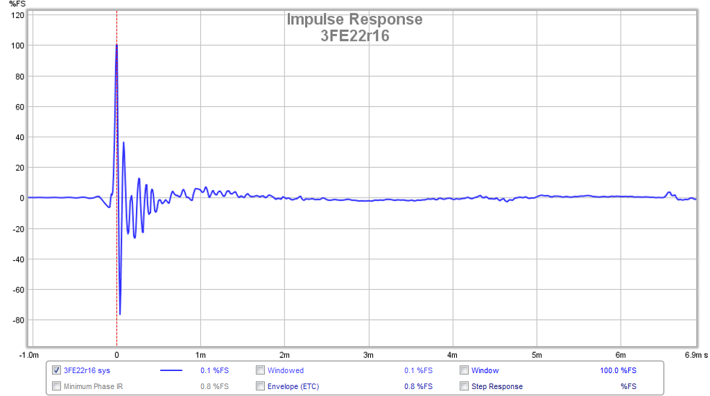

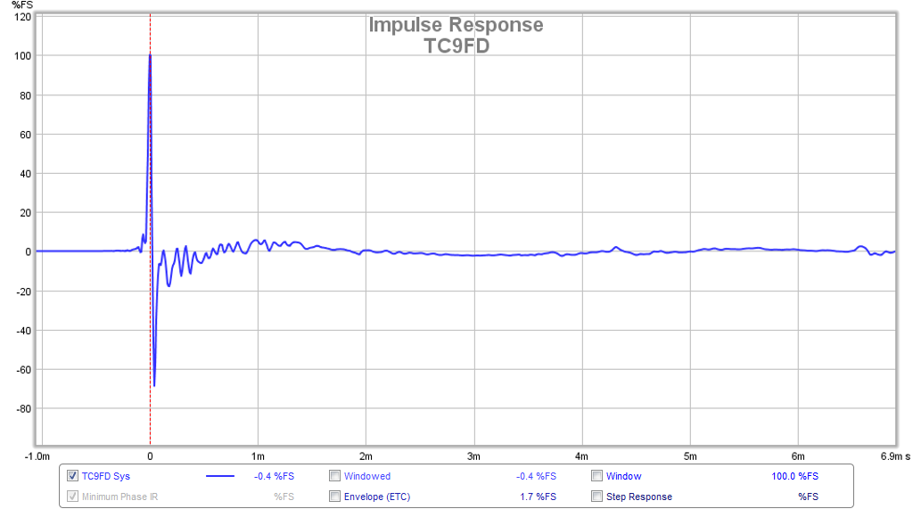

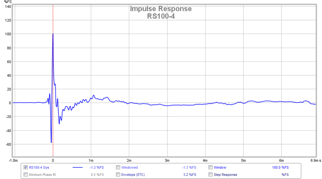

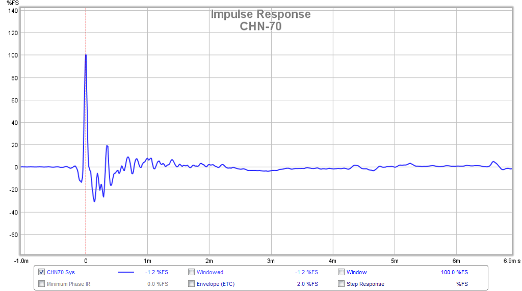

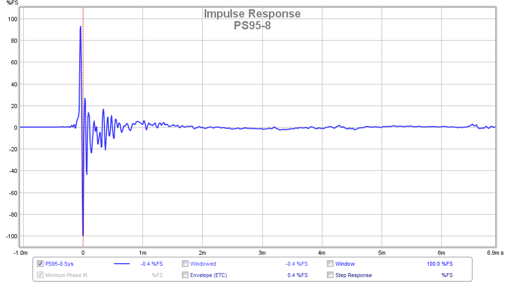

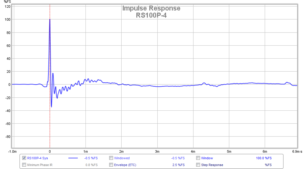

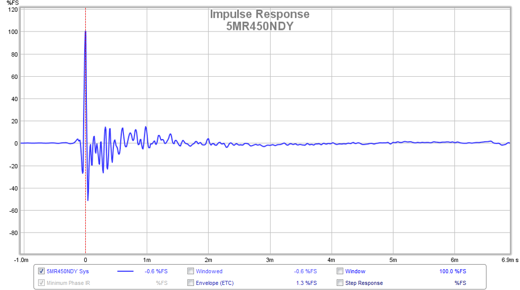

Impulse Response for all Drivers
Impulse response from measurement at about 10 deg off axis and 0.5m distance:
A - 5MR450NDY:
470462d1425862117-subjective-blind-comparison-3in-5in-full-range-drivers-5mr450ndy-fast-ir.png
B - TC9FD:
470463d1425862117-subjective-blind-comparison-3in-5in-full-range-drivers-tc9fd-fast-ir.png
C- PS95-8:
470464d1425862117-subjective-blind-comparison-3in-5in-full-range-drivers-ps95-8-fast-ir.png
D - 3FE22r16:
470465d1425862117-subjective-blind-comparison-3in-5in-full-range-drivers-3fe22r16-fast-ir.png
E - RS100P-4:
470466d1425862117-subjective-blind-comparison-3in-5in-full-range-drivers-rs100p-4-fast-ir.png
F - MA CHN-70:
470467d1425862117-subjective-blind-comparison-3in-5in-full-range-drivers-chn-70-fast-ir.png
G - RS100-4:
470468d1425862117-subjective-blind-comparison-3in-5in-full-range-drivers-rs100-4-fast-ir.png

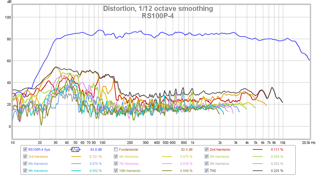

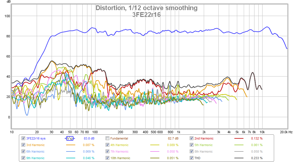

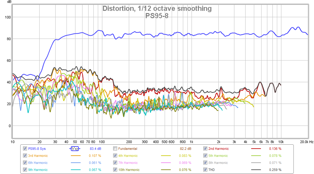

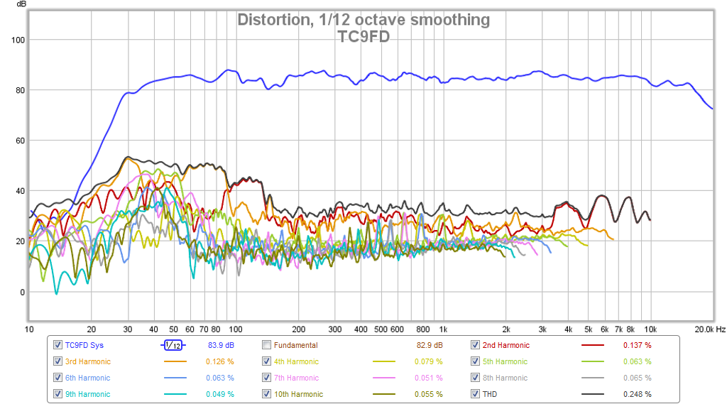

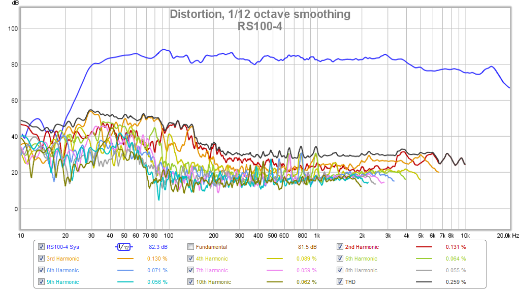

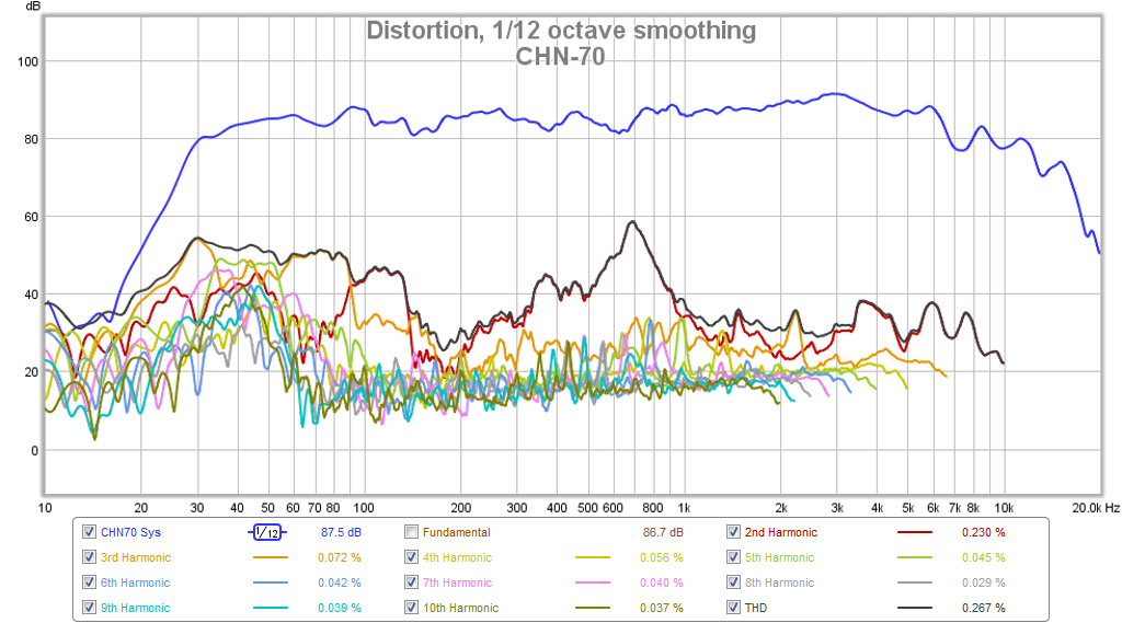

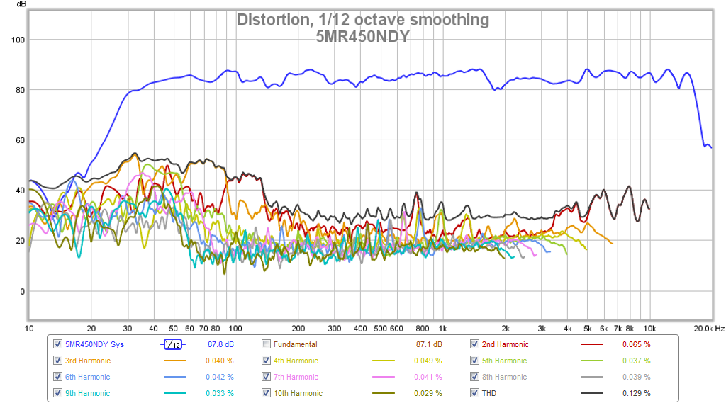

Harmonic Distortion of All Drivers
I admit this is not all that useful from an absolute harmonic distortion standpoint as the drive levels are low. It is good for relative comparison though. Drive level is about 0.7 volts rms and mic is at 0.5m. For the very sensitivie 5MR450NDY, the drive level was attenuated below 0.7 volts in order to level match the rest of the drivers which were all around 84 to 86dB.
470469d1425862576-subjective-blind-comparison-3in-5in-full-range-drivers-5mr450ndy-fast-hd.png
470470d1425862576-subjective-blind-comparison-3in-5in-full-range-drivers-tc9fd-fast-hd.png
470471d1425862576-subjective-blind-comparison-3in-5in-full-range-drivers-ps95-8-fast-hd.png
470472d1425862576-subjective-blind-comparison-3in-5in-full-range-drivers-3fe22r16-fast-hd.png
470473d1425862576-subjective-blind-comparison-3in-5in-full-range-drivers-rs100p-4-fast-hd.png
470474d1425862576-subjective-blind-comparison-3in-5in-full-range-drivers-chn-70-fast-hd.png
470475d1425862576-subjective-blind-comparison-3in-5in-full-range-drivers-rs100-4-fast-hd.png

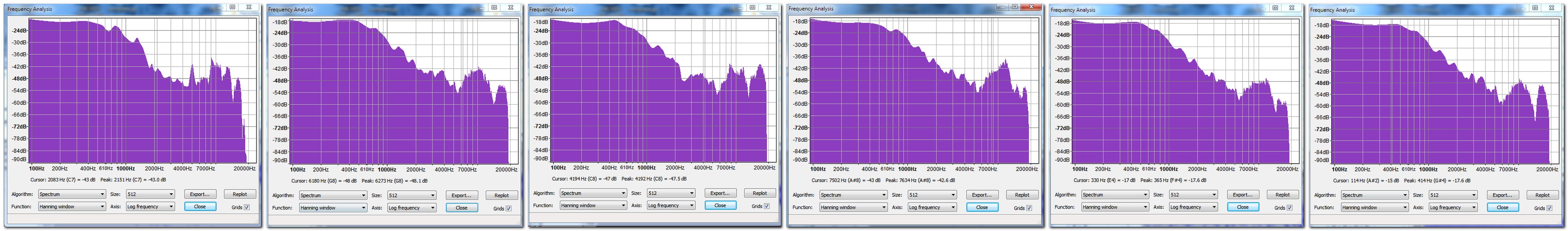

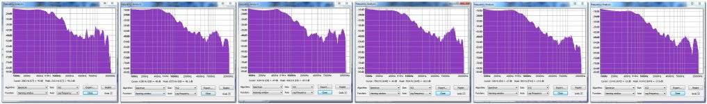

I tried to use the Norah Jones track, but that was probably the worse one to pick due to the constant HF shimmer that sounded like noise. i had to go back and listen to the original recording and decided the worse speaker would tone it down some. so by the OP rules of the game, the A test was flawed to make it "more pleasing" to these ears. I'm a fan and very familiar with Norahs voice and any other song would of been my go to reference.
so i spent most of the time listening to the jazz track. I easily ruled out 2 or 3 recordings and in the end no clear favorite emerged. so i threw up my hands and ran a spectrum analysis of track 3. i still couldn't decide from the data there!
data from track 3 in order A-G left to right.
