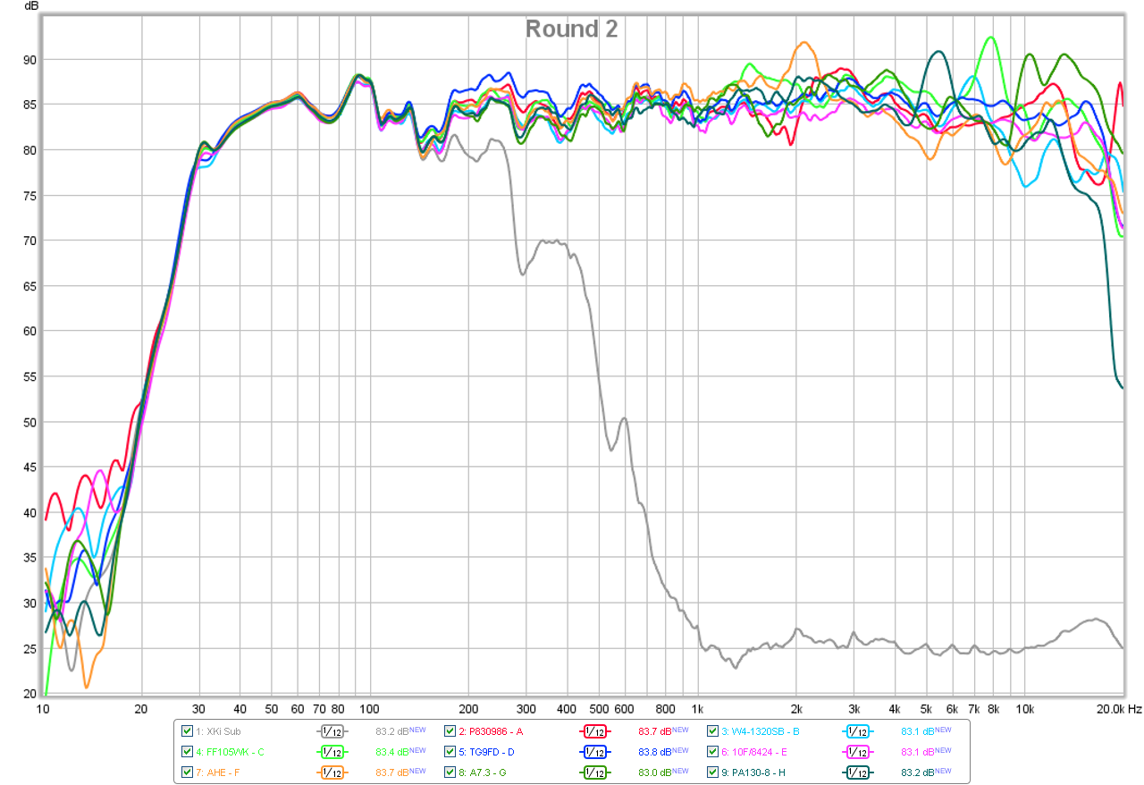

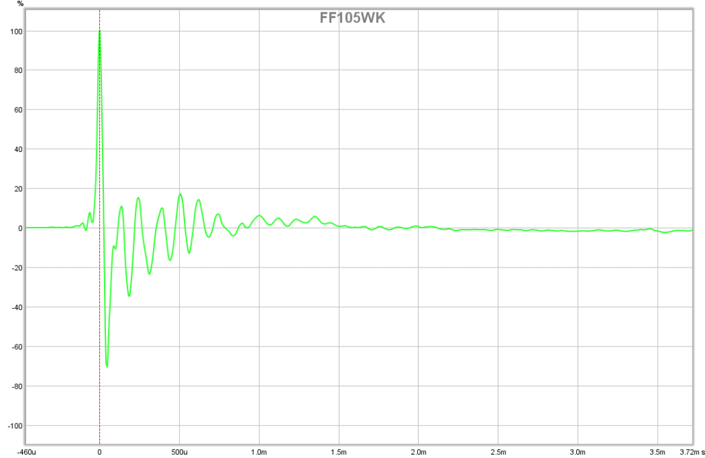

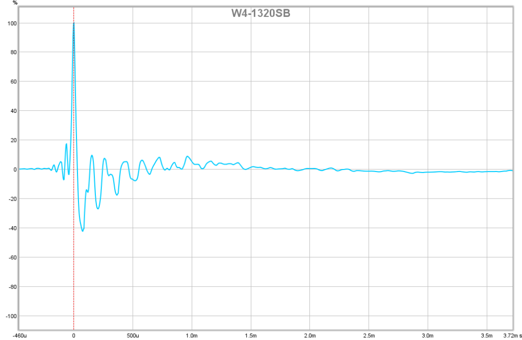

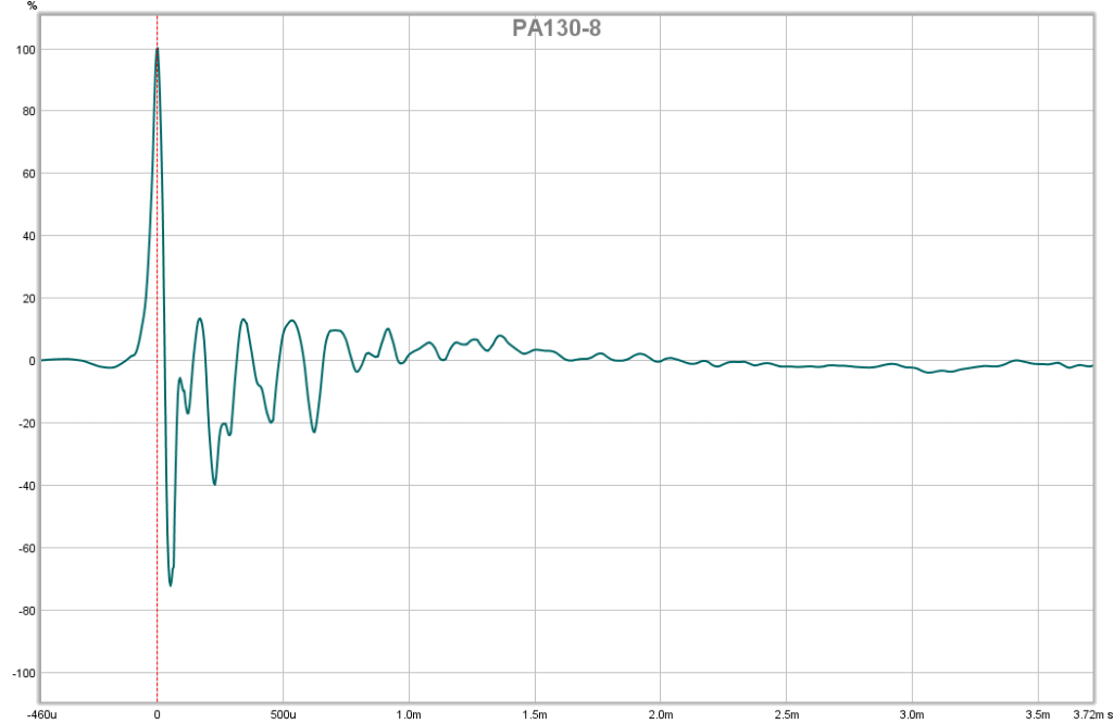

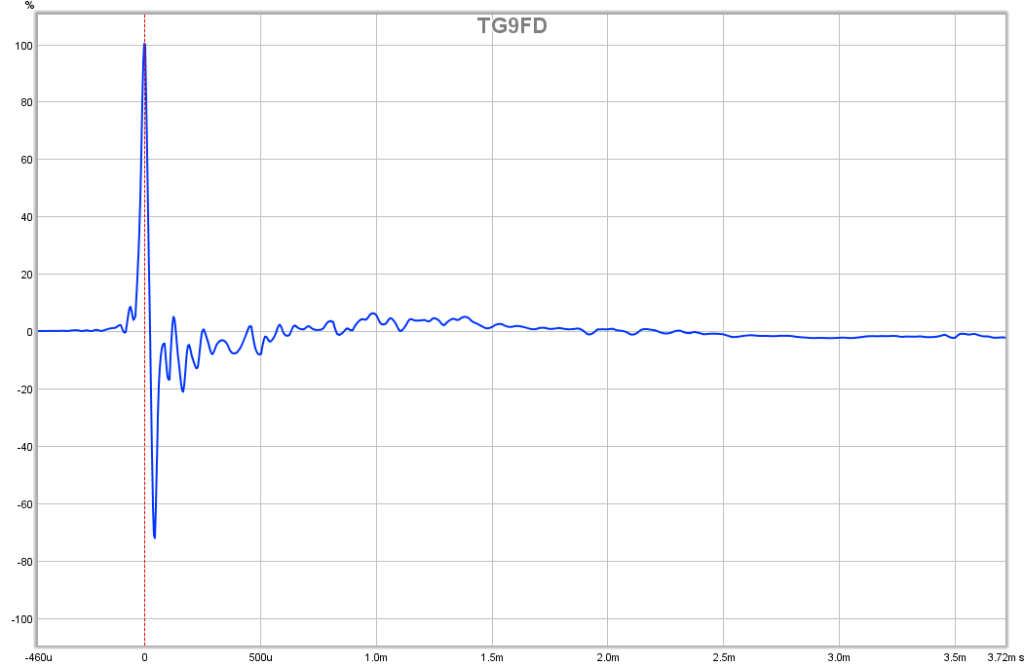

Frequency Response in FAST:

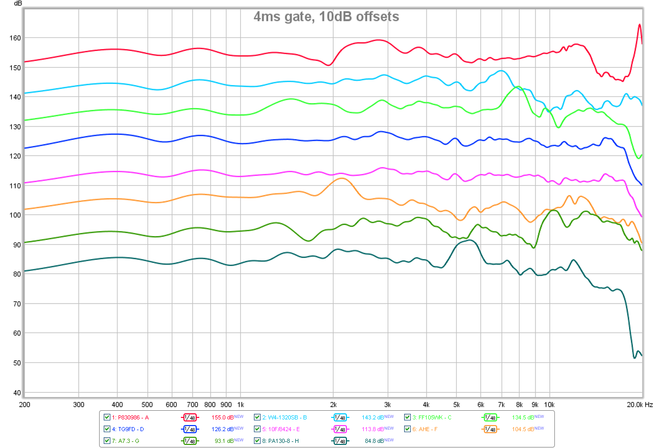

Frequency Response with 4ms gate at 1/48th oct avg and 10dB shift for clarity:

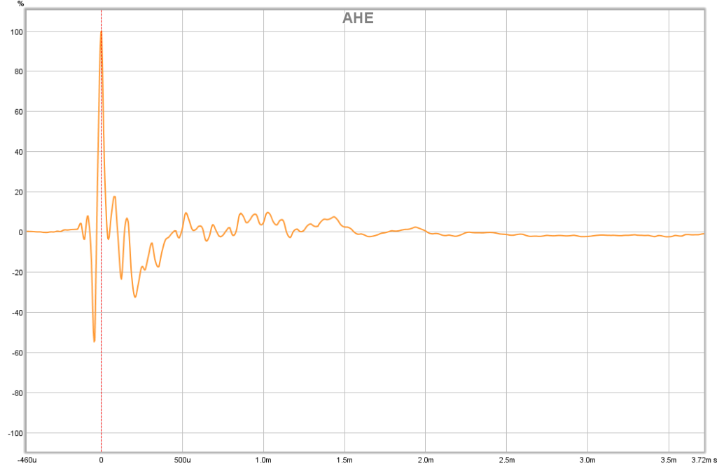

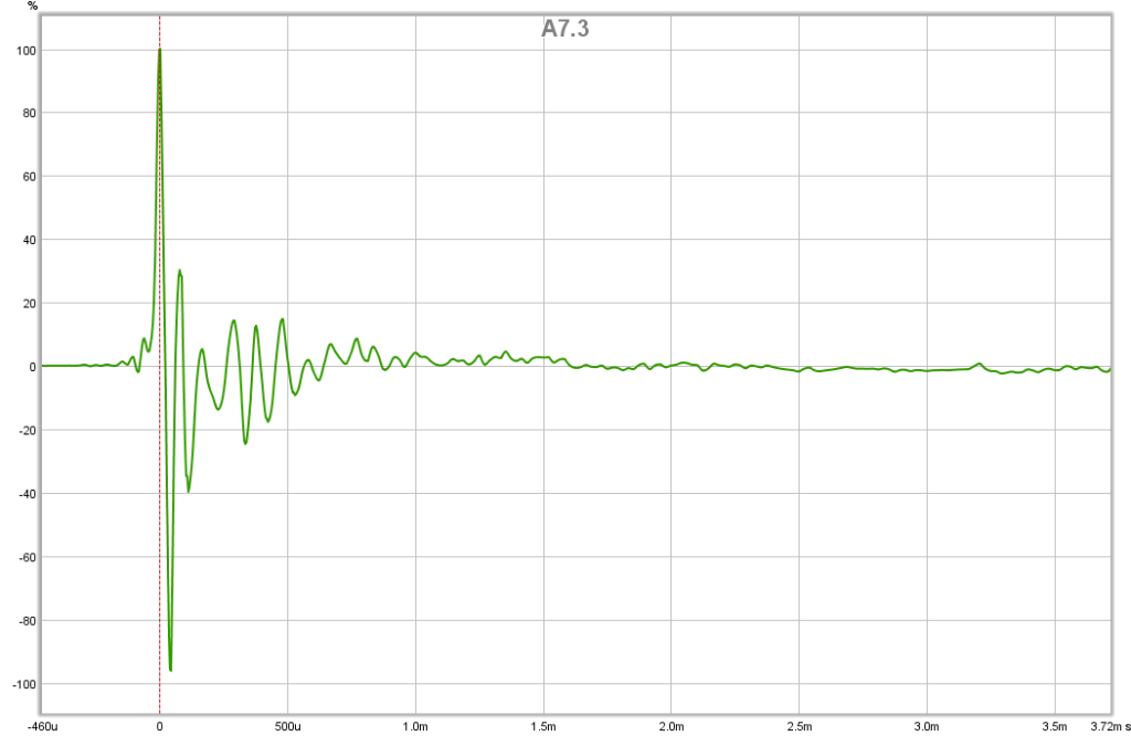

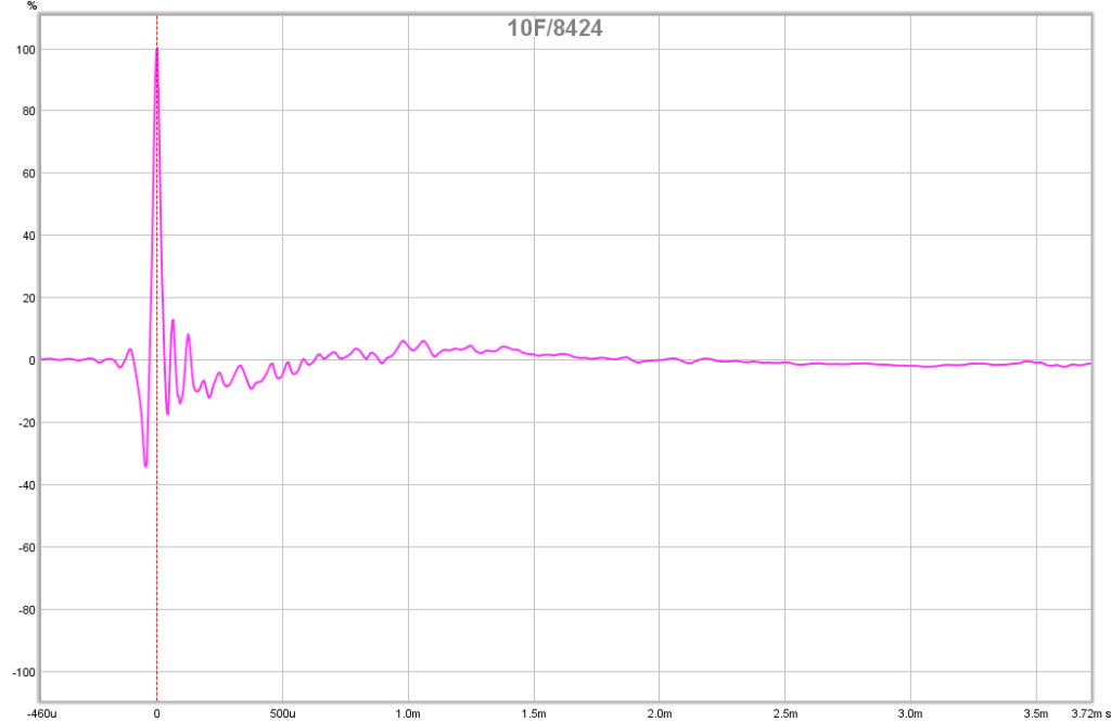

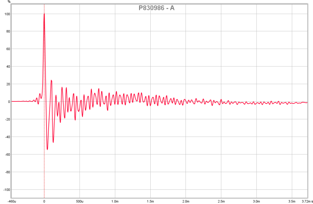

And Impulse Response for all:

It was close for me as well. In the end I chose the one that sounded best across a number of different systems I have set up around the house, but there were a number of different speakers that had qualities that I enjoyed. In the end I think it was the more even performance across the high frequencies (through my multiple systems) that was the deciding factor for me.15 minutes to go, can't wait! 50 votes in right now. Last chance!
Closed! Okay X, let's go... for me this was a much closer round than the first one...
Wow, D and E are almost parallel lines and yet most people went with E. Interesting.
Almost twins, those two in frequency response. The flattest FR plus cleanest impulse won this round. It was my preference as well.
Still I think some influencing of the votes was happening due to the detailed responses of some of the voters. A and G went fast in the lead at first...
For me personally the sweetest midrange won me over to choose E. D was very close in character. No doubt these are close relatives, yet a tiny bit different.
I could hear the attraction of A, and less so in G. But that type of sound is not my thing. It does seem to sound more detailed, but is it really?

Awesome! Yes D and E have same frequency response so it will be interesting figuring why one was preferred and what manufacturing/build difference created the improvement?
I'm glad the TB1320 showed a recessed treble response because that's what I hear (and use a tweeter with this driver).
The PA130 also showed a recessed treble but subjectively, to me, has more treble than the TB1320. The peak at 5K must be influencing me. I also wonder if the PA130 was nixed because it came after a driver that measures very differently?

As long as the by product is a ringing impulse it is not convincing me that the cone material is the reason for the detail that is heard.
At least with the 10F I'd know the detail I hear is actually in the music 😉.
The ringing will influence the sound. A test could be to low pass the aluminium coned speaker and listen for detail. Do the same on the 10F and compare.
