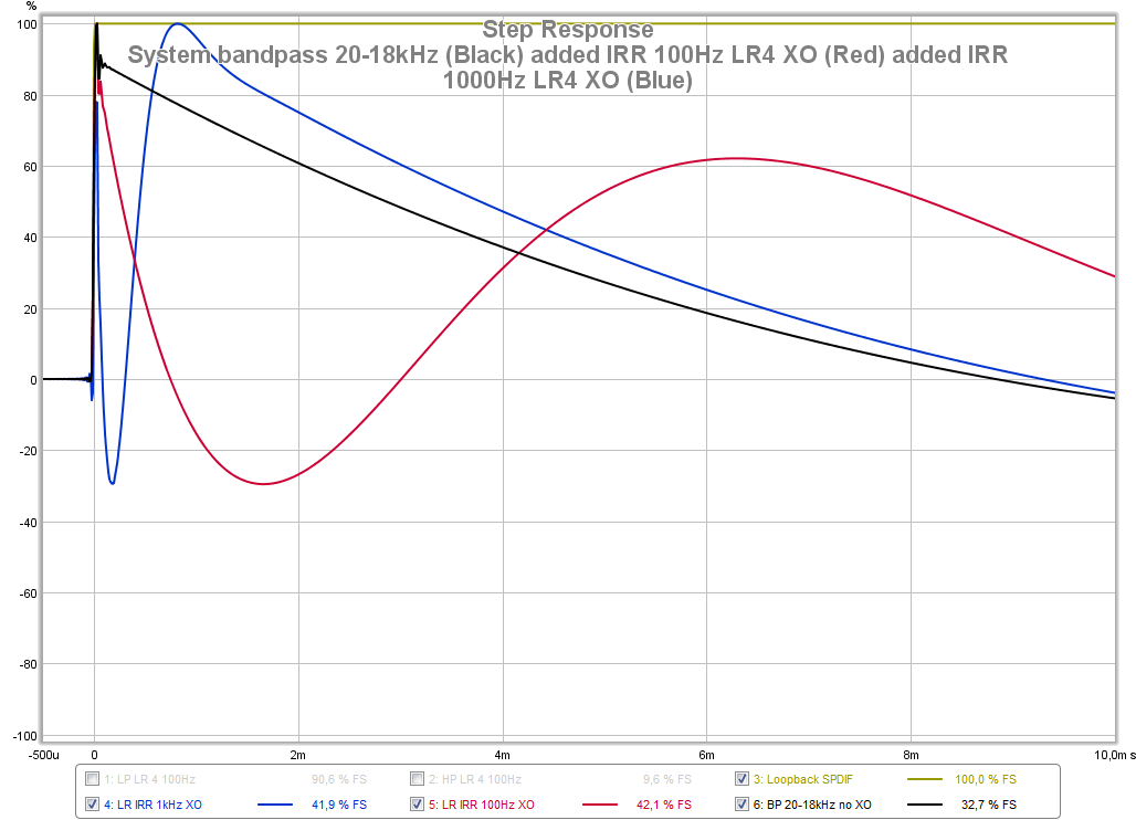

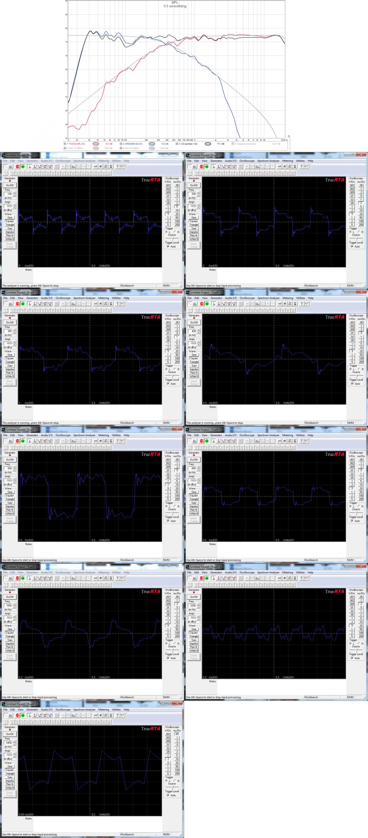

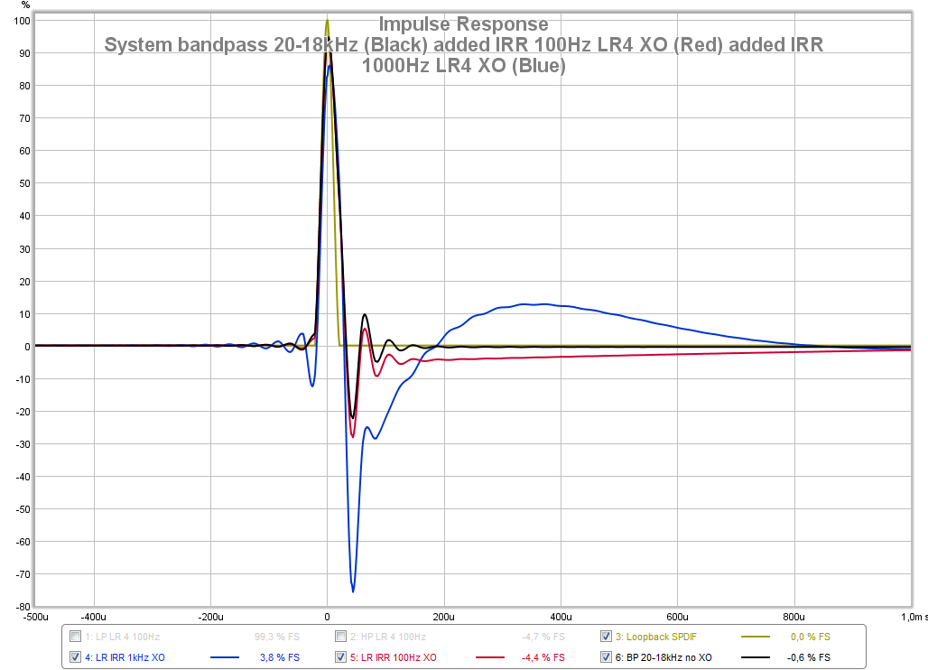

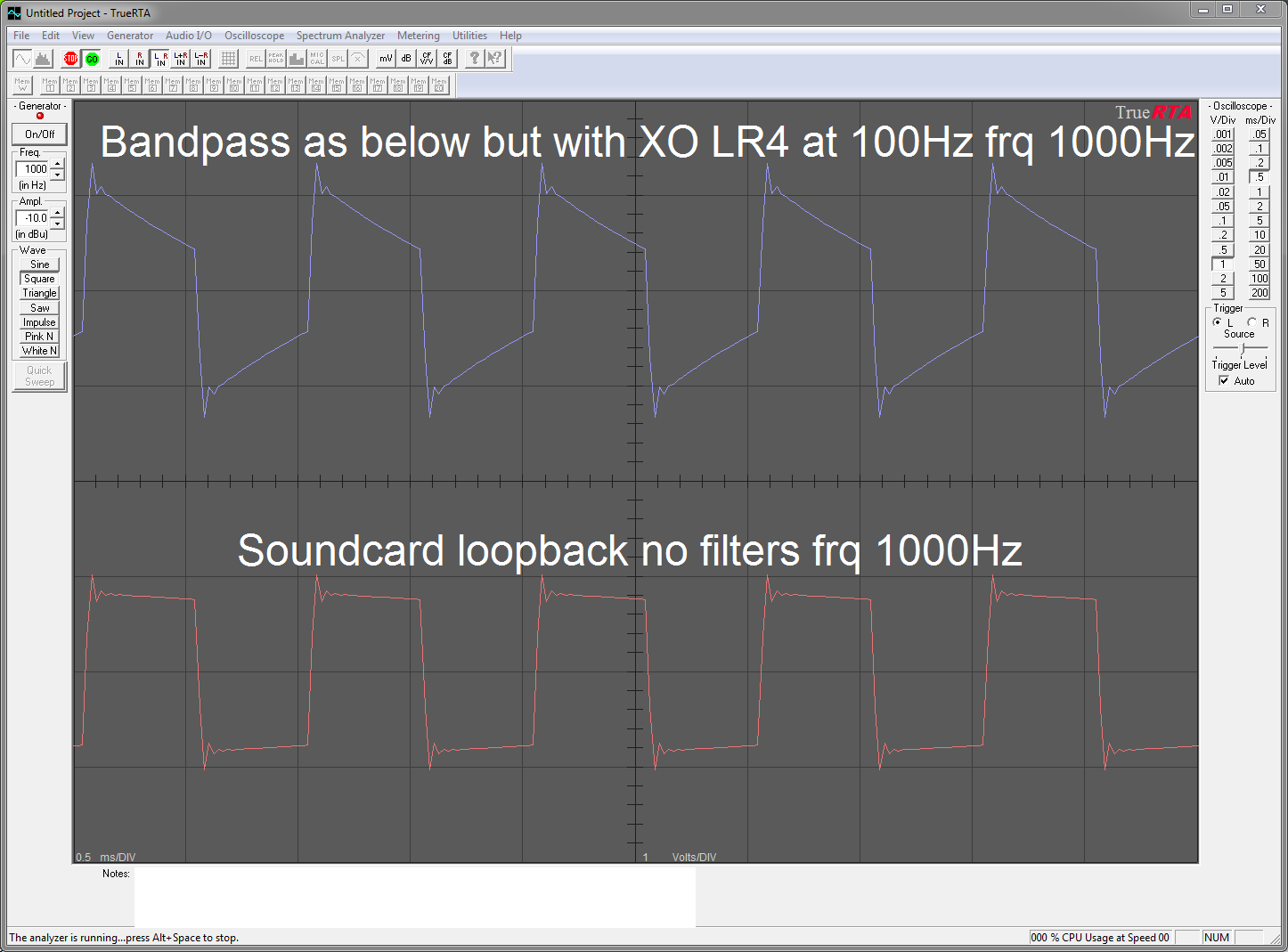

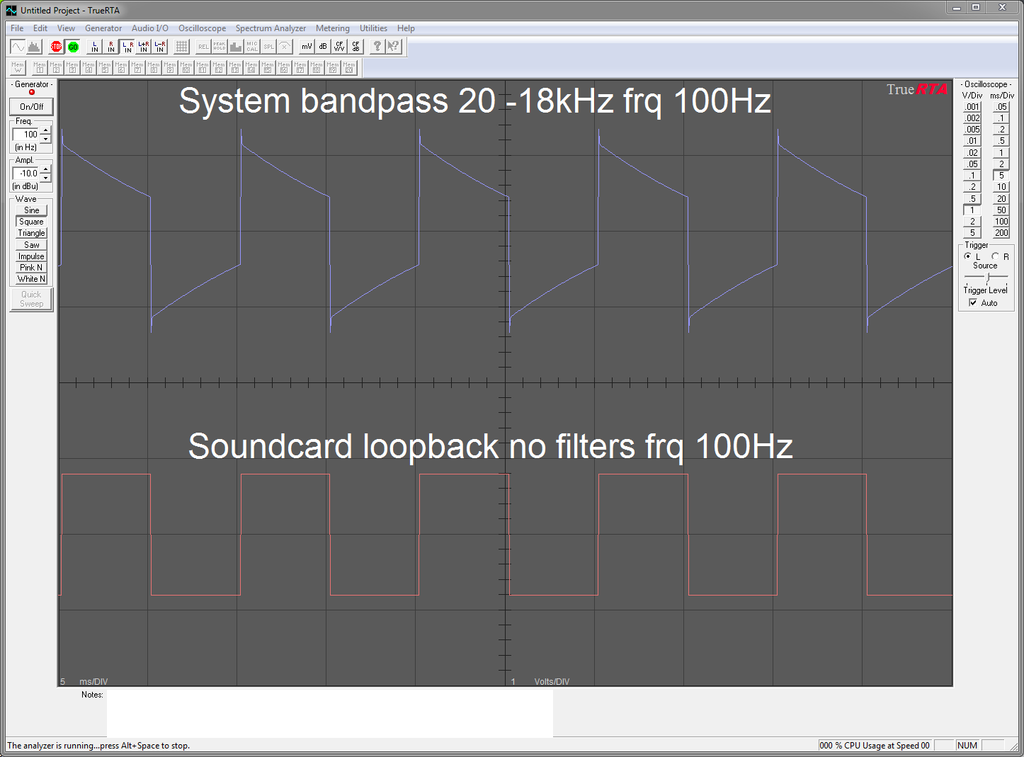

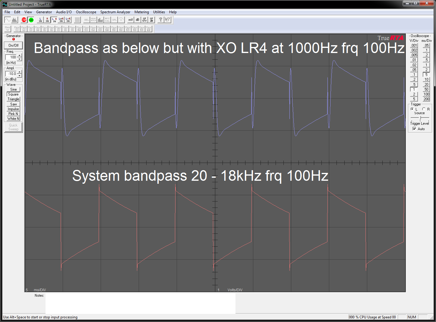

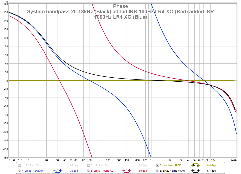

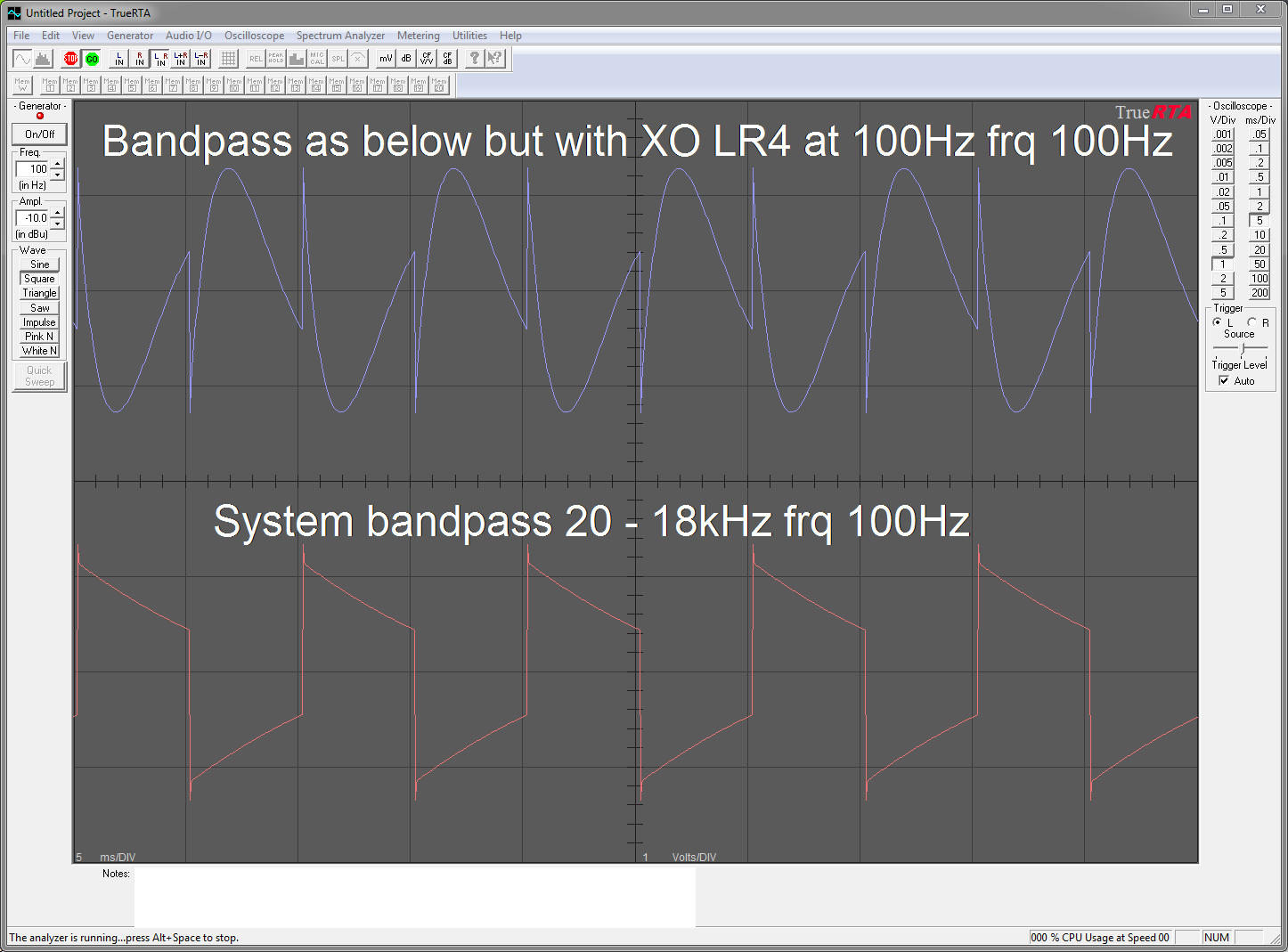

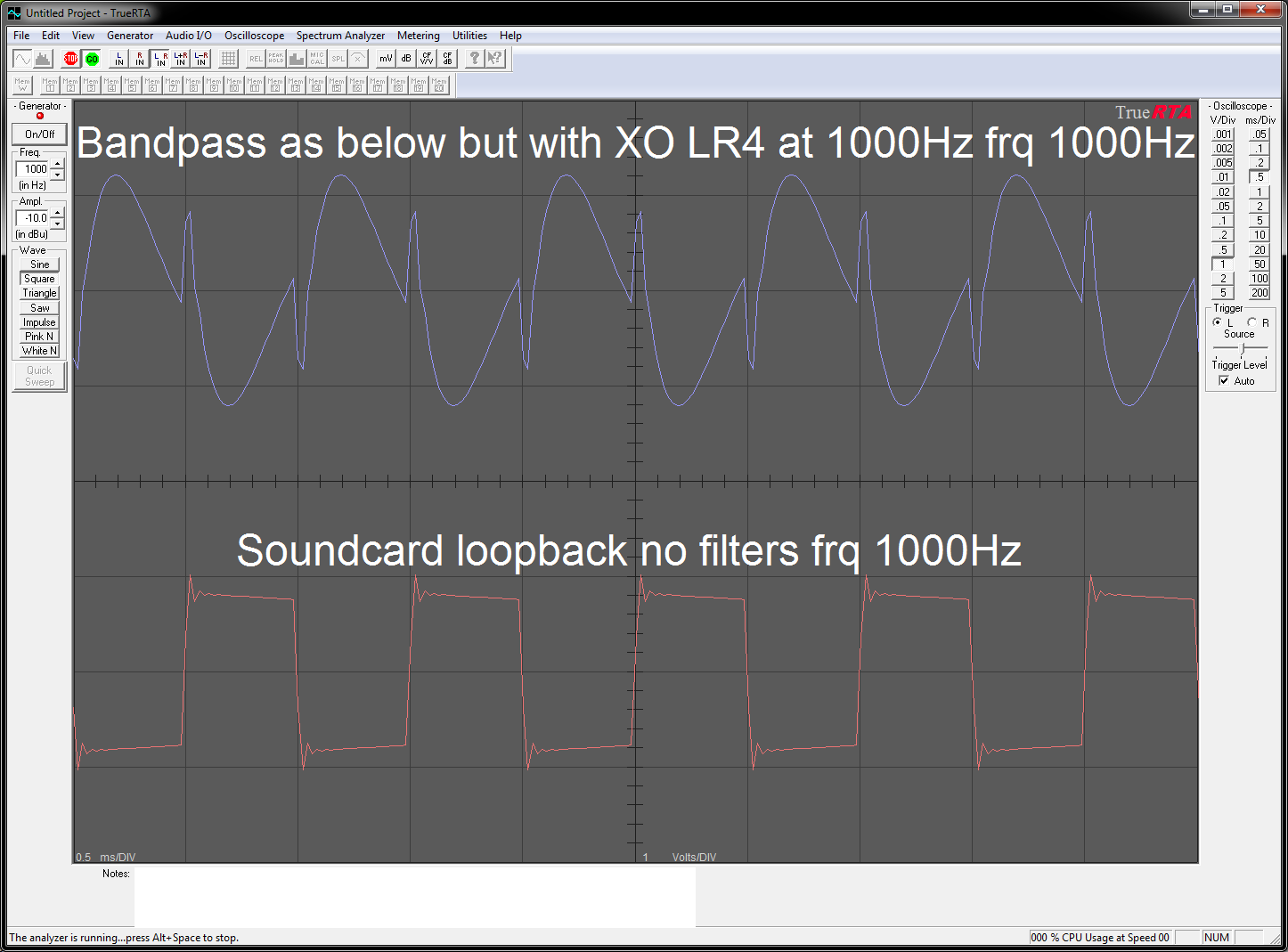

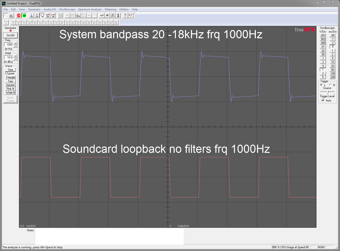

My exercises for XO points for FAST system being higher than 400Hz had a turn when i tried FIR filters for second and fourth order filters that was amazing. My 10F8424/SPH-250KE minimum phase plot now looks like one full ranger driver with a system bandpass 50-18kHz and XO is upped to 500Hz LR4 (link http://www.diyaudio.com/forums/full...3in-5in-drivers-round-2-a-46.html#post4397112). In reality drivers have IRR LR4 electric XO and are EQed relative flat also outside their pass band to get the electric LR4 XO slopes replicate in acoustic domain, delay to align acoustic center, and a FIR filter that neutralize 360º phase turn cause by IRR XO slopes.
In past it had been said those phase turn is not audiable, well yesterday made two new FIR filters that replicate a IRR LR4 XO phaseturn at 100Hz often used in reality for a sub and a 1000Hz one too. Then ticked them on and off on the fly when listening to these small Edirol full ranger monitors (link http://www.diyaudio.com/forums/multi-way/277691-s-harsch-xo-4.html#post4407466) and think its a night and day difference for instruments attack and realness. Request if any want the IR.wav filters for testing themselves, they will work in JRiver and Foobar audio players DSP engine. Turn them on and a full ranger will have IRR minimum phase XO phase turn added as it was a two way speaker.
Barleywater share some nice data here http://www.diyaudio.com/forums/full-range/276349-fast-tc9fd-dsp-performace-testing-platform.html with very steep XO slopes, low Q system highpass, recommendation for less than quarter wave ctc spacing at XO point, higher XO points and distortion analyzes.
Add some step and square wave response below which think tells a lot about IRR XO and transients. The minimum phase system bandpass examples 20-18kHz could actual replicate as wesayso's line arrays will perform by itself as a IRR minimum phase system (link http://www.diyaudio.com/forums/full...er-full-range-line-array-127.html#post4391729).

Those are very nice results. Are the square waves actual mic measurements of your 10F/SPH250 system or sound card "experiments" via loopback?
Byrtt,
🙂 no would then be very happy its loops from soundcard but real electric ones, but as you probably can see i have dig my old PCI AP192 up from drawer which has 4x4 I/O 2 of them being SPDIF and looping SPDIF it will loop from DC to 192kHz sample rate limit (see nice clean cut IR/SR gold traces on REW plots) where by analog I/O its limited by analog capacitor filters. But okay both these two used programs can't use the HF bandwith, think REW is limited to 16bit/48kHz will then probably have to look at ARTA for more resolution at HF.
Its to put visuals on transients response and the realness of instrument this gives also you express hearing with better transient XO types and which is actual possible with full rangers example wesayso's line arrays without any FIR filters. As said yesterday i did the test on simple full range monitors with LR4 100Hz and 1000Hz FIR phase turn mirror and was little shocked because one driver with only one voice coil should have no problems as real multi ways with acoustic center errors, ctc spacing problems with vertical lobe and uneven off axis response between LF and HF driver at XO point, but both filters was very audio able.
Real measurements with mic mostly i get results as below which was before 10F with a TC9FD and the more hope than reality XO type BW1 slope. Think need to study those IRR kirkeby filters that is possible responsible Barleywaters stunning smooth plots, but then again he also told us how hard it is to get acoustic perfect square waves in room except at a single spot in space.
