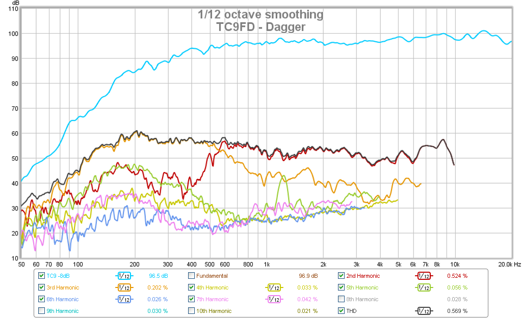

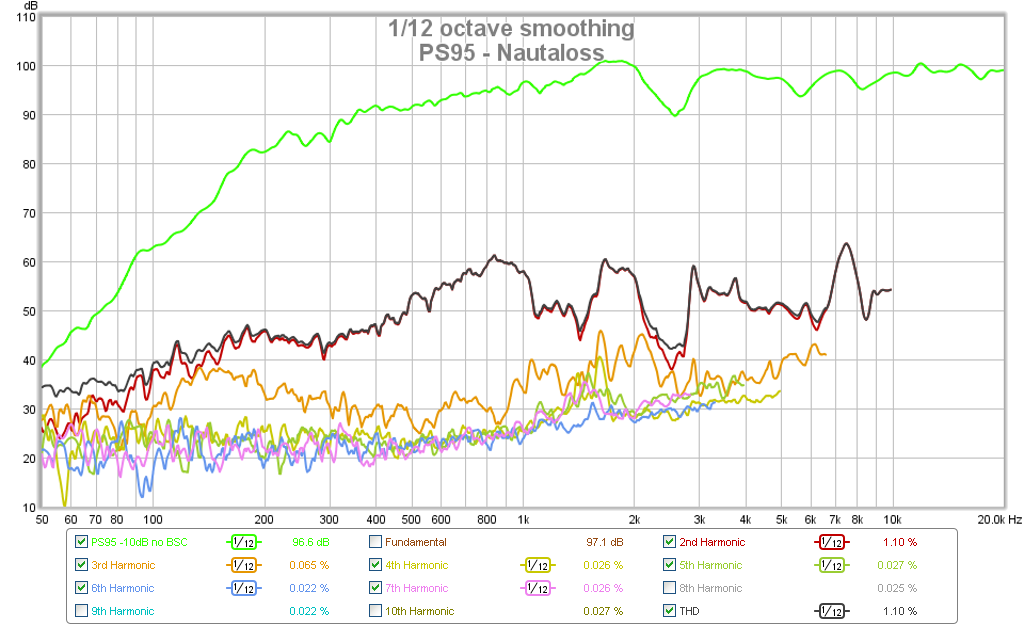

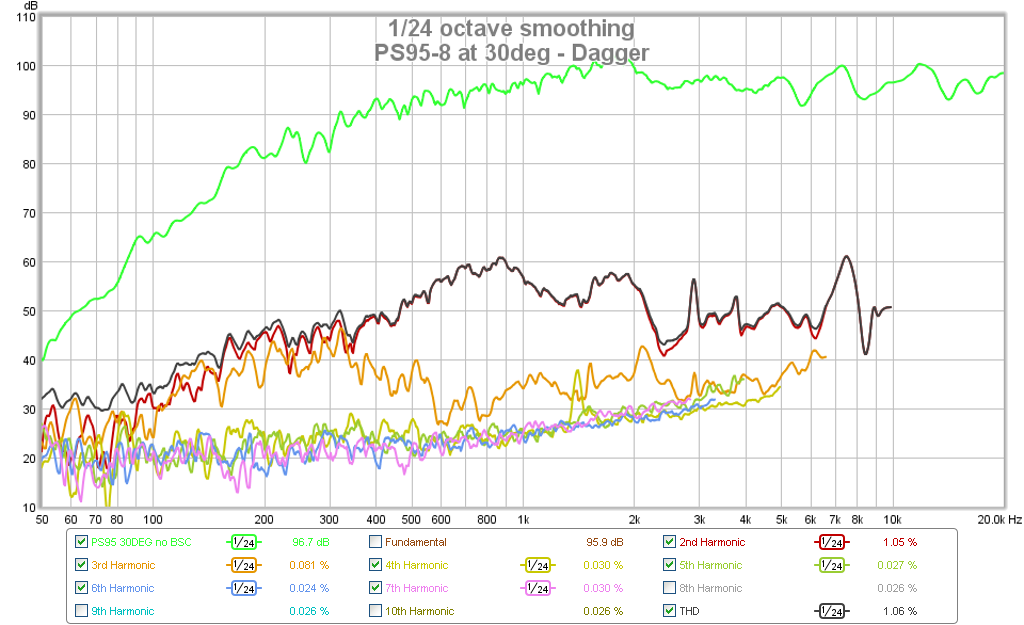

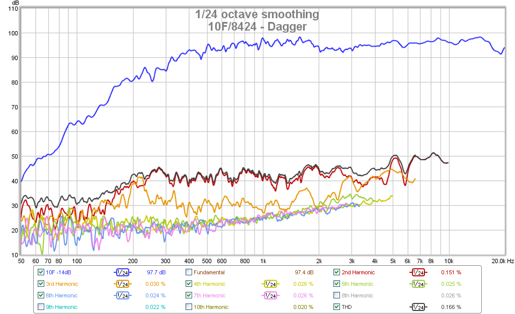

I retook the HD data for the 10F, TG9, TC9, B80, PS95 more carefully and in two cabinets: the Dagger and the Nautaloss (larger volume circa 5 liters).
I found out that I had a mistake in my previous HD measurements of the 10F, the mic calibration for SPL level was off about 2dB (too high) so the HD will be too low. My fault for trying to take data at the end of long day and rushing. Anyhow, the HD data for the 10F in the Dagger is still very good, 0.266% THD at 1kHz at 96dB and 0.5m or 90dB at 1m equivalent. What is interesting is that the HD for the TC9 and TG9 is quite a bit higher (about 0.7% for both at 1kHz) but what troubled me was that it started rising below 1kHz. This suggested that the Dagger volume, as many of you suspected, was too small for these higher Qts drivers to have breathing space. I put the drivers in the Nautaloss and retook the data. The THD for the TC9 and TG9 below 1kHz went down significantly, but the THD at 1kHz increased to about 1%. The THD for the 10F also increased to 0.58% (from 0.266%) at 1kHz and everywhere else a little more too. So this says that the Dagger is really well suited to the 10F because I cannot get the HD to decrease any more, and in fact, rises in the Nautaloss. It also says that rear chamber design can make a huge difference in the harmonic distortion. So it is not surprising that Jeshi's measurements show a higher level and distribution of the different components of HD in her EVA cabinet vs my Dagger. I will post the HD plots later - waiting for large REW file to transfer from DAQ pc to workstation for processing and viewing. The B80 exhibits lower HD than the TG9 or TC9 but is not as clean as the 10F. The PS95 had the least clean looking HD plots when driven under stress levels. All data is compared for equivalent of 90dB at 1m, I varied drive voltage to achieve this. The 10F is super efficient, so much less drive is required. This is perhaps why its distortion is so low - the cone doesn't move much. The sensitivity difference would appear to be higher than the manufacturer's spec of 86.6dB at 2.83v.
Oh, and speaking of actual drive voltage - I tried to measure that quantitatively but realize my DMM's are old and plain inaccurate. I have two and the readings differ and it depends on what you measure, a 1kHz sine, white noise, pink noise? I use the generator function in REW. At any rate, I just ordered a new Fluke DMM, no messing around with cheap meters anymore. May take a while to get it. The DMM's I used showed 3.7 vac and 3.52 vac for -14db setting with pink noise. But show 4.74 vac and 4.3 vac for 1kHz sine wave. So what is the drive voltage? I wish I kept my O-scope, sold that many years ago.
More data plots to come - just wanted to let you all to know what is coming.

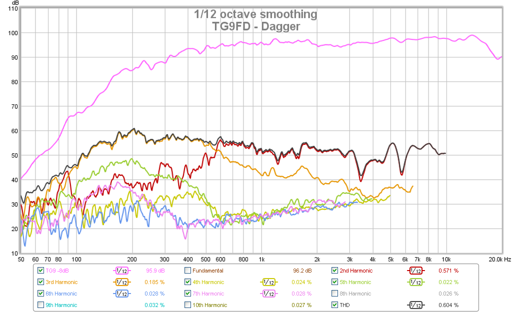

The different cabinets are showing that the elevated HD for the TC9 and TG9 in the Dagger, may have not given those drivers an even chance against the 10F and B80. They are higher in distortion no matter what though as to be expected for the price differential.
The 10F is about 4 to 6 dB more sensitive than the TC9 and TG9, respectively. It has about 3x lower HD at 1kHz when stressed to equivalent 90dB SPL at 1m, so is noticeably cleaner sounding. Those two things alone, in my opinion, justifies its 5x higher price tag vs the TG9. But can you hear a difference between those levels of HD? Probably yes because they are not flat and uniform in distribution like the 10F.

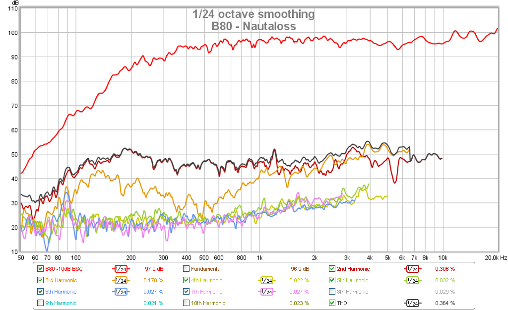

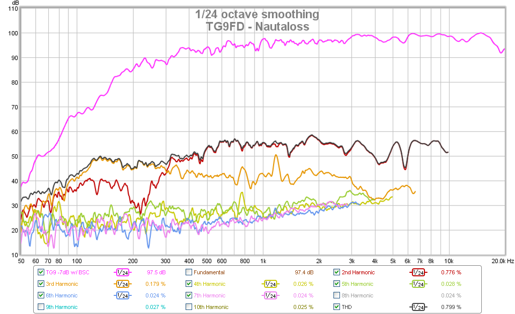

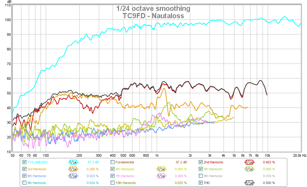

HD measurements in Dagger and Nautaloss
Here are the plots. All at 0.5m, varied drive levels until nominal 96dB was measured at 1kHz - equivalent to 90dB at 1m. The drive levels are listed in the legend as dB full scale in REW's generator. I will provide correlation of drive voltage in volts when I get a good DMM. For now, -14dB corresponds to the two different DMM's I have listed in previous post, they don't agree and the measurement is difficult without an O-scope.
10F in Dagger:

TG9 in Dagger:
TG9 in Nautaloss:
TC9 in Dagger:
TC9 in Nautaloss:
B80 in Nautaloss:
PS95 in Dagger:
PS95 in Nautaloss:
With 1.1L, all drivers are underdamped, but 10F benefits the most in term of distortion because this driver requires less volume than the other drivers. After 10F, TG9 and B80 both requires almost same volume, then TC9 which require the biggest volume....
If you increase the volume to 5-8L, 10F becomes overdamped and TG9 and B80 will benefit the most...
But with higher volume, it is fair to all drivers that all are overdamped, than using small volume such as 1.1L.
But don't forget that there is always trade off between distortion and bass "impact". Being slightly underdamped in 1.1L, TG9 appeared to have high distortion BUT very good bass "impact". If you think that the increase in distortion is still way below your threshold then it is better to have the extra bass "impact"...

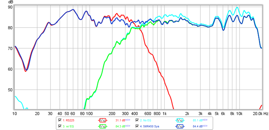

Eldam was wondering what the 5MR450NDY sounds like with the latest setup. Here it is with the 350Hz Harsch XO and mounted in the Nautaloss with RS225 woofer for bass. Same sound clips as Round 4. There is a BSC applied to flatten the rising response.
Here is the XO response, the sound clips are of the non-EQ'd response (light blue):
It may sound a bit bright. Let me know if you are interested in the other set of clips with just two gentle PEQ's applied.

Thanks sharing it takes 5 seconds to hear why didn't make it to the finale round with out of box frq response low distortion driver or not, think will need to have frq response somehow tweaked a lot to be more natural sounding.

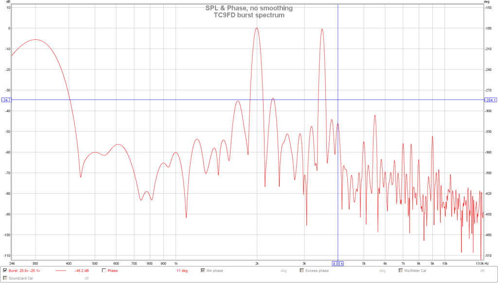

HD by itself doesn't matter at these levels. 1kHz mixed with 2kHz at -46dB is indistinguishable from pure tone. Adding in additional harmonics at correspondingly tiny levels makes no change.
IMD is whole other story. Here is another view of burst frequency response plot from my FAST TC9FD thread:
As seen, it has 300Hz, 2kHz, and 3.5kHz components. Voltage peaks of burst signal are 28.9 and -26.1 volts. This asks much more from driver than X's levels used for HD plots. Cursor in this view is at 4kHz with peak -46.2dB to 2kHz peak. Excluding fundamentals, two largest peaks are 1.7kHz at -35dB and-34dB respectively to 2kHz. These have no harmonic relationship to 2kHz and are not readily masked by hearing mechanism. This is readily demonstrated by constructing two tone signal with 2kHz and 1.7 kHz mixed in -35dB. Result is readily distinguished when I listen with earbuds. Presence of the low level 1.7kHz signal adds a grainy fuzz to the sound.
