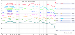

2) This small THD rise is More audible than the doubling of decay time above 2k, (B80 and 10F, in comparison to PS95), which is doubled or more? And which decays to a similar level?
My own listening experience (like Bob Richards referencing Guitar reverb) says this:
If my brain can hear the changes in reverb tone from repeat periods 0-10ms (phasing/flanging/chorusing side effects) and ALSO a change it envelope decay (number of repeats) from 1-2, up to 30 or more.
If my brain can do this, AND ignore the +/- 20 dB swings in and above the presence region, and severe driver borne THD on top of all that....
Doesn't that say that the decay envelope ( especially in the spectral distribution of decay) is actually far more pivotal in assigning "driver character" than driver THD which is all at -40dB or greater?

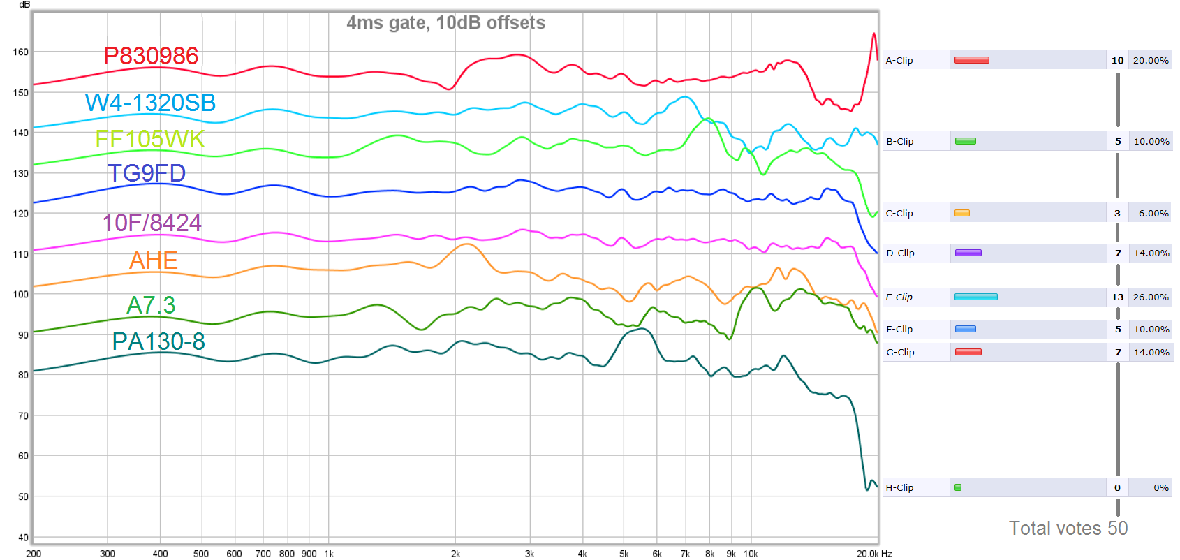

That's cool.
The biggest peak between 1 and 2 KHz sounds more distorted, so more in line with the reference? That's A, on the graph. But the B80 is the lowest
That's not what I said...
I said F and [then] A is the closest to reference in tonality [most of the time]. But of course not in all segment. In drum and cymbals of clip 2 at 0:25 if I'm not mistaken, 10F is simply the best and the closest to reference. Clip 2 [jazz] belongs to 10F. But clip 3? I don't think so. Even TG9 can be better than 10F, depends on preference or taste [which also depends on the audio system used].
The peak between 1k and 2k can be perceived as distortion. That's what happen with A [Dayton] and B [TG9] and even the reference.
TC9 had the lowest peak in total bandwidth. The attenuated peaks, especially in the critical band, has made this driver to be perceived as having low distortion by some listeners [including Jeshi who thought it was 10F and one of the best]. The side effect is that the music sounded closed in, miniature, compressed, less dynamic, unmusical. These negative traits have big effect if you listen casually [as in enjoying the music] without trying to zoom into detail.
Later may be I will show you something regarding this "peak" issue.

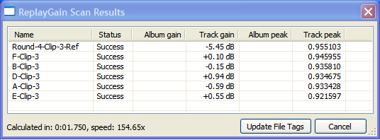

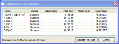

I'm not going to discuss this in detail... I'm just trying to give some hints...
Look at the attached picture regarding "track gain" and "track peak"...
Foobar has a feature to adjust gain such that the available peak doesn't clip the music. From the picture, what can you say about the files in clip 3? I'm not going to discuss it 🙂
The maximum peak for each file doesn't have to be on the same frequency. You can surely track them if you want. F has highest extreme peak but I believe it is in low frequency [surprised?]. B on the other hand, my ears say it is in the sensitive-to-ear band.

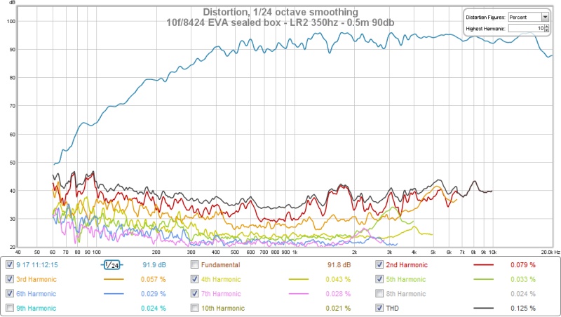

jay, my 10f/8424 is running fullrange without a woofer/FAST. So it is very different from X's test.
Here is my 10f/8424 (in my sealed box) with an LR2 350hz crossover (to simulate what X's system might look like if he recorded without the RS225 woofer). I just ran this one at -6db input / 90db output at 0.5m

If you look at my previous Foobar attachment and understand driver difference in "gain" and "peak", you will see that you don't need to hear the sound in order to know what people preference will be. And yes, macroscopically all of these can be seen from FR flatness [But frequency response is not the only thing, so there can be trade off]

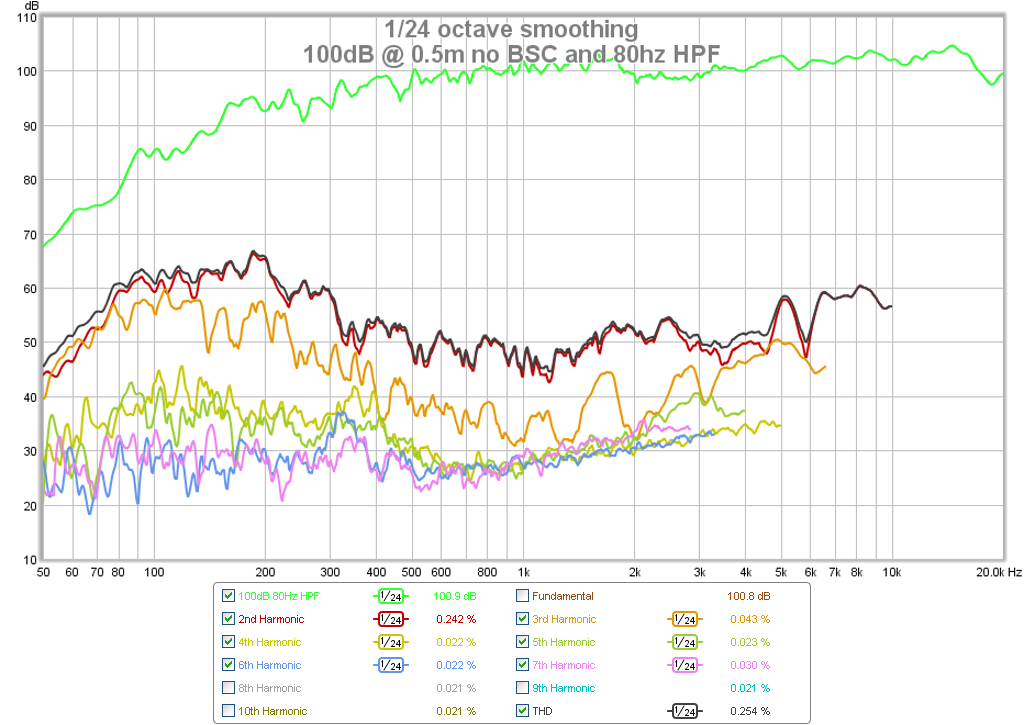

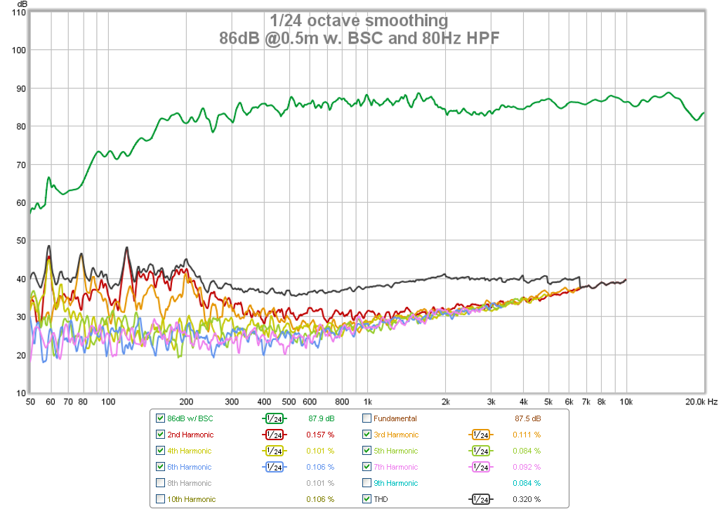

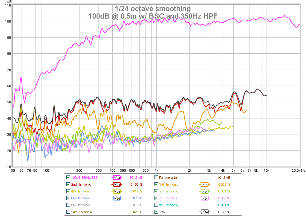

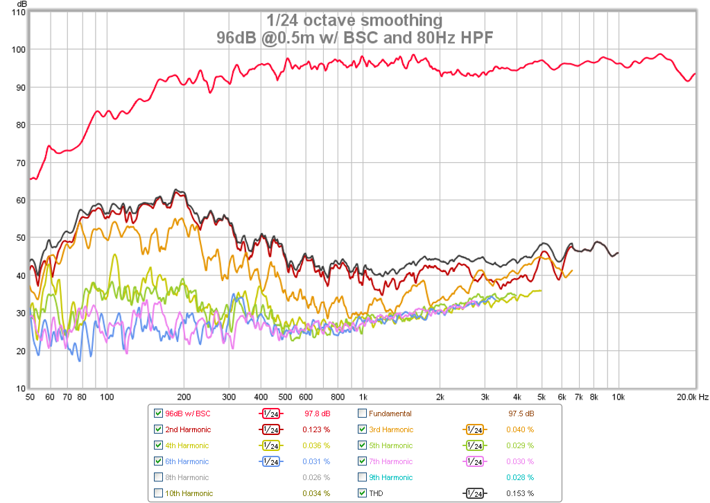

10F/8424 harmonic distortion meas in Dagger

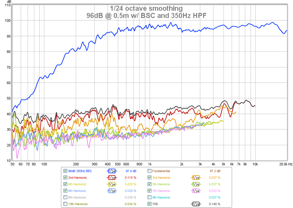

To give a comparison with Jeshi's measurements of the 10F in her EVA foam enclosures, I made similar measurements in the Dagger used for this Round 4.
I did it "full range" with just an 80Hz Bessel (2nd order) in miniDSP. I set the gain to 0dB inside miniDSP and adjusted the drive voltage from REW to get the various SPL's. I also did a second set with the same XO filter used for the Harsch XO in these measurements: a 350Hz Bessel (2nd order). I also did some measurements without any baffle step compensation and also with a -4dB high shelf at 900Hz and Q=0.5.
The values for the HD in the legend is for the cursor set at 1kHz.
Low SPL 86dB at 0.5m, with BSC, and full range 80Hz HPF (ignore 3 peaks below 150Hz - those are HVAC noise peaks):
Moderate SPL 96dB at 0.5m, with BSC and 80Hz HPF:
Moderate SPL 96dB at 0.5m, with BSC and 350Hz HPF:
High SPL 100dB at 0.5m, with BSC and 350Hz HPF:
For comparison, here is what 100dB and 80Hz HPF without BSC looks like:
I think these measurements resemble Jeashi's although I think the 1.13 liter volume Dagger stuffed with fiberglass may be exhibiting lower HD. It may also be a combination of lower noise mic with built in pre-amp at the mic.
I am getting 0.177% THD at 100dB and 1000 Hz, this is the same as SPL of 94dB at 1m.
The main point is that HD is not an issue near or below the 350Hz XO point with the Bessel HPF in place.

Drivers recorded at 0,5 meter on axis except PS95-8 which was at 30º off axis.
Drivers measured at 0,5 meter on axis, does that also include PS95-8 or is it measured 30º off axis i asked in post 519.
Would be nice to have answered because it will mean if we can correlate PS95-8 sound from clips to the traces in the plots and also if PS95-8 actual measured 30º off axis think will give a different CSD coused by microphone relative softer angle to baffle reflection and diffraction.
I'm thinking that the 10F and the TG9 were the best drivers from the last round, since they had the least abrupt FR changes anywhere in frequency. All other drivers had a significant abrupt FR change in one place and/or another.
I think I preferred that setup for the full range drivers (round 2) to the one in round 4. I believe the Dagger enclosure didn't bring out the best in all the drivers while the Nautaloss acted more like the driver would do if mounted on a baffle.
Both measurement and and sound recorded at 30deg off axis.
Thanks and great then frq response traces correlate to sound clip and guess PS95-8 real on axis response will be close to plots showed at round 1 with precaution round 1 verse round 4 had not same baffle/woofer setup.
What do you think about CSD then can we question if decay and counted slices would be different and better if 10F or the other drivers was measured at 30º off axis because of softer angle to baffle reflection and diffraction, or PS95-8 be worse if CSD taken on axis 0,5 meter. The mic angle to baffle/drivers is a variable those CSD plots between.

Could you provide SPL at .5m with speaker terminal voltage as a reference for 10f. This will allow me to reference my drivers to yours.
