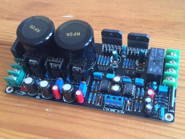

My new LM3886 chip amp with BB OPA2604 op amp front ends came today. I will try this out to see if it sounds better than class D I have been using all along.

Hmm... It Certainly Ain't a Modulus 86 😉
LM3886 Amp requires genuine skills to design /build a stellar example.
None of which come from Ebay.
As a guess your results could/should be Decent .
But up to the potential of the chip? Seriously unlikely imo
Good luck though.

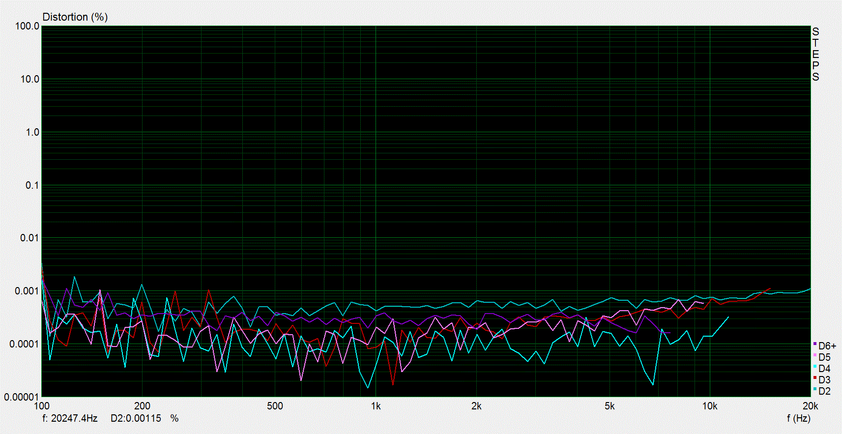

The trouble with class A amplifiers, or any amplifiers for that matter, is that the implementation is absolutely critical if you're going to reap all the benefits of what it can provide. Class A, in absolute terms, is the lowest distortion class of amplifier that is actually possible, but to realise everything that it can provide requires that the rest of the amplifier design is top notch.
Of course the biggest reason that people like going to class A, even if those other issues are not ironed out, is because it completely eliminates crossover distortion. This is one of the most horrible sounding of all the distortion increasing mechanisms in push-pull solid state amplifiers as it throws out lots of high order harmonics. For a given design, the degree to which crossover distortion mucks up the performance gets worse at low output power levels and statistically it at its best when the amplifier is putting out full power. Therefore the more sensitive your loudspeakers the less power you need and the more susceptible you will be to hearing crossover distortion.
Class A is simply a method of biasing the output stage and some amplifier topologies are far more tolerant of an improperly biased output stage than others, so crossover distortion audibility is also very dependent on the amplifier design too. Underbias an output stage and crossover distortion becomes worse, in some cases significantly worse, but find the sweet spot and it reduces down to a very low level, such as in the Modulus.
Of an amplifier that I built, it follows a current feedback architecture and is very low distortion indeed and is also very low noise.
Here is the 1 watt into my 9.4 ohm dummy load real world measurement.
This is with the amplifier optimally biased, such as in the Modulus. The distortion here is already ridiculously low and to get performance like this requires excellent circuit design (many thanks to those in the slewmaster thread) and excellent circuit layout. Without the excellent layout all the good of what the circuit can provide goes to pot.
Bias it into class A however this happens.
What was once ridiculously low is now even a little lower. Certainly many would argue that no one is going to hear this, but from an objective point of view the engineer in me says class A = better measured performance therefore, if possible (if the loudspeakers are high enough sensitivity) I want it!

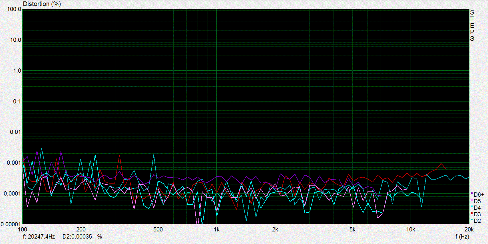

Technically speaking you are not measuring the HD of the 9 ohm resistor, you are measuring the HD of the amplifier driving the 9 ohm resistor. Much the same you could measure the HD of the amplifier driving a loudspeaker and it would still be very low, but the distortion that the loudspeaker produces would be much higher.
I am using the analogue inputs of the ASUS Xonar Essence STX. Measurements of which can be found here. It uses the CS5381 flagship A/D converter from cirrus logic.
