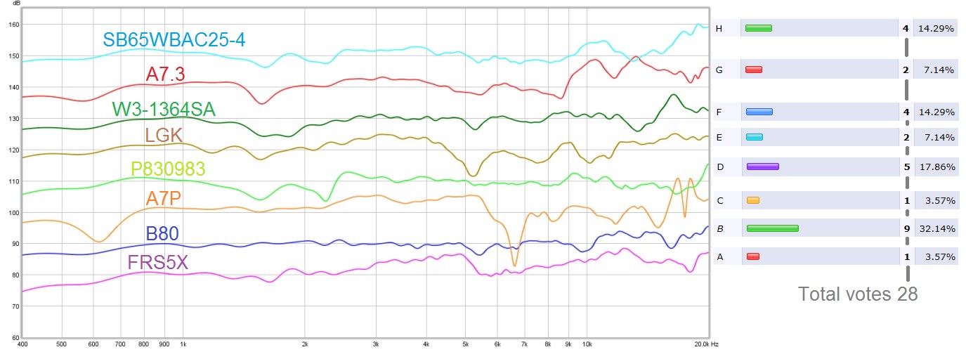

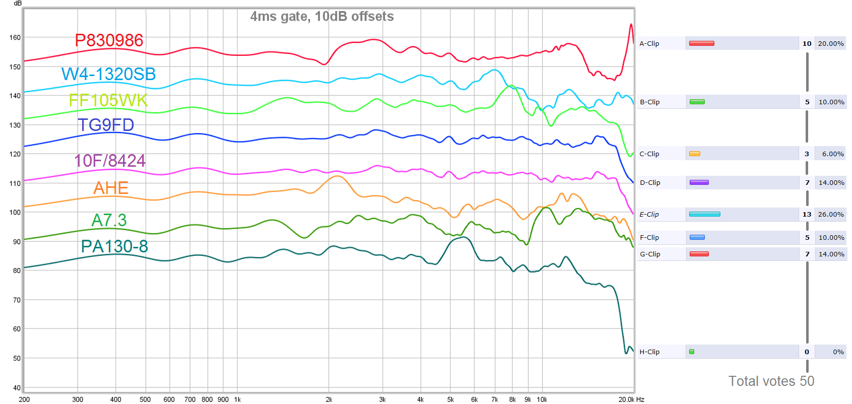

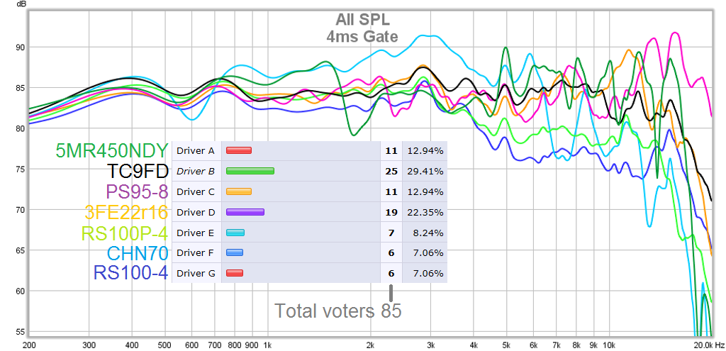

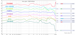

Great thanks xrk971 and contributors round three, look forward if we get a finale with top two drivers from each round as you had talked about.
Thinking loud:
Okay winner B was the B80 a relative high cost driver as it was for winner in round 2, before revealed had hoped it was one of the cheaper ones as in round 1.
Nothing wrong with wriggled response if one prefer that or repair with electric/acoustic EQ somewhere in chain, but some of the worst wriggled ones below seems three MA drivers, interesting they at same is some of the best on paper to extended low end frq response as was it a bigger diameter 8" FR, seems to cost a prize this low end extension in that MF/HF area then looks like it was a 8" FR plot.
Round 1:
attachment.php
Round 2:
attachment.php
Round 3:
attachment.php

Odd that measured responses are so removed from datasheet graphs. In A the response is largely similar to published, except the weird dip.
Not criticising the measurements, but what would cause this?
Interestingly I think all the drivers show a discontinuity at one frq, albeit some peak, others dip.
Could some of this be artifact of the nautiloss baffle? Room refection? Diffraction?
Which ones are you saying are different from their published specs (besides the MA drivers which are known not to resemble factory measurements)? The Nautaloss was shown to have same response as an open baffle as described in round 1 so it is not the enclosure that is causing the differences. Nautaloss is a very transparent open enclosure that doesn't add anything or take anything away which is why it was chosen as the test enclosure. Furthermore, the mic is now calibrated by a third party lab so should be good.
Id say 4 maybe 5 at most.

Curious, the A7.3 appears to have measured the flattest yet it was at the bottom. Why? Alpair can never catch a break during listening tests.
Jay, I listened using cheap Sony earbuds. I think Sony makes among the best sounding earbuds from the cheapies I've owned. As with drivers, oftentimes there's great sound to be had for less money 🙂
Of course these listening tests are fraught with variables but they are excellent and fun, IMHO. Regardless, they are useful in determining the 'flavor' of each driver (too bright, too dull, etc.) and for that the tests are extremely useful.
I think you are mistaken, the B80 measured the flattest. Look here:
