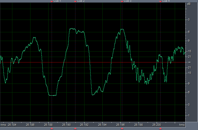

Now I'm doing some more listening, in part trying to figure out what all the click and pop chat is about, and doing comparison current clip-2 recordings with left channel of B80 and 10f from previous round thrown in. The difference between the current leading two drivers is dramatic. One I understand, the other incomprehensible. I guess that participants aren't digging up reference clips for comparison.
Looking at clip-3 reference from round 4, it is full of flat topped transients that are below 0dBFS, and vary in duration with many about 2ms long. In round 4 I briefly auditioned clip-3, and politely speaking is not my cup of tea, and also dismissed it as being highly synthetic over processed sound far removed from reality. After this closer examination, I humbly rank this track as provided to be garbage. Perhaps X will look at a fresh rip from the CD.
Clip-2 tracks have been my standard. In round 4, one transient stood out as not quite right, and reviewing here, it shows clipping artifacts in the reference track:
The glitching happens over about 15ms interval, and is easy to get past.

That's strange but the reference tracks should never be clipped as they were processed by me by applying gain such that they were -0.5dB below 0dB FS on tracks 1 and 3 (by default they were at 0dB FS from the source). Track 2 I applied gain such that peak is -1dB below 0dB FS.
Clip 1 was from high res wav file. Clip 2 from wav file from CD. Clip 3 from online purchase as 256k MP3. Clip 3 was 5th elements' suggestion. Clip 1 I got because so many wanted over driven guitar like AC DC from first 3 rounds. Clip 2 is what I like to listen to.
