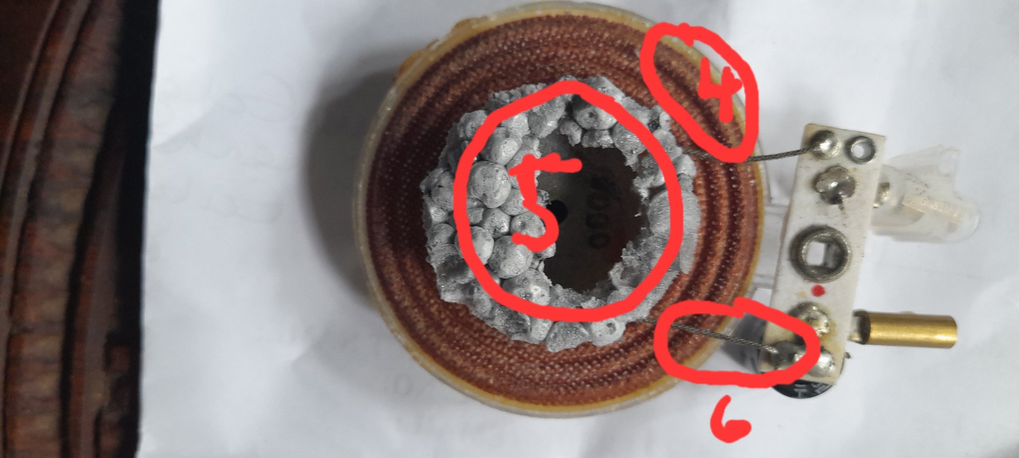

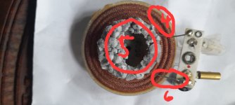

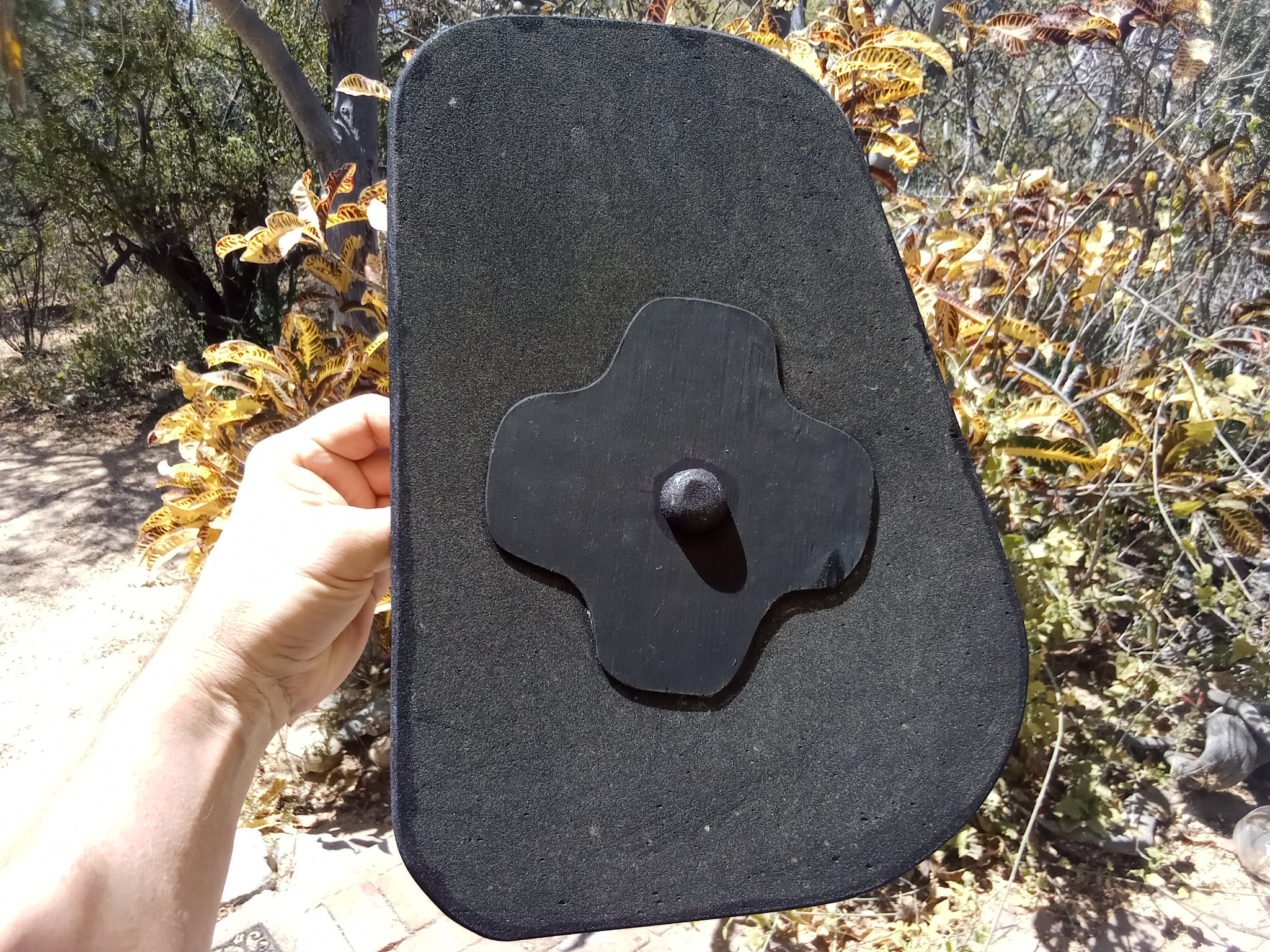

This was a picture I posted of an exciter that was accidentally ripped off of one of your identical types of panels.
The beads are like a jigsaw puzzle.
So you do not have to remove the eps from the exciter and throw away your panel, you can just glue the beads back together
I coated the exciter beads and the exposed beads on the panel with 50x50 mix of pva.
This panel has been working perfectly ever since.
It is a perfect fit and no joins can be seen.
A hair dryer can be used to speed up the drying process of evaporating the water.
Once the water has evaporated there is very little weight as the very thin coat of pva left , is miniscule, but is stronger than the EPS.
If this is not quick enough, I am sure there must be other types of glue that could do the same job , but quicker 🤔
I have done this repair quite a few times over the years as it is easy to accidentally rip off an exciter or drop a panel on its side accidentally shearing off the exciter.
Steve.

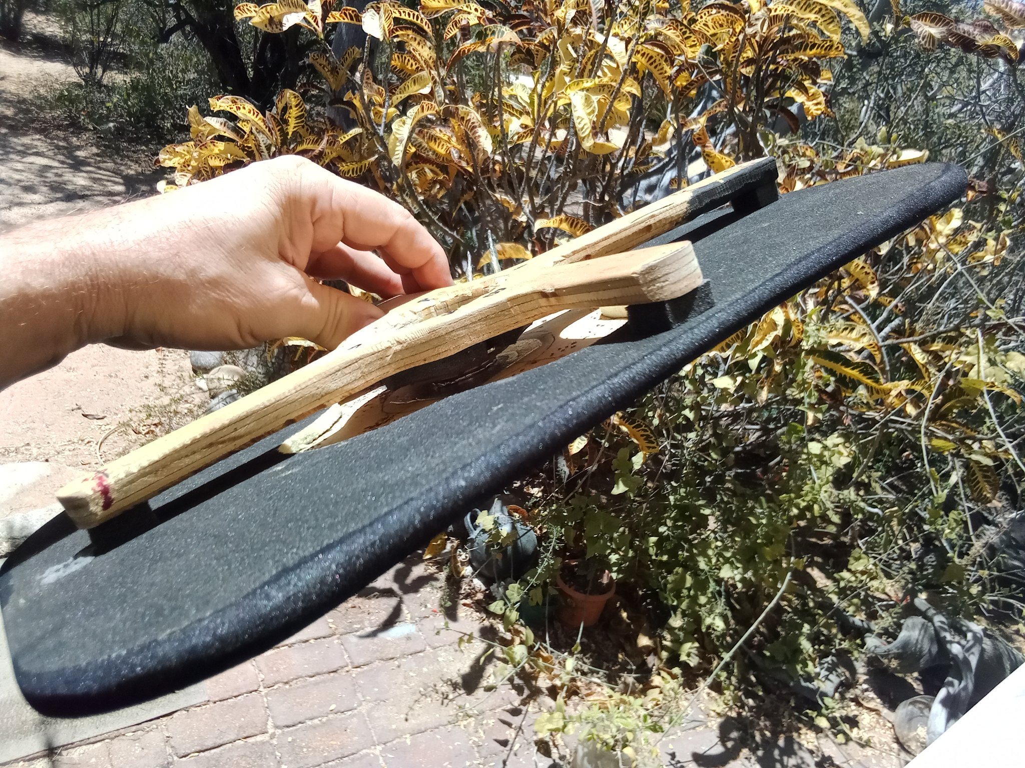

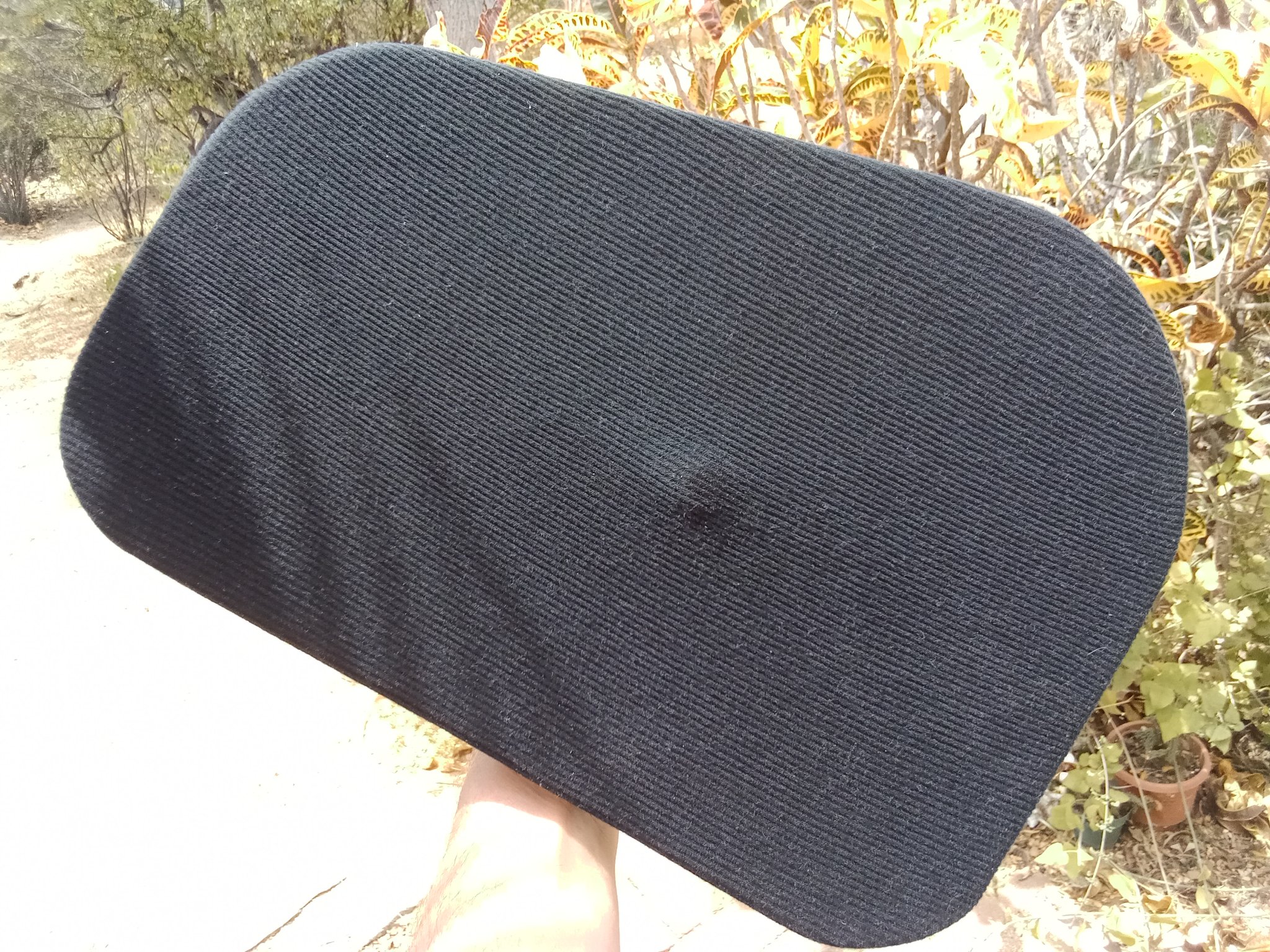

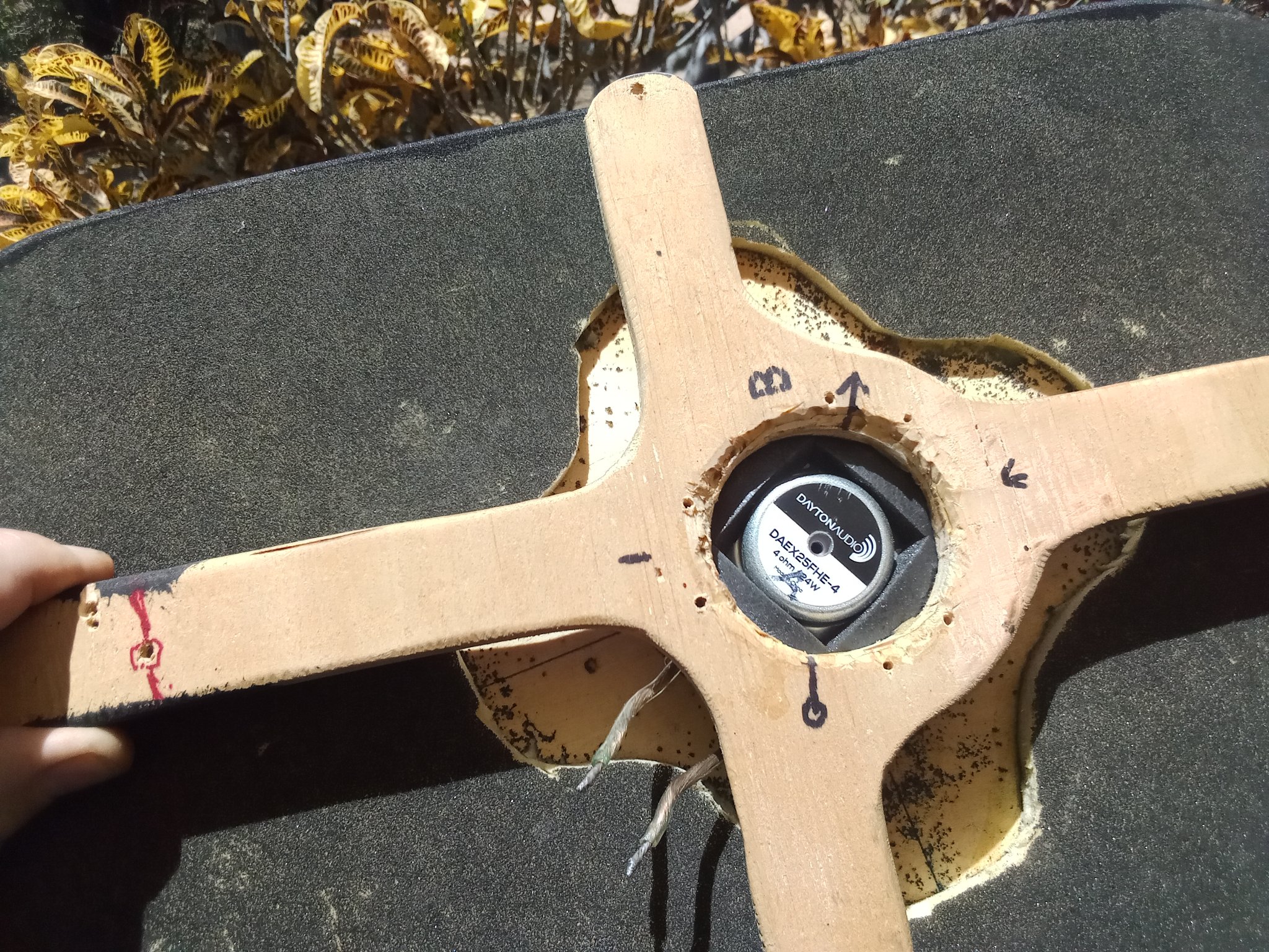

Here are some photos from an earlier post of the hybrid panels I'm satisfied with, they started out with a 3" circular piece of the 1/8" ply glued to the rear with accompanying hole cut through the Poly and ended up with the larger flower shaped wood and larger hole. The highs come through while staying warm enough for my liking, especially after stretching some thin black material over the face and perimeter attached with super glue on the rear. The poly "cone" (from your posts) that is placed in the middle of the wood turned out to act as a "tent pole", if you will, holding the material away from the panel, have no idea if that matters. Subwoofer a must.
Reactions: decramer
Are these the high density polyurethane from the cooler? Tapered to 1/2" thick at the edges? Poly spacers between the wood brace and panel?
Is the exciter screwed to the wood brace? Thanks, Bruce.
These are the high density polyurethane closed cell from the large fish cooler a buddy gave me. Yes they are sanded down to 1/2" completely with more of a slight concave going on toward the middle until reaching the wood. The wood is super glued directly to the poly all around. The exciters were attached to the wooden spines with Frost King door/window foam strip. The foam was attached to the exciter with epoxy which in turn was epoxied to the spine/brace. It was the first time trying this as you can see all the mounting holes in that wood where I had rigidly attached the exciter before with bolts pulling the exciter tight to the wood. The entire thing is "foam floating" as the only other attachment points are the 4 arms with the same foam attached to the panel. So far so good.

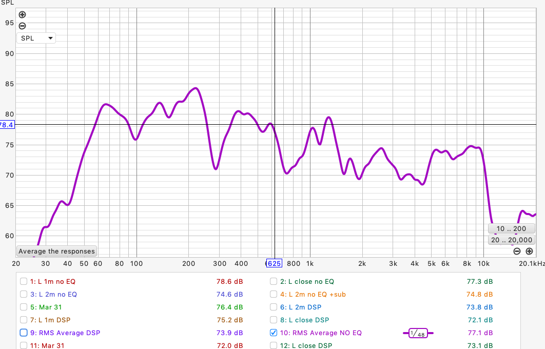

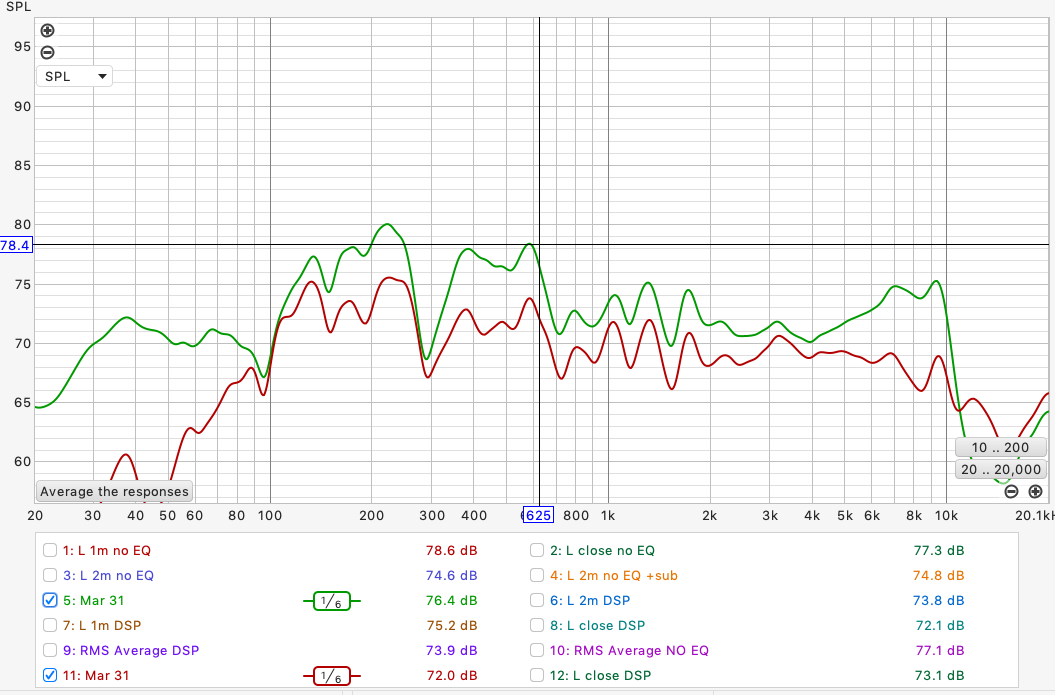

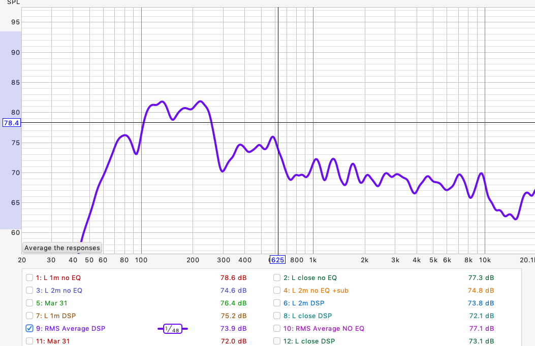

I've posted this on the DML PA thread but thought there may be interest here too.
If anyone is interested in the new Xcite XTB40 exciters I've made a couple of panels now with the XTB40 and XT25 combo, high pass 1st order capacitor around 4khz. They are 600/400mm 20mm thick HD EPS with dilute hide glue and shellac coating. Suspension surrounds are 40/3mm adhesive foam tape all around, will see how the adhesive stands up to use but it is an easy suspension with damping and allows piston motion for the bass to some extent. I'm not sure if it is as good as the clamping in places with EPDM foam I was using for other panels but a lot simpler.
Un Eq'd they sound pretty good and definitely listenable, much stronger in the below 300Hz than others I have made, they fall off pretty steep at 10khz so I need to tweak the XT25, maybe different coating or thin the mounting area more as I have had better HF results on the EPS before with other exciters so know it is possible. I haven't tried to physically Eq these with weights or changing the damping yet.
With DSP I smoothed and boosted the highs plus put a high pass at 80Hz to save the panel as I thought the XTB40 may rip out the poly beads as it has quite a bit more force and weight than other exciters.
Did some quick tests, first is no EQ, second DSP. Both are an average of close, 1m and 2m measurements in room.
3rd image is comparison moving mic 1m no eq vs DSP.
They have a lot more punch than other panels I've made and solid output to 60Hz they play loud too but haven't pushed them too much without a high pass. Moderate high volume they sound good even without a sub.
These will be my party panels probably, with a sub. I have a little BRU5 amp that has inbuilt DSP so makes it fairly portable.
