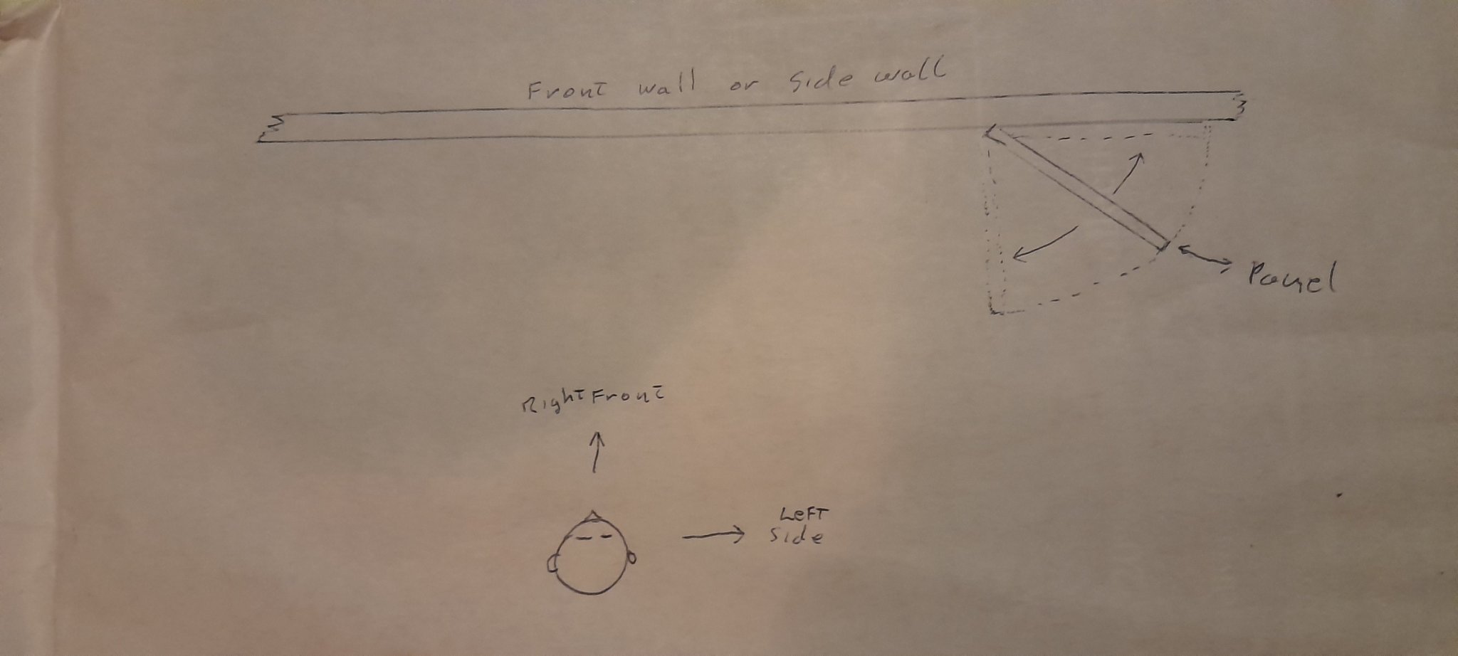

If mounting near to a wall I would recommend the mounting in the rather rushed drawing.
As long as you do not go too close with the wall and panel in parallel.
Steve.
