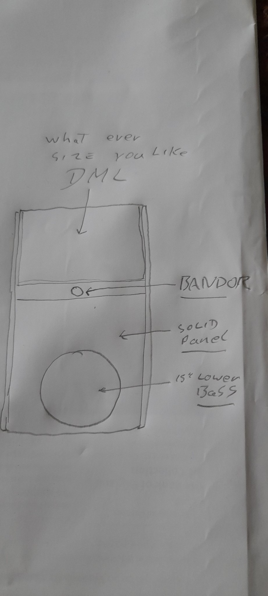

My original plan about 15 years ago, was to mount my 2inch bandor full range drivers in an open baffle with the DML panel on the top.
This was so I could switch between the two units or run them together.
Hopefully for the best of both worlds and type of music.
You mentioned having the tweeter, if needed, on the side.
This is a good idea I think as you can time align the tweeter with your panels depending on your seating position and which side you have your tweeter on.
This I did with my rigid ply panels for a while.
As i have said I have been building great sounding DML panels for 15 years , but to some I am still an amateur (you know who I mean) and do not know what I am talking about.
People have always said how good my recordings sound, not one has said they sounded sh#t.
After I sent my youtube site to my neighbour, he now wants to come and listen to them because he thought they sounded very good.
And he owns a very eye watering expensive pair of B and W speakers plus the rest of his kit.
He never mentioned the recording was bad.
Unless everyone who listens to my panels is tone deaf ,I must be doing something right 🙄
Steve.
Sorry for the amateur drawing 😅
