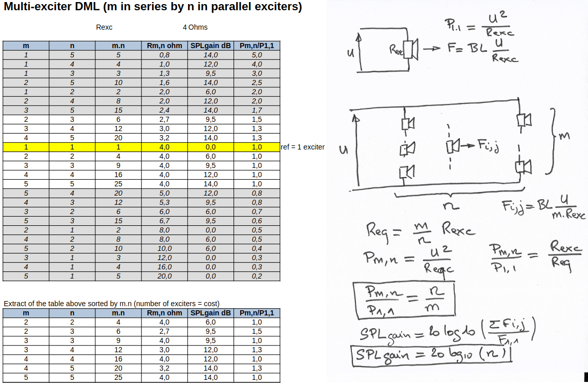

What will happen if they are connected in series + parallel multiple on the panel???
I hope it will answer to your question...
The table below shows different configurations of series/parallel exciters and gives the resulting resistance, the increase in SPL, the increase in power demand.
The cells in grey are possible too low impedance or lower power demand.
Attached is the pdf version.
Christian

These low power exciters have a beautiful bandwidth
But after reading the data, I found that it seems to need to increase a lot to significantly improve efficiency
2*2 only increases 6DB...XD
The question is, can the bandwidth and curves be similar to the original after putting so much on the panel?
Maybe the peaks and troughs will be more prominent after putting more exciters?
It feels like doing it this way leads to more complexity... XD

Thanks Christian, this is good.Hello,
Christian
Is this an Excel spreadsheet by any chance?
Hello André.Thanks Christian, this is good.
For sure there is. Here are the original file (ODS Open Office format) and the XLS export
