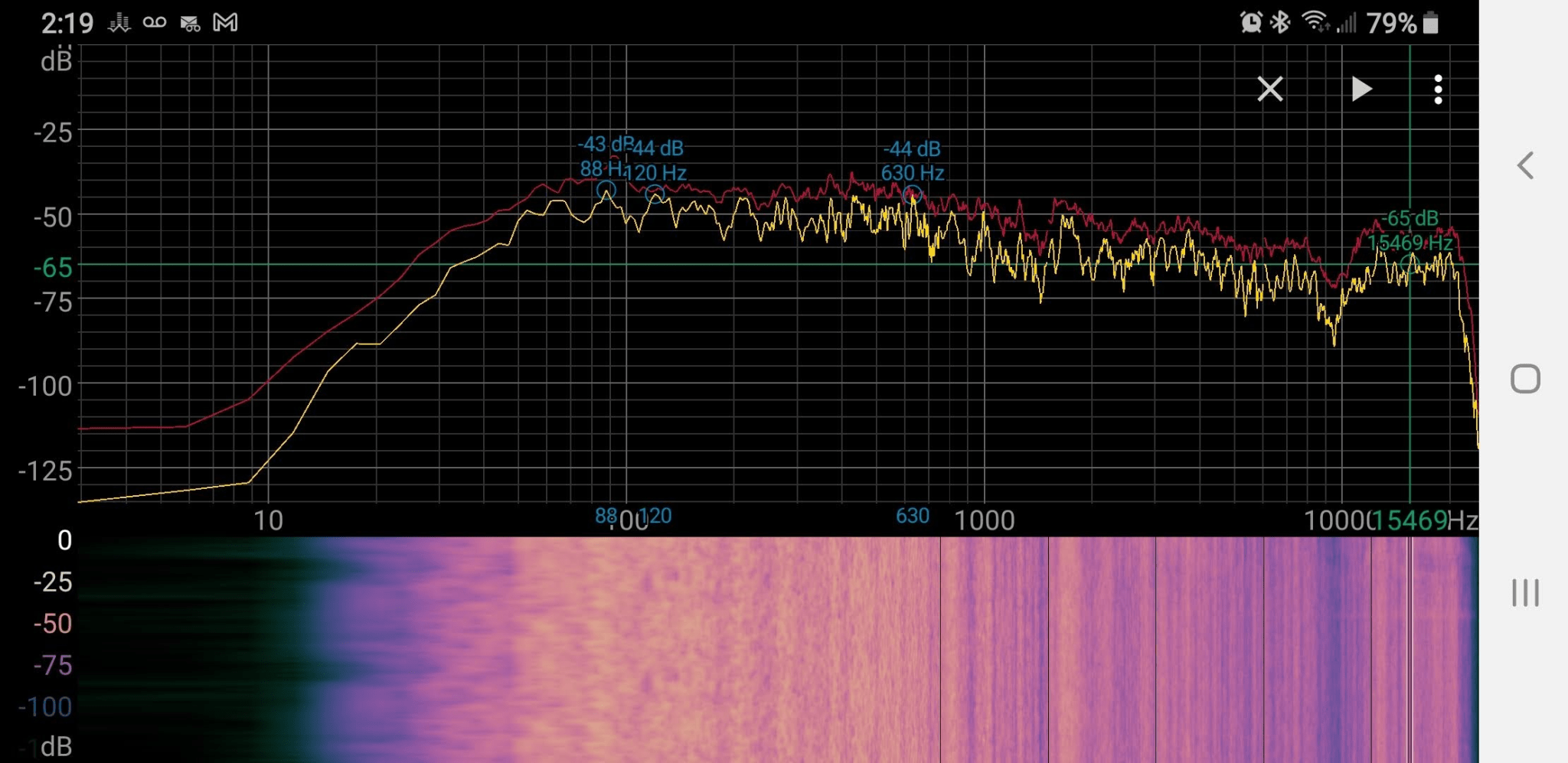

The below is from a cell phone RTA with a waterfall plot underneath. Based on everything I have seen so far this one is decent. Note though that the scale is huge so this is not as flat as it may look.
I meant to mention it sounds like there is some ringing that I did not hear with the plywood. I do not know whether or not to attribute that to unattached foam edging and/or exciter; nothing right now is permanently attached to the foam. It could also be the Foamular itself since it definitely rings more than plywood when tapped. I do have very little foam around the edge, say less than 10% of the overall perimeter, so I could add quite a bit if needed.
I should also say that sound distribution across the panel is perhaps a bit more than with the plywood but nothing drastic.

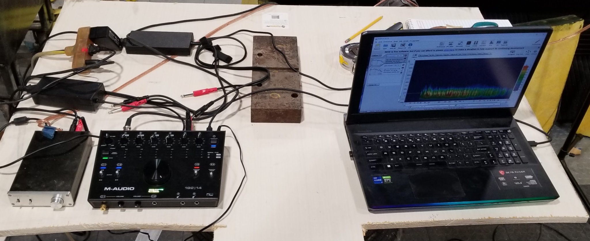

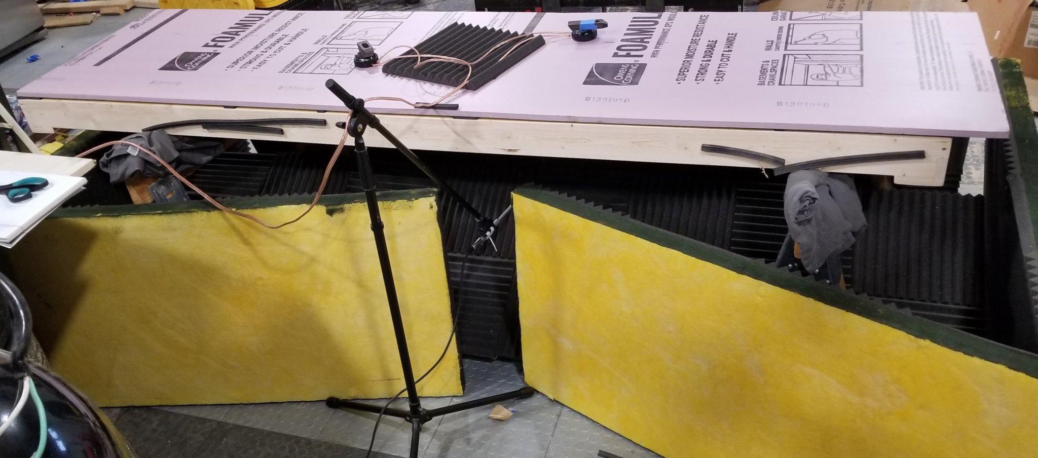

More data... I set up and took some preliminary measurements with the Foamular only. The area under and around the panel was enclosed with Corning 703 2" x 24" x 48" sound panels with foam prisms on the surface. Measurements were taken with an ECM8000 pointed 90 deg to the panel, about 1 ft below the panel, at three positions along the length (1/3, 1/2, and 2/3). Two sweeps per measurement. The results are below and the REW file is attached for those who want to examine it.
This is a preliminary measurement. The actuator position is not optimized (visible in the photo below).
Measurement equipment
Mic shown with acoustic panels (Corning 703 2" thick)

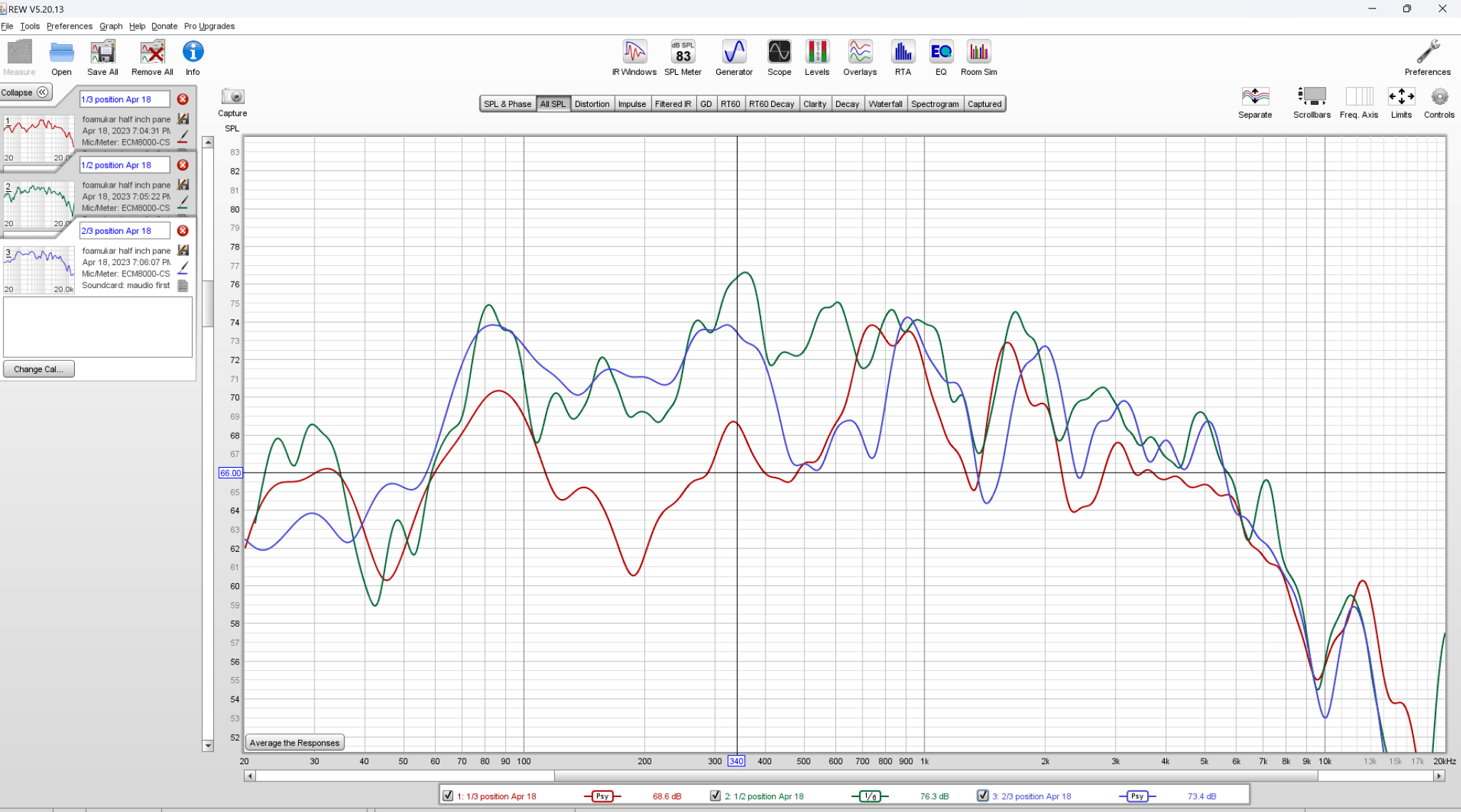

Deude,More data...
Glad to see you got REW running. That's a great start.
I took a look at your measurements (including the data file). My first comment is that taking the measurements at 1 ft away is a little unfamiliar to me. I usually take measurements at 1 meter or father, if I'm looking for the far field response. I also do measurements with the mic very close (say 1-3 mm), but only if I am trying to assess the natural frequencies or mode shapes, for say determining the elastic moduli of the panel or confirming a finite element model. So I don't know how exactly to interpret measurements "in between" distances.
And for a panel as large as your panel is, you probably need to be at 2 meters or more to be approaching "far field" I would think.
The drop off in frequency response above 3k is common in my experience for PS foam.
Looking closely at your data, the distortion looks very high. But that might be from how the exciters are temporarily mounted to the panels. If they are just resting by their own weight, they can bounce around and cause a lot of distortion. Using a "test" exciter and double sided tape for a temporary mount will cure that if that's the real issue.
Looking at the Wavelet spectrogram, there is some ringing at 80 Hz and a lot of ringing below that. Using more foam around the perimeter might help reduce it, though it seems the low frequency resonances are the hardest to damp. It might also just be the nature of a panel that large.
But before doing anything drastic, figure out how to turn the panel on its side securely, so you can get measurements at say 2 meters away.

The REW file is attached to the above post if you want to rescale it. These are the first sine sweeps I have done on the DML panel; the previous test was an RTA from a cell phone.

Deude, I suspect that HF anomaly comes from the cellphone mic itself. I have exactly the same problem when measuring background noise in different locations with several different phones.... a huge dip from 8kHz - 10.5kHz which is odd and could not be eliminated by adjusting exciter position (I was using two).
I'm not sure whether it's a characteristic of the microphone itself or of the physical dimensions of the cellphone casing (kinda inverse baffle diffraction?? )

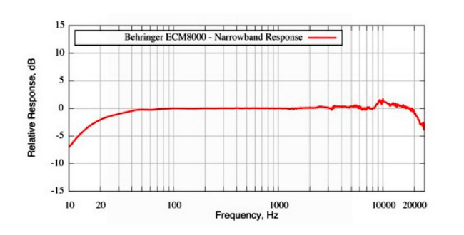

Not sure how low you want to go. The ECM8000 is "ruler-flat" down to 20Hz with the calibration file (can you get individualised calibration files for these mics??) Without the calibration I think you get a 2 or 3db drop in response at 20hz. Do you need a sub to go that low?I have an interest in building a subwoofer and ideally need a mic that will go lower than the ECM8000 anyway.

I had a look too to your measurements. In the same way Eric wrote, even if I have made a lot of measurements with REW, I stays modest in what I can say!
I agree with the previous comments mainly about the distance. We can learn from very short or "long" distance from the panel, seems not from intermediate with in addition a large panel.
I would add I am surprised by the cell phone result or let say the difference between cell phone and REW in the HF. The results from REW are what I have observed too with the HF roll off (material or exciter mounting method?). I won't trust cell phone results without making some additional test like using an external mike (iMM6?) and checking that the electrical and software path is "neutral" by injecting REW pink noise at the external mike input. I think I already posted about a possible method.
When re-scaled the FR are not unusual. The IR seem also not unusual. I mean seems there is no unexpected additional signals (like noise) so the set up seems correct.
I should probably go back to my own measurements but I am surprised by the quite short decay time (opposite of Eric's reaction) with such material without extra damping (PVA coating)... to see.
As Eric mentioned; having a look to the spectrogram in for example 1/6 oct wavelet is informative to see what are room reflections, panel modes.
