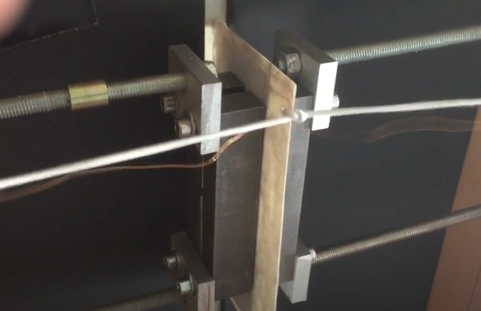

The coil doesn't have to be round, does it? Or, even the magnet?You could try removing the coil and gluing to the panel, but you would have to arrange a mounting that would allow you to line up the magnet gap to the panel.
I have in the past thought of doing this with my exciters to remove the spider.
Like below, for example? Suspension is just an elastic string.

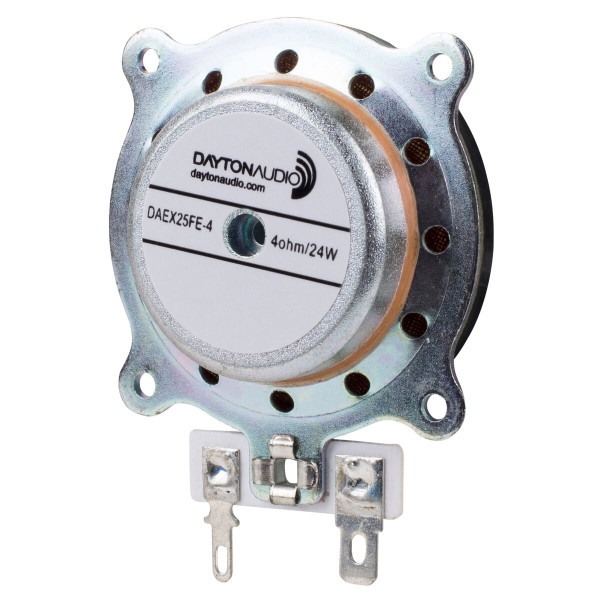

Thanks, yep, removing the plastic parts are a no go as the springs are as you say suspending the coil and keeping it in alignment. "You could try removing the coil and gluing to the panel, but you would have to arrange a mounting that would allow you to line up the magnet gap to the panel." This is what I had to do when I first started and made my DIY exciters out of small speakers, the spider wasn't stiff enough to keep the coil self aligned from the weight of the panel and a spine was a necessity along with a hell of a lot of fiddling with super glue and shims.Toddincabo.
I'm afraid that looks like a very badly designed exciter.

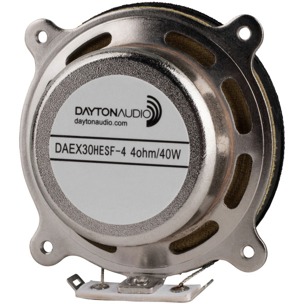

As far as cutting off the rubber boot I was worried about major distortion or whatever from the coil but thinking about the design of the FHE25's pictured below, and others like my next purchase, the 30HESF's, they have purposely incorporated holes in the rear for sound from the coil area. (Dayton Audio have the FHE25's now with their IMS plastic Interchangeable mount. I hope they leave the original as an option.)
The boot can be removed with an exacto knife fairly easily and seems to be a one way ticket, but they are toast to me as is anyway. I'm gonna' do it.

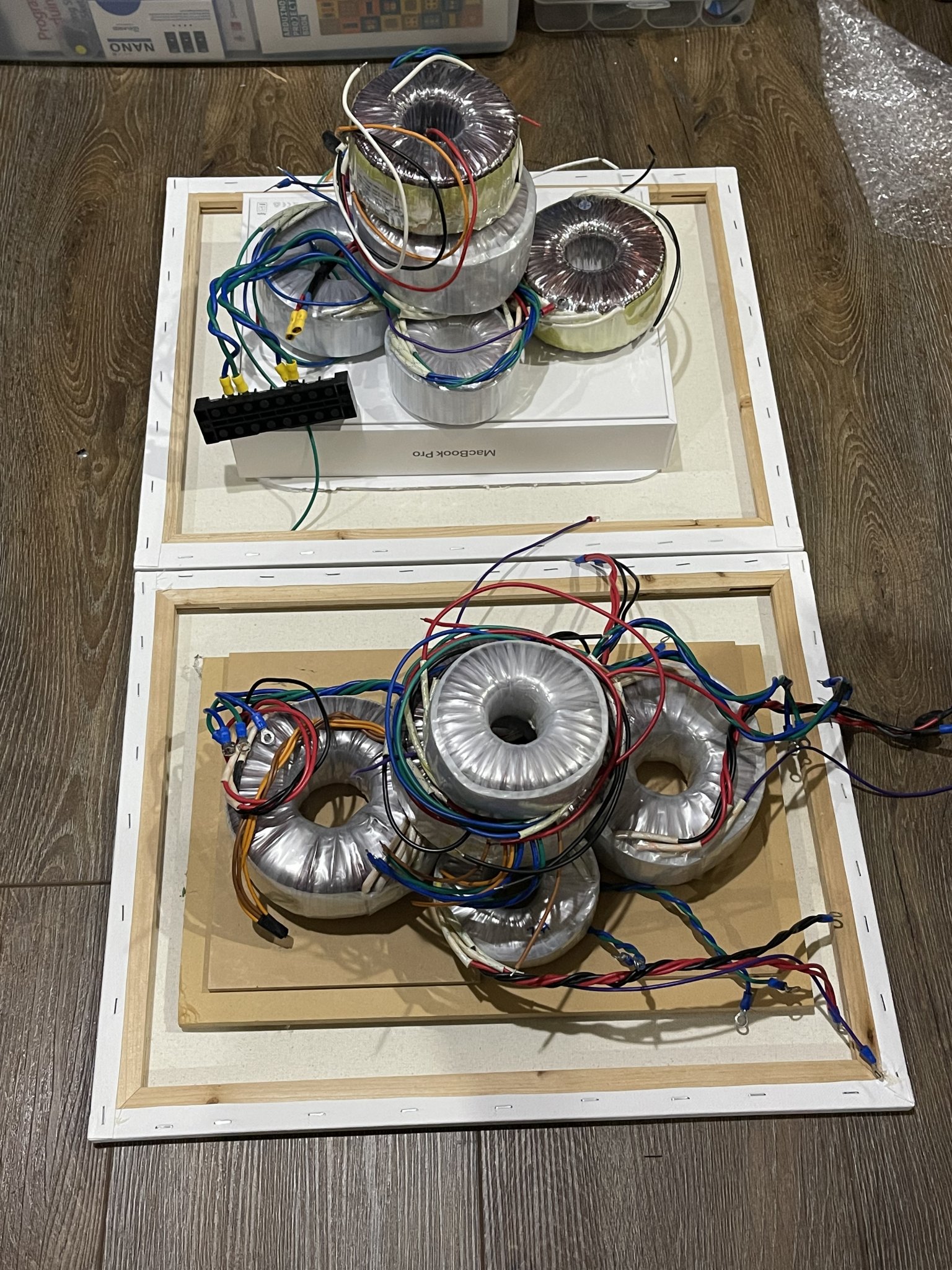

I can’t remember who had the suggestion to mount a driver to a flat board glued to the back of a mounted canvas frame. I bought these frames years ago and finally having some time to make this DML. I applied Titebond glue to an Elmers brand foam board cut about 2in smaller than the frame. I’m using a flat hard object and a bunch of weights (trafos in this case) to clamp the board to the canvas while it dries. I tested a Tectonics TEAX32C30-4/B driver by resting it on the board (no glue) and it sounded promising. So waiting for the glue to dry now before installing the driver. I recall someone used a cross brace on the back of the driver magnet to get more bass. These are 20in x 16in frames.
I think you've gone a little overboard with the panel weights 🤣😂I can’t remember who had the suggestion to mount a driver to a flat board glued to the back of a mounted canvas frame. I bought these frames years ago and finally having some time to make this DML. I applied Titebond glue to an Elmers brand foam board cut about 2in smaller than the frame. I’m using a flat hard object and a bunch of weights (trafos in this case) to clamp the board to the canvas while it dries. I tested a Tectonics TEAX32C30-4/B driver by resting it on the board (no glue) and it sounded promising. So waiting for the glue to dry now before installing the driver. I recall someone used a cross brace on the back of the driver magnet to get more bass. These are 20in x 16in frames.
It was offgrid who first posted the art panel idea ,I believe.
This is probably the one I will build for my friend.
What board material are you using, I will probably use the crate ply for my friends panels.
Crate ply has a more lively sound than the standard ply.
I'm going to have to buy a few more panels first, hopefully I can get them as cheaply as before 😬
