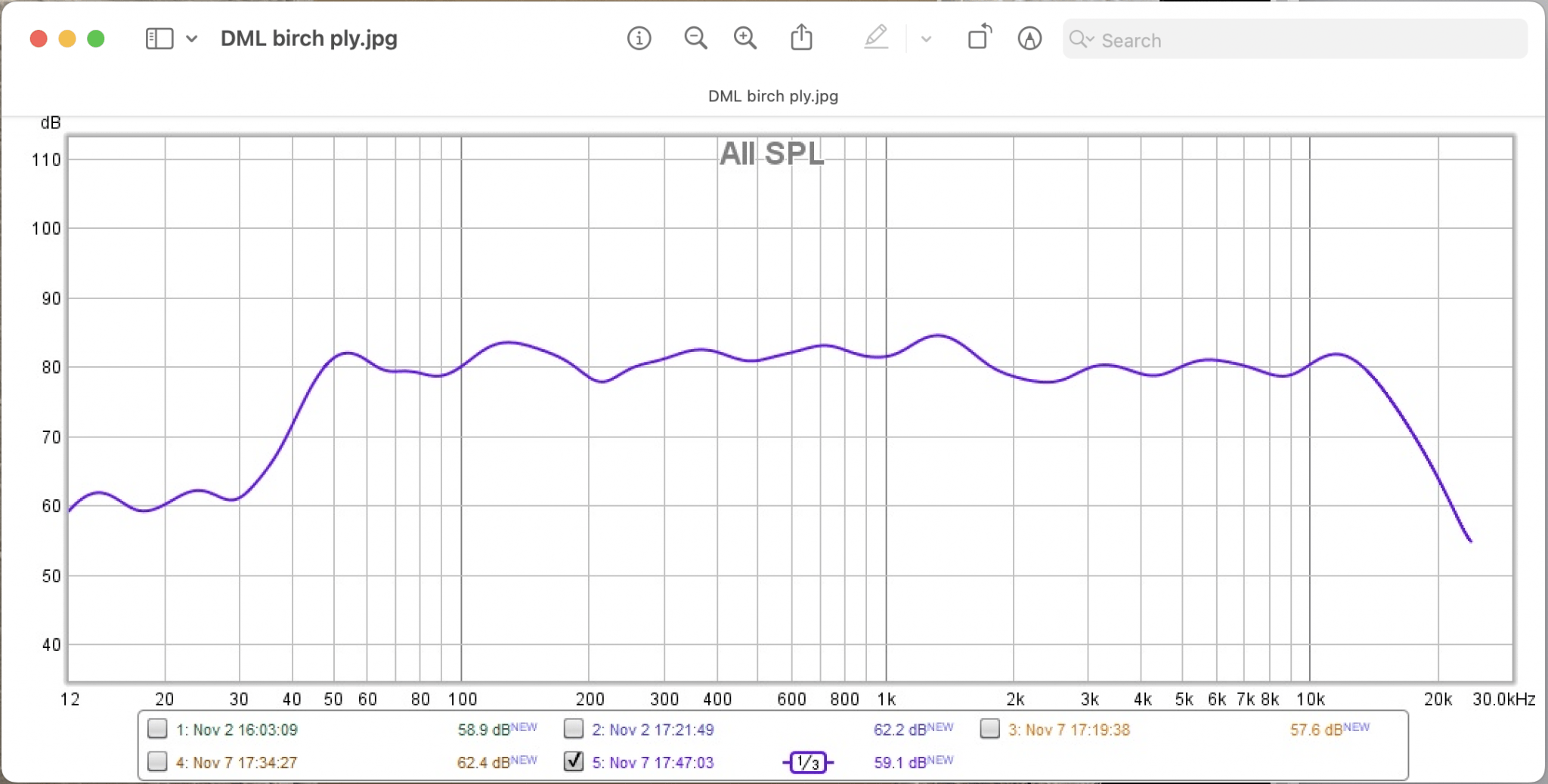

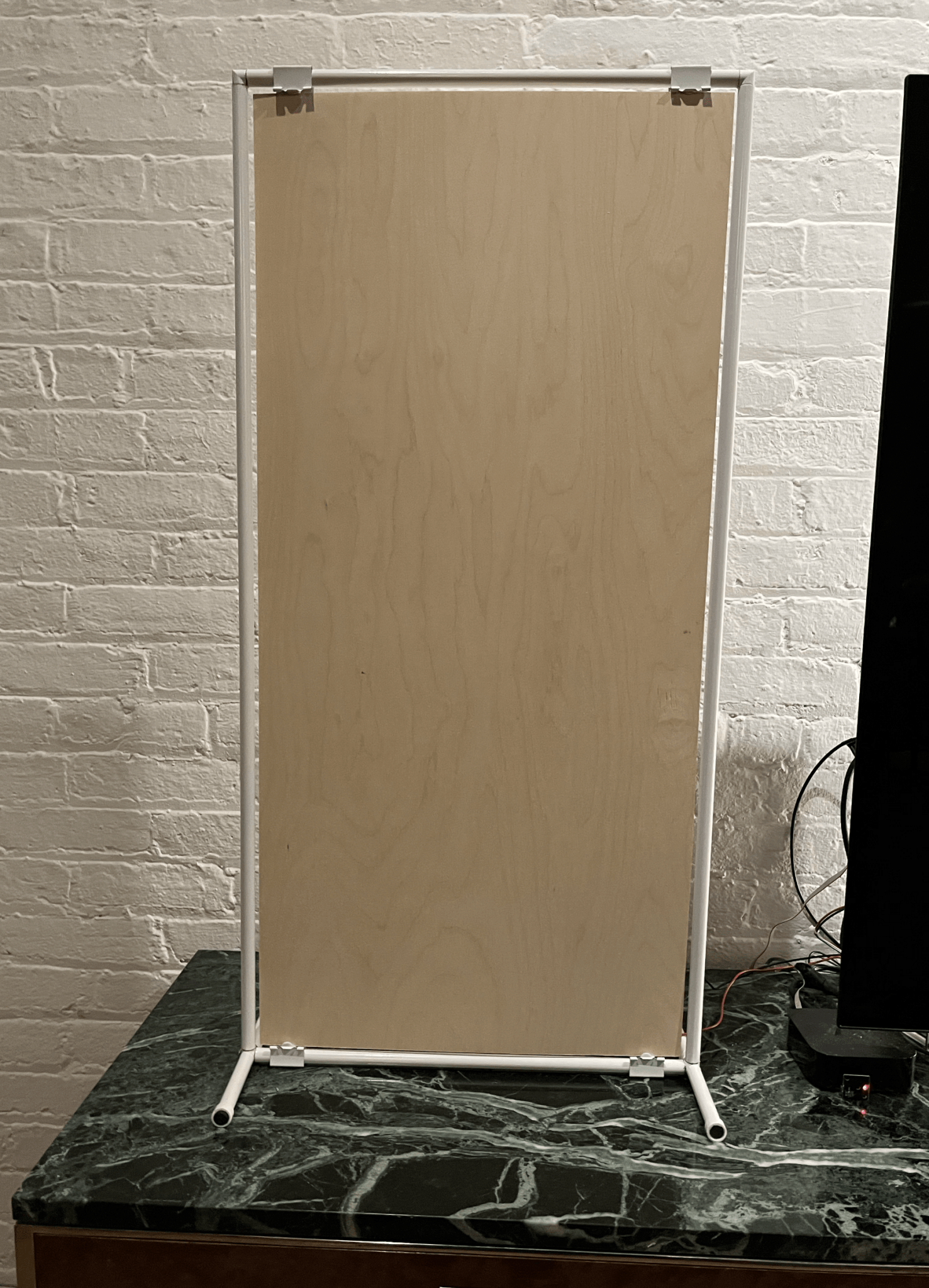

I traded out my gator board panels for 3mm baltic birch.
Still need to work a better attachment to the frame.
Single Thrusters on each panel.
No support of the exciters at this point.

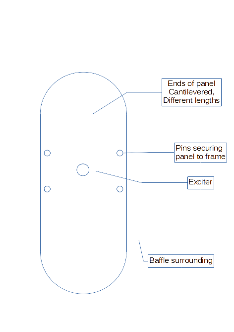

Hi EricThanks Paul now I see. When I hear the word cantilevered, I usually think of clamped at one end and free at the other end. But you mean it only in the sense of free at one end. I do think the idea is kind of cool. in a way you’re making two or more panels from one. And combining the natural frequencies of both. That’s not a route that ever occurred to me. The one thing that I wonder about with this configuration is how well it will work when the exciter is so close to the fixed points. I’m wondering if the area between all those fix points might be a node or near a node for most of the natural frequencies, and hence make it hard to drive them. It’ll be interesting to see how it models.
Eric
No, not clamped, but with 4 pins holding the panel to the frame, it's more or less rigidly supported, hopefully allowing similar dynamics from the free end as fully clamped. This idea of independent movement for low-end support is behind my ellipses panel (four different sized regions), and ideas about various asymmetric blobby shapes.
I doubt the fixed points close to exciter will hurt too much, may even help, because a circular fixed point should act as a dispersive structure, spreading incident rays (billiards again, see Sinai billiard 🙂 ). I would be more worried about the straight edges of the panel close to the exciter causing local resonances. For that reason it may be better to shift one pair of the pins directly across from the exciter rather than on 4 corners, or put a cusp, or waist the panel near the exciter. Position of pins is probably better asymmetric, so no three of them lie in a straight line.
It could also be an issue that the exciter may drive the cantilever(s) too hard, because you have a sort of a double see-saw, with the pins as hinges. But a fixed pin also gives a 'model-able' and easily modified point for adjusting the design, if you know what I mean. Position can be changed, and various elastomeric or viscoelastic support materials (as washers) can be tried without having to start again, as is necessary with soft support all round.
The worry about local reflections has kept me away from the idea of narrow, high aspect ratio panels, even though I can see they should have advantages like less comb filtering, better stereo image. Your success with them, this new idea, and the fact I have a cheap chinese 4030 milling machine that will accept a width of ~35 cm may lead me to towards that. They are certainly more practical and attractive than other shapes.
Any idea how to assess how much noise is generated by the edge of a panel vibrating close (eg 2-3 mm) to a fixed baffle?
The low-end extension of the cantilever came as no surprise to me, but the better modal density did. It's likely that most of those nodes will turn out to be non-productive because a lot of them are from torsion of the panel, leading to opposite pressures on each side of a narrow panel, and zero effect in the far field. The whole idea may turn out to be a flash in the pan, as is usual...

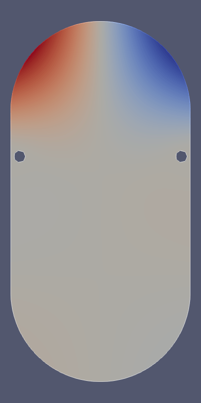

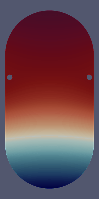

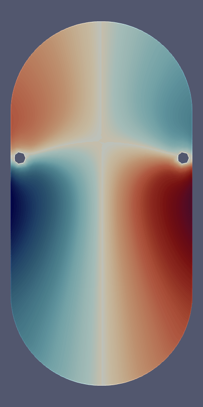

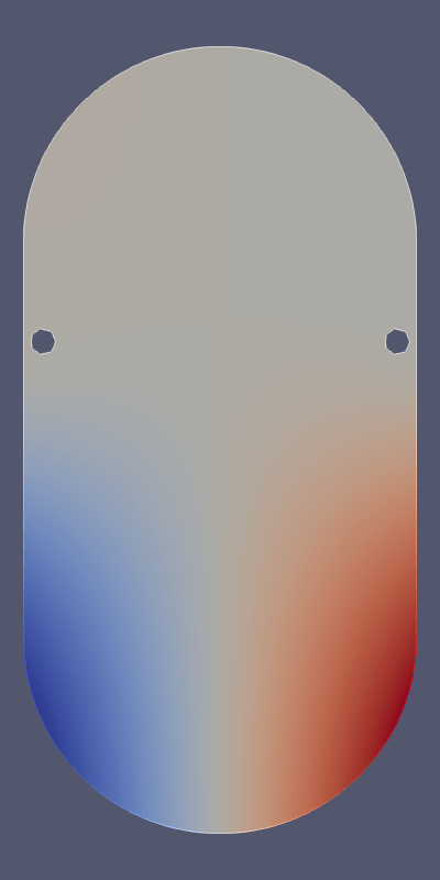

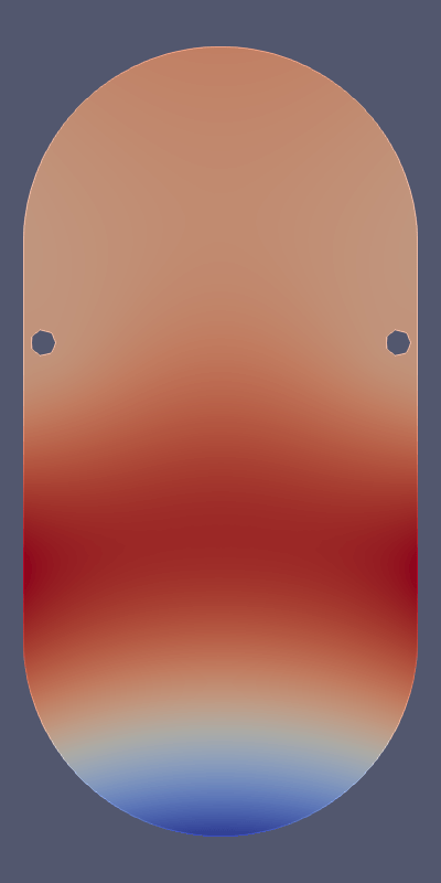

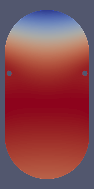

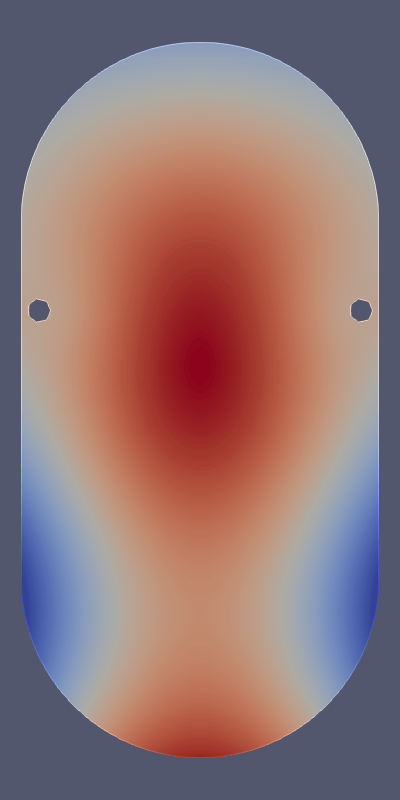

I tried to model it last night with 2 pins to start, but the simple plate solver is giving me mode shapes like a free plate. Either I have not defines the edges of the mesh correctly, or the algorithm cannot deal with internal boundary conditions.
I think I've sorted the issue with boundaries. Looks like Elmer grid renumbers the boundaries. By opening in ElmerGui you can see the new numbers.
Looks like the idea of relatively independence of the two ends is borne out in the data, even with just 2 pins. The modes seem to be nicely interleaved too. But some are pretty clearly unproductive, and I think there may be fewer modes overall that if the ends were completely independent cantilevers).
Mode1 (7 Hz)
Mode 2 (21Hz)
Mode3 (26 Hz)
Mode 4 (45 Hz)
Mode 5( 59 Hz)
Mode 6 (81 Hz)
Here is an image of what I think is the first partial derivative of the displacement in y direction for the first mode, clearly showing the involvement of the pins:
Mode1 (7 Hz)
Mode 2 (21Hz)
Mode3 (26 Hz)
Mode 4 (45 Hz)
Mode 5( 59 Hz)
Mode 6 (81 Hz)

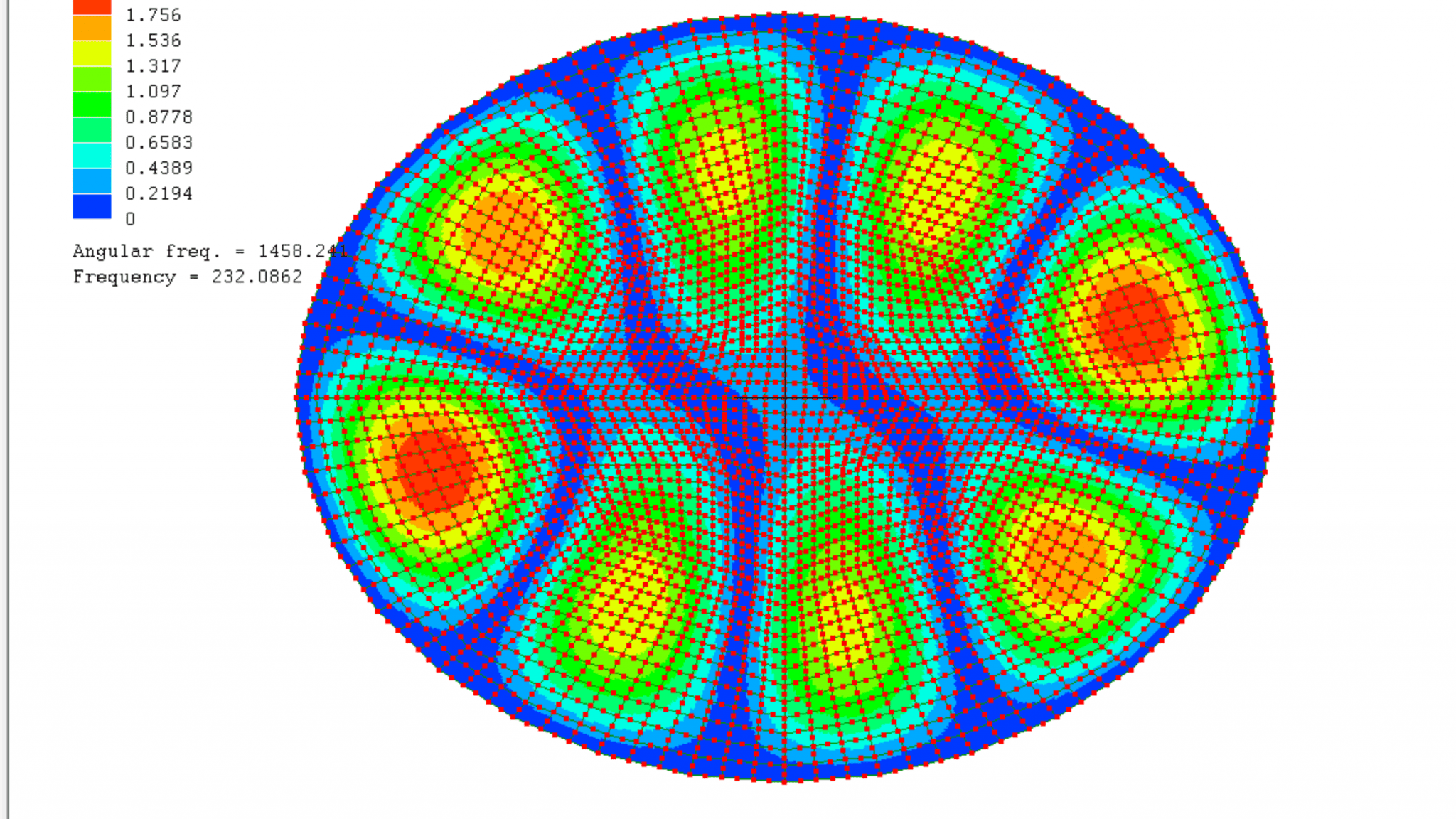

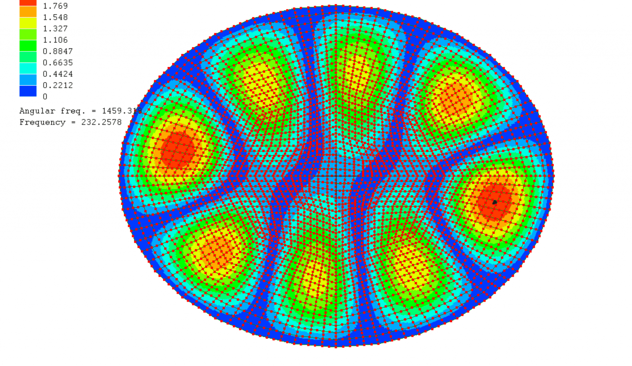

Paul,Note that both have small minimum separation, and there do seem to be a lot of values near zero in each case. This seems to point at the existence of modal degeneracy, which I believe will be improved with asymmetry and/or shapes which are chaotic billiards, and so reduce the standard deviation for each case.
I thought degenerate meant this:
Okay, serious now: I never heard the concept of degenerate modes before but I think I have seen it in modelling, especially, with very symmetric dimensions.
Playing with ellipses the other day I got these two modes, at nearly the same frequency (of course).
I've seen similar things before with square or nearly square plates. I always assumed it was a modelling artifact. Is this what you are referring to?
Eric
