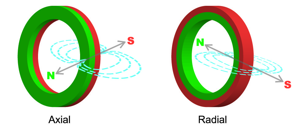

Yes your description is right. This image from a stack exchange page may help.
If you now imagine two radial ring magnets opposing one another the field lines between the magnets will compress increasing the field lines seen by a flat coil placed between them. This is no different to a method used on Magnapans using bar magnets and linear ‘coils’. As radially magnetised ring magnets are rare And expensive intend to use a circular array of bar magnets so in a sense all I am proposing is a ‘rolled up’ Magnapan motor. As Andre’ noted above, the B in BL is constrained by Xmax but if using a DML panel from 200hz up the required Xmax is not large. DML’s are not pistonic devices so displacement is not a design requirement. Because of the possibility for relatively large diameter coils the. L in BL is less restricted than in a conventional voice coil and may compensate for any loss of B. All hand wavey theory at this time.

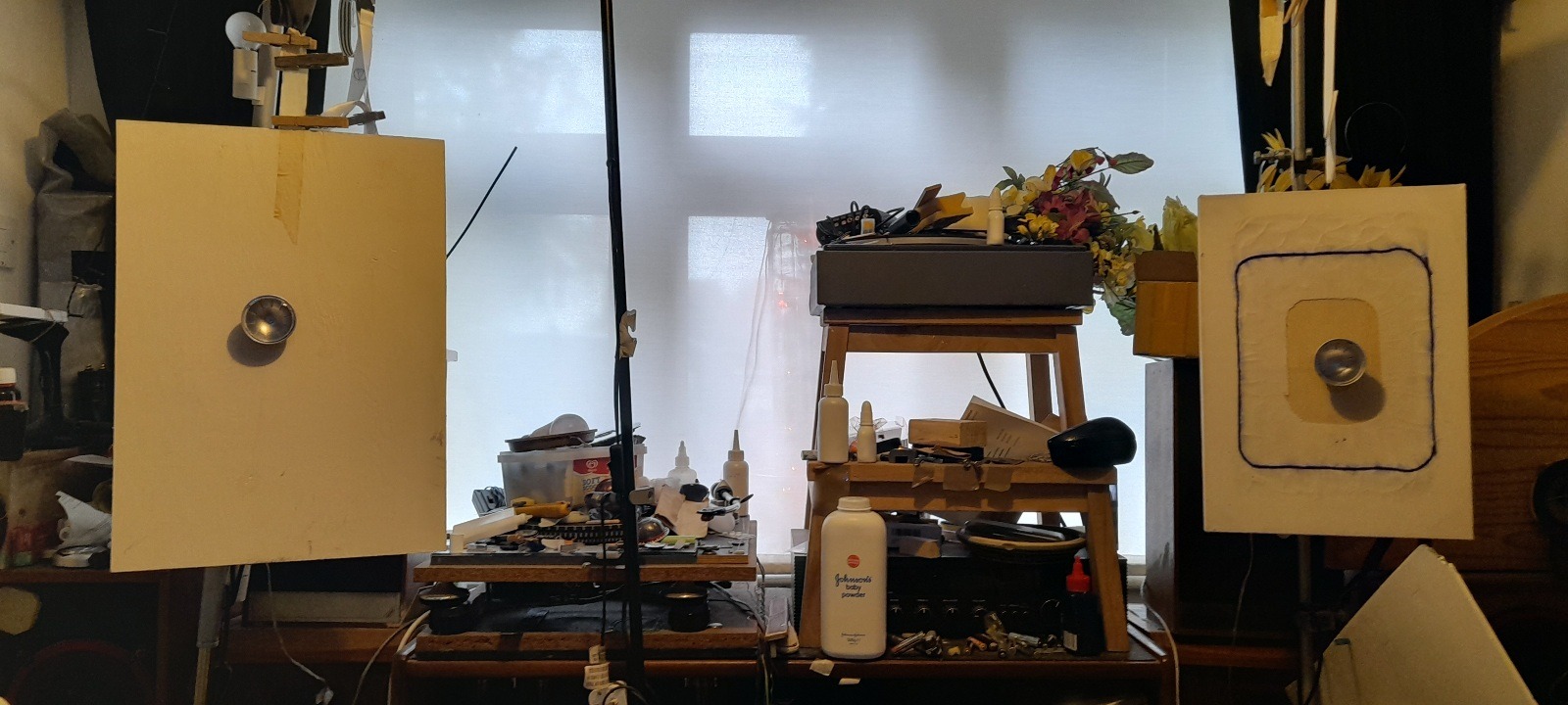

i made a few recordings but i thought this one was better ,mainly because of the microphone roll off below 100hz.
it is just the two panels with the coffee containers in place running full range.
the microphone was in-between the two panels ,the panels are about 40cm from the microphone and about 30cm below the coffee whizzers, (the rug microphone stand was too short)

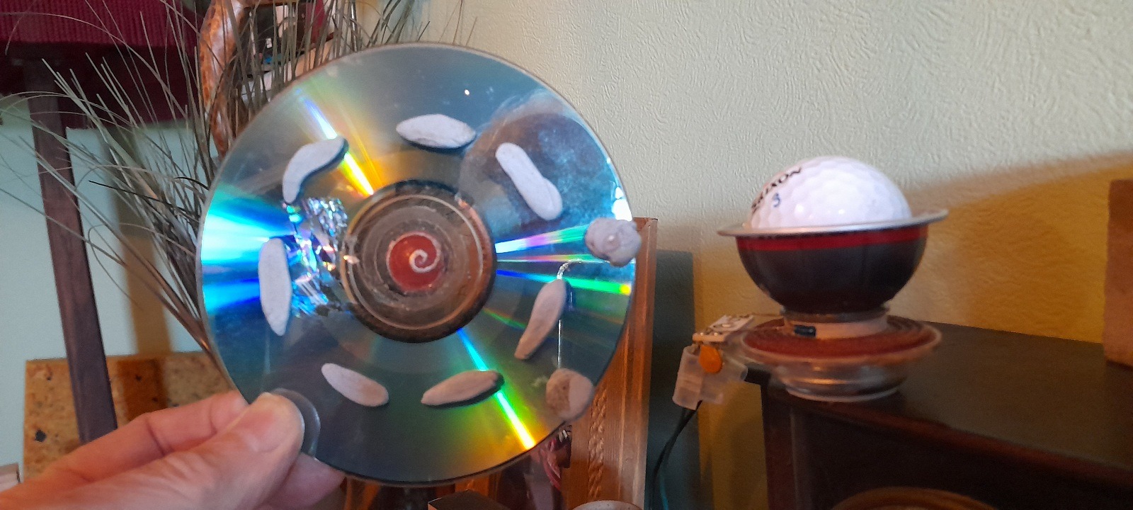

I took the exciter off of the CD.
I thought I'd better show what I had to do to the CD to get a decent sound from it.
Plenty of bluetack similar to the rings tectonic use on their BMRs.
Obviously you'd want these around the back.
Not sure if this glue will stick to the coffee container?
Might have to use some Evo-stik.
Steve.
