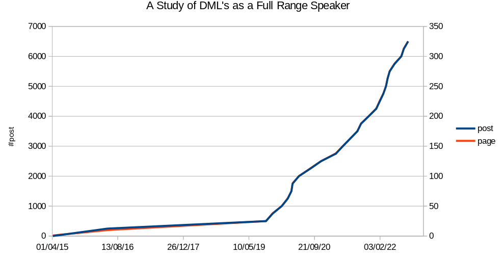

Here is the update of the "history file". Available also under the github link (at least I know where are my files!). 12th revision of the file.
For the fun, the post growth
Christian

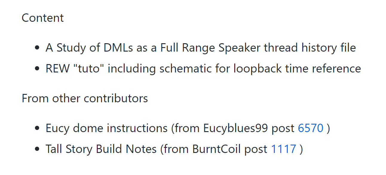

Please find attached the REW "tuto" file already shared. I added some pages to show how I have wired the loopback time reference (see previous post about in panel wave speed)
Christian
PS : please find in my signature in the left panel the link to my page Homeswinghome under github.com where the files I have shared in this thread are going to be stored (history file and REW tuto available). Let me know if it doesn't work... correction of English also welcome.

Thank you for the feedback about the Github link (1st time I use such tool). The link was wrong. It leads to the readme file not the main page. Correction done. You should see above this read me a list of files. You can open them in the Github pdf reader directly in your browser or download then for a better reading.

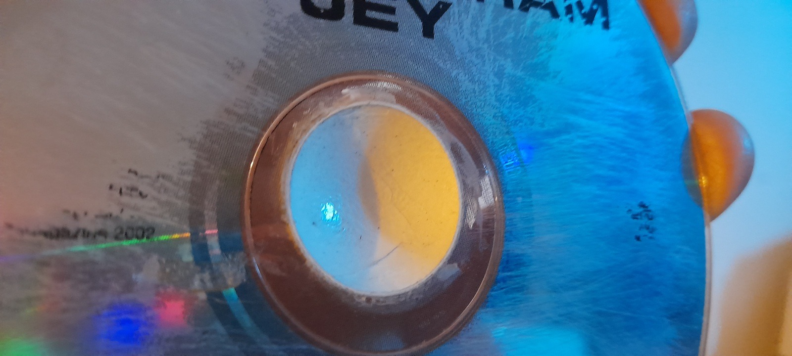

I got an idea to use a CD/DVD disc as a panel. I could find in this thread that this has been tried before. How about a vinyl/LP?
Hello Pelanj,
Have a look to 5118, 5119, 5124, 5127 from last March. I don't remember post with vinyl. One drawback of those materials if they are heavy so a low efficiency (some where you should find the efficiency if related to E/rho³, E Young modulus, rho density). No advantages are for now identified for them... as far as I remember...

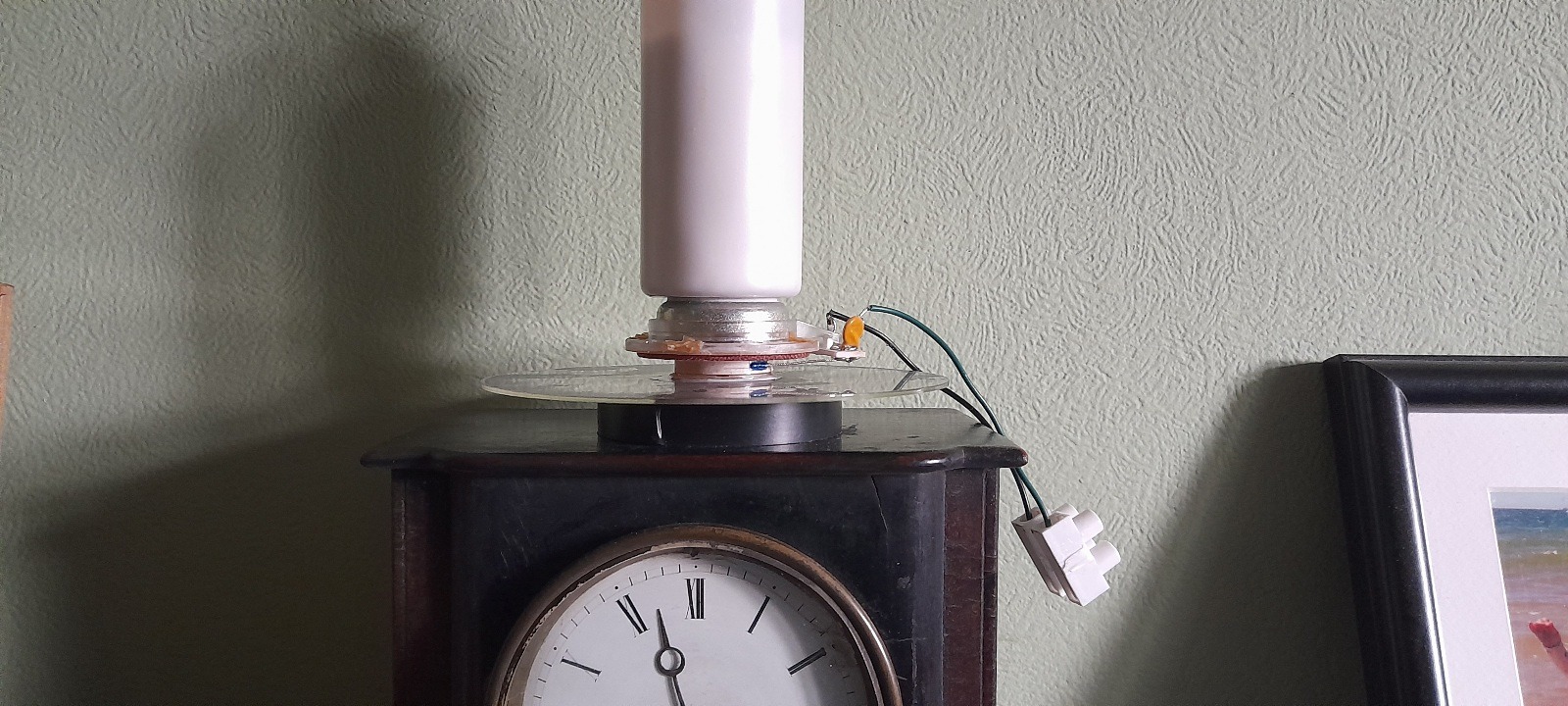

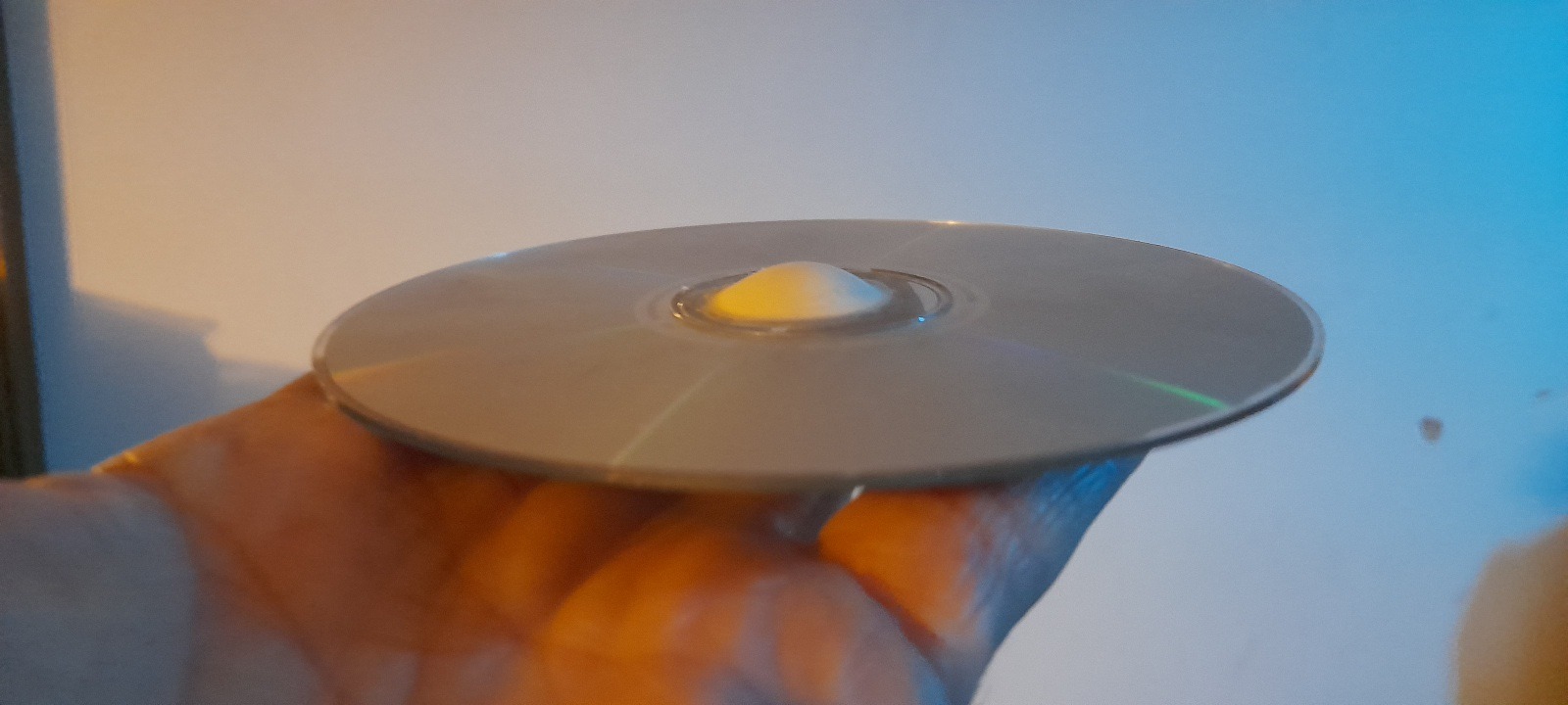

I came across this old CD panel a couple of days ago while looking for some tools.
I never got around to putting the exciter on, this is the eggshell tweeter , slightly offset I noticed.
LPs were very thin in the 70s like poppadoms and sounded very similar, they maybe a better bet for a panel ?
Steve.

Pelanj.
I had a quick listen to the CD panel, it produces quite a lot of exciter noise.
This could be being made worse by the egg dome, so I will remove the dome and see.
The noise is unacceptable and is similar to the crate ply, but is easy to reduce with a couple of blobs of carefully placed bluetack.
I would think a vinyl record may be a better choice of material, though not tested as yet ?
When I get time I will post some pictures and plots, maybe.
Steve.

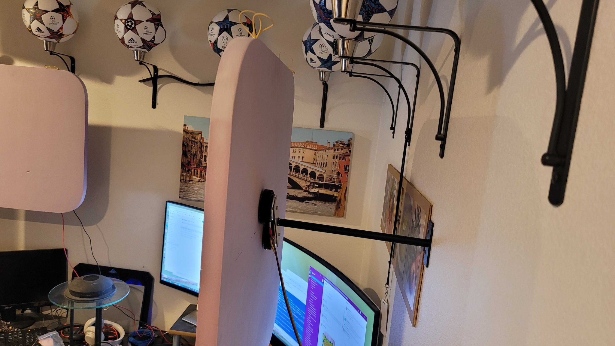

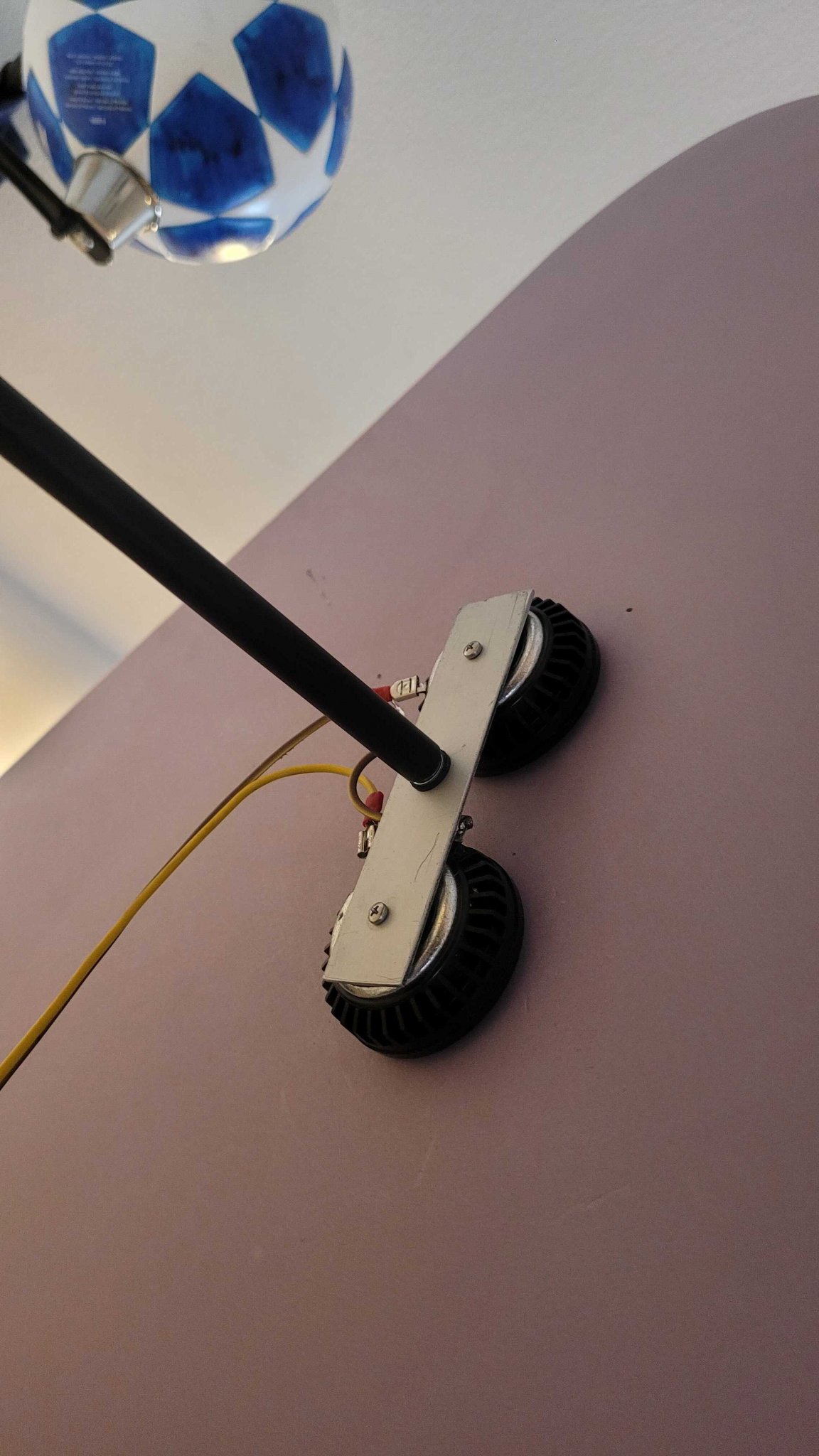

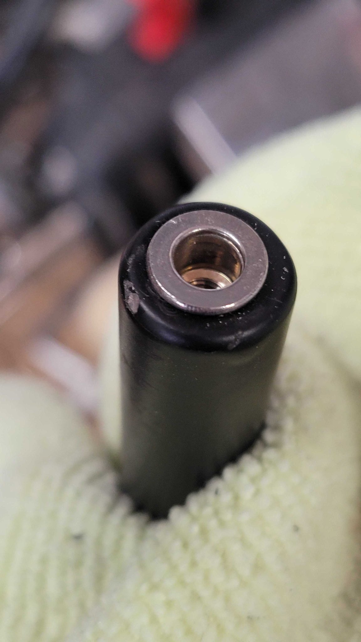

Haven't gone through the 337 pages of awesomeness (yet) -- but just wanted to post how I mounted my basic dual exciter panels. Gonna run cleaner wiring 🙂
They seem to now require more power to get volume, but once up there they may sound better than just suspended (non-scientific observation).
I used 'hidden' mount shelf brackets, drilled a hole through the end, added a nutsert, and then used a small piece of aluminum (old text worn ruler). I also used neoprene washers to deaden the vibration into the bracket/wall.
Have these paired with a Paradigm PS1200 sub (which I just did foam surround repair on).

I like it. You can use liquid leather dye to color those panels. I used black for mine and applied over my PVA/water coating and seemed to work just fine. Two coats crisscrossed. How many watts are those exciters? Two are way overkill for EXP panels that size in my testing (24w), but I see you got your 8ohm by using 2 so never mind.
